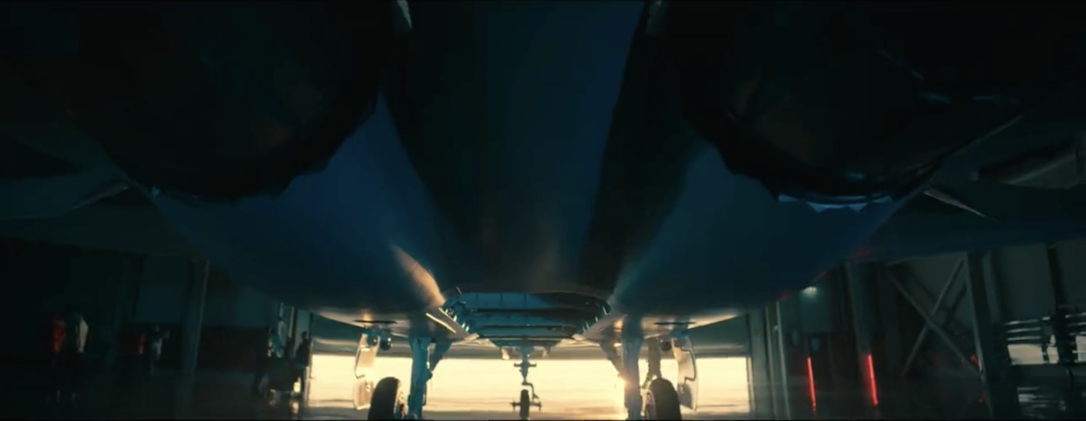

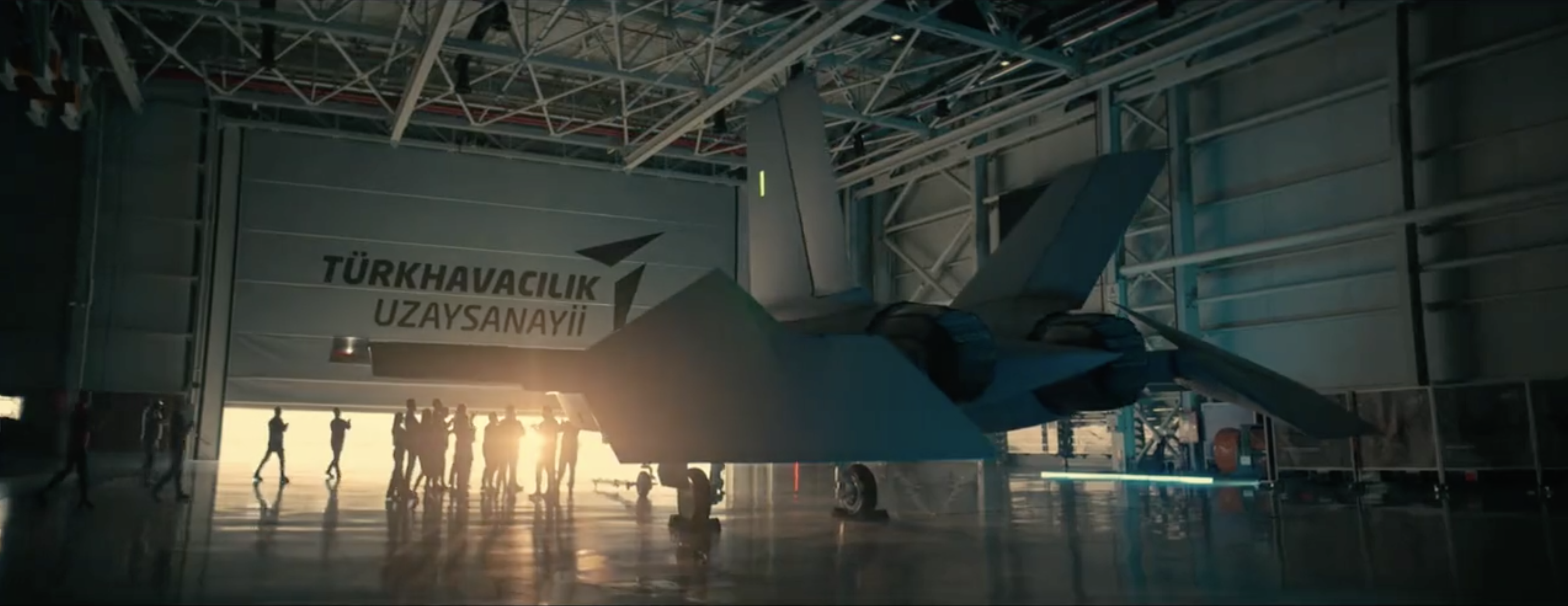

From TAI's 50th anniversary video... (and guess what lol)

I have a question and its purely due to ignorance and not flame baiting or something.
How do you develop a simulator for a plane that hasnt made its maiden flight yet? I mean a simulator is supposed to simulate certain flight characteristics of a specific plane so how did they develop without knowing those variables yet?
You have a digital twin of the plane in CAD, so the geometry and every material is defined and has known properties. From this you have a good idea of the overall properties of the aircraft in a static setting. Incredible software packages like the Ansys suite (which TAI licenses) can simulate practically all engineering domains. For flight characteristics this boils down to running CFD analyses in a range of flight envelopes (altitude, airspeed, AOA). Values for lift, drag, load forces etc. at x thrust, alt, aoa, configuration etc. for select portions of the aircraft's geometry can then be used to build a look up table (LUT) that can be fed to a flight sim. Some flight sims like X-Plane run a simplified CFD model outright.

Can someone help me understand the weapon bay, I see it but I don't quite get the dimensions. It's one large bay but the bulkheads seem to be very big so how is gonna munition fit? Is this just because it's early prototype or am I seeing wrong because of angle
Two tandem bays coupled with two sidebays. The area is vast, but design activities are still ongoing as we speak.
