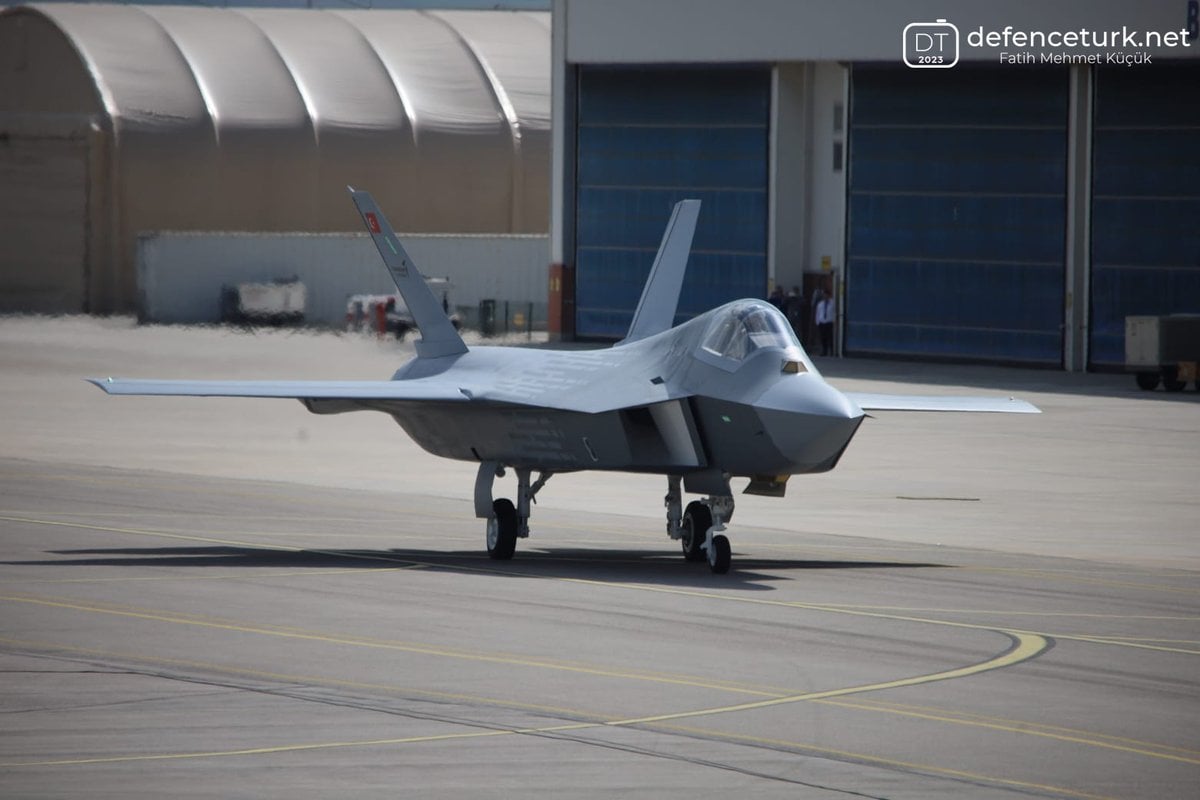

There are reports that the engines needed for Kaan prototypes have arrived. Since a total of six prototypes will be produced, we could have 12 engines in stock. Furthermore, if we use the spare engines we have for the F16s, there's a possibility of adding a squadron of Kaan fighter jets to the inventory while the TF35000 engine is developed. What are your thoughts on this possibility?
4,332
276 22,690
Good news if at least the engines for the prototypes are here.
f16 engines are for f16s. You can’t use them on any other plane.
F16 uses F110GE129B and set up for single engine use.
Kaan uses F110GE129E and set up for twin engine use. It is the same engine used in F15EX.

The F110-GE-129 engine used in the F16 block50s and the engine used in Kaan are the same model, if it is possible to use it in Kaan by changing the FADEC software settings and there is no political obstacle, this path can be followed.
No they are not. The latest f16 engines we have got for our f16s are f110GE129B . It is set up for single engine use.

President of Defense Industries (SSB) Haluk Görgün announced:
All engines required for the KAAN prototype aircraft have been procured and delivered to Turkey. Production of our prototype aircraft continues at full speed.

On a whim, I'm sure with enough time and tinkering 110-129Bs can be used for twin jet configuration.
Two issues with that. 1st, is spitting in the face of US export controls, giving another very nice silver plate to US to use for embargoes; 2nd, literally cannibalizing our already low number of fighter aircraft in a 2 for 1 equation. To make 20 Kaans, we would have to cannibalize 40 F-16s. How is that a good thing by any format? Using the spares, which I believe we have less than 30(?), we would put our F-16 readiness rates to the gutter.

I've heard 10 engines. So that's only good for 4 operational planes and one set of spares if we remove and reuse engine from p0 etc. No engines until caatsa is gone and s400 is gone, which likely isn't happening because Russia doesn't allow us to get rid of it
Turkic
320
5 630
And don't forget the spare engines for those Kaan's. It's a genocide of F-16's!
