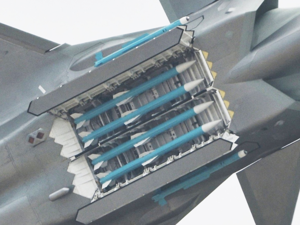

8 internal is pretty big number. Even the J-20 being one of the largest 5th gen fighter can only accommodate 4 AAMs (PL series) in it's internal weapons bay with another 4 external hardpoints
The length and wingspan of J-20 & TFX are identical though TFX is taller while J-20 has more wing area. Do you think TFX will have double racked missiles to fit 8x given it's height? but if that's the case, the bulkier body might possible compromise stealth to some extent

J-20 has 4 (main bay) + another 2 (one on each side in the rotation dolley thing they have there in that side volume) = 6 "internal"
The extra 2 in side are IIRC shorter range AAM.
But there is talk that J-20 can stagger 6 in the main bay if they incorporate another mechanism for it. so 6 + 2, similar to F-22.
TF-X will definitely want to have 8 (similar 6 + 2) at its current volumetric concept.

Has to be double racked but the body doesnt look bulky enough.

6 seems feasible but 8 is hard to fit horizontally next to each other unless vertically stacked which will result in a bulkier undercarriage
