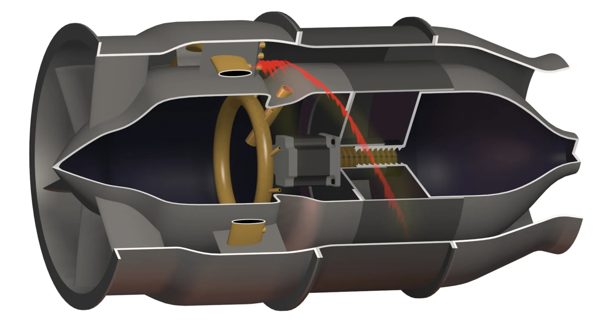

They may become the engine of choice for super expensive fighter jets for a while. But the future of jet propulsion is with CRDE (Continuously Rotating Detonation Engine)
No moving parts. No single crystal blades. No compressors. No rotating parts.
Engines will become lighter, smaller and more efficient. (Even at low pressure levels, CRDE can develop very high thrust)
The whole system is self sustaining once ignited. Plus it doesn’t need initial high speed to get a kick start like ramjet/scramjet.
Powered by this engine, fighter jets (with internal O2/H2 tanks) can fly in to space theoretically.
Who is developing such an engine?
Many are.
Basically:
Key Developers and Organizations
D-Propulse (Deep Propulse Aerospace): Indian defense and DRDO facility in Hyderabad.
RTX Corporation (Raytheon & Pratt & Whitney): Collaborating with the Air Force Research.
GE Aerospace & Lockheed Martin: Already has working demonstrators for high-speed and hypersonic speeds.
SpaceWorks & Astrobotic: U.S.-based companies
L3Harris Technologies: USA
MBDA (France):
Research Institutions:
India at Madras
NASA:Tested an RDE prototype for over 10 minutes, generating over 4,000 lbs of thrust
GE has covered a lot of ground in development
A continuously rotating detonation engine (which involves combustion that happens at a supersonic rate) instead “starts with one cylinder inside another larger one, with a gap between them and some small holes or slits through which a detonation fuel mix can be pushed,” according to a past article on the general concept from New Atlas. “Some form of ignition creates a detonation in that annular gap, which creates gases that are pushed out one end of the ring-shaped channel to produce thrust in the opposite direction. It also creates a shockwave that propagates around the channel at around five times the speed of sound, and that shockwave can be used to ignite more detonations in a self-sustaining, rotating pattern if fuel is added in the right spots at the right times.”
