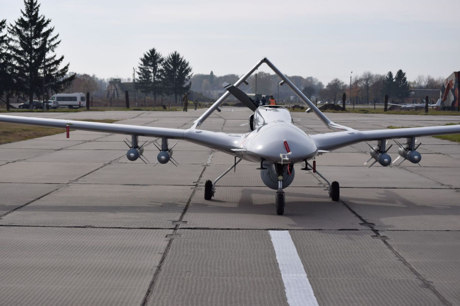

BAYRAKTAR%20TB2S%20SI%26%23775%3BHA%20ve%204%20MAM-L%20Mu%26%23776%3Bhimmat%26%23305%3B.jpg
TB2 BAYRAKTAR is seen with 4 MAM-L Munitions under the wings

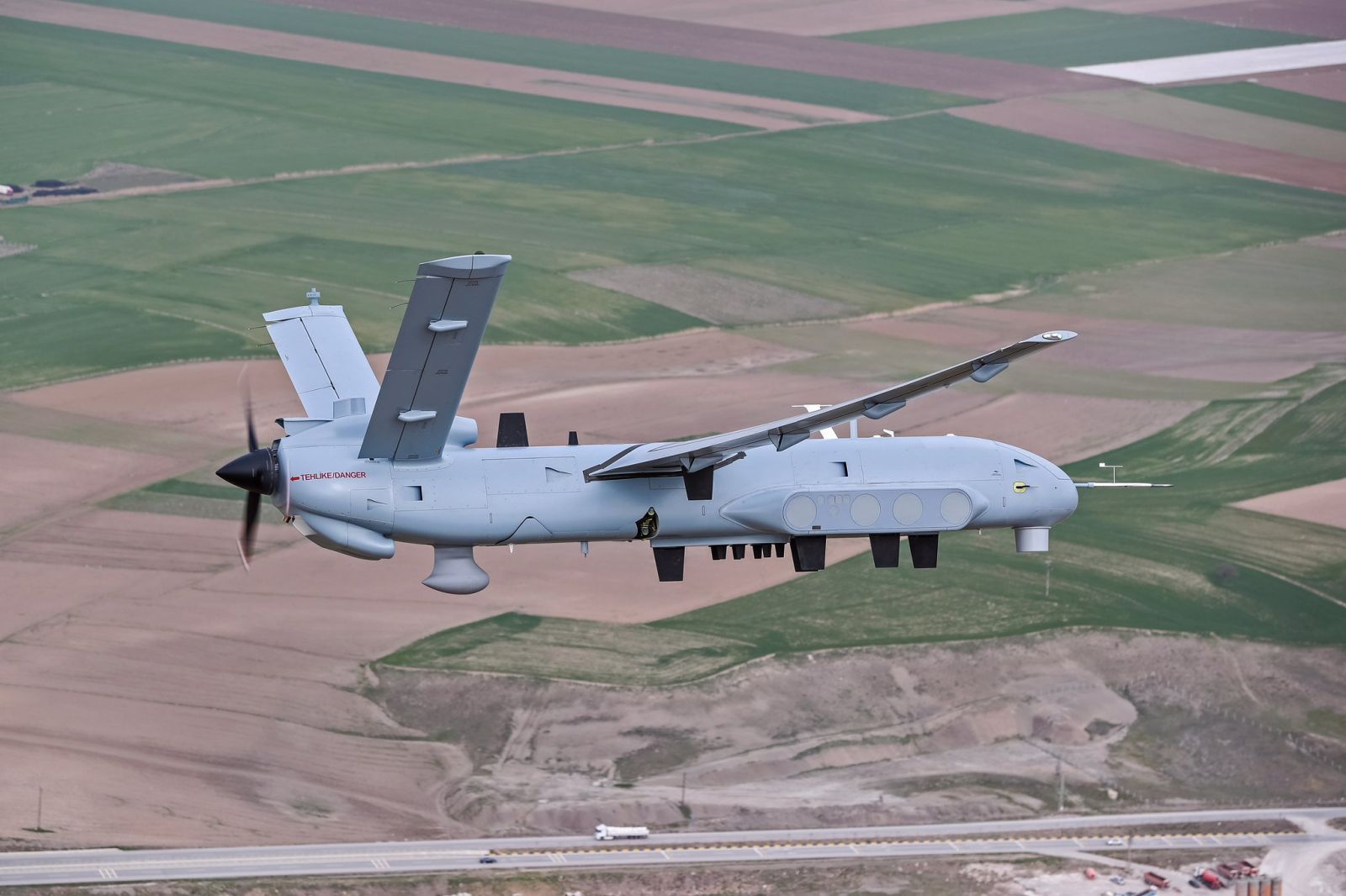

While Turkish Aerospace Industries (TUSAŞ) started the indigenous development of medium altitude long endurance (or MALE class) ANKA drones in 2008, the project’s final production version of ANKA-B only became operational in 2016. The TuRAF was very ambitious in its request for the ANKA from TUSAŞ and asked for some improvements to be made in the production version ANKA-B. Among those requested improvements SATCOM, PD170 diesel engines (made by Turkish Engine Industries and provides 170hp), long-endurance, Aselsan made CATS E/O and Laser Designator system, PLS (Personal Locator System to find ejected aircrew), and armed with suitable weapons. TUSAŞ designated this version as ANKA-S, which is considered the most advanced ANKA. It could be one of the best-equipped UAVs in the MALE category.
The maximum takeoff weight (MTOW) for ANKA-S is 1.6 tons. It can carry 4 of MAM-Ls and operates at altitudes of up to 30,000 feet. SATCOM gives ANKA-S almost unlimited range (with the availability of fuel) and safe communications with ground control stations. ANKA-S proved itself when Turkish forces launched Operation Spring Shield in the Idlib region of Syria against Syrian forces in March 2020. ANKA-S operated under heavy Russian GPS jamming and spoofing conditions, as reported by some Turkish news outlets. The TuRAF's initial order for the ANKA-S was 10, but later 10 more were added to the order.

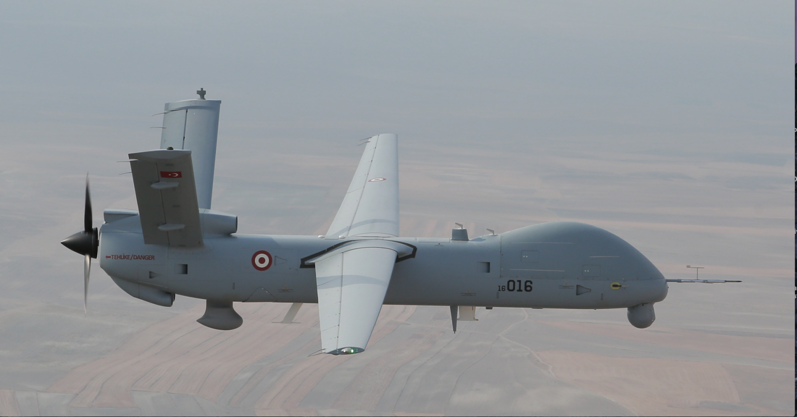

ANKA-I ELINT/SIGINT Configuration
Turkish TB2 and ANKA-S needed to work around Syrian ADS to provide real-time ISR to the Turkish command and control chain during the land operations. Turkish drones needed some help from Turkish EW assets, which were also located at Turkey's Idlib borderlines, to keep an eye on the Syrian ADS activities. It is noteworthy here to talk about the Turkish Armed Forces' land-based EW (electronic warfare) systems. In fact, the land-based Turkish EW assets are one of the less know military hardware that is unique to the Turkish Armed Force's operational concepts. Moreover, no other country in NATO, including the US, has an extensive land-based EW system as that of the one operated by Turkish Land and Air Forces. Turkey paid special attention to gaining land-based EW capability since 1990 or even before.

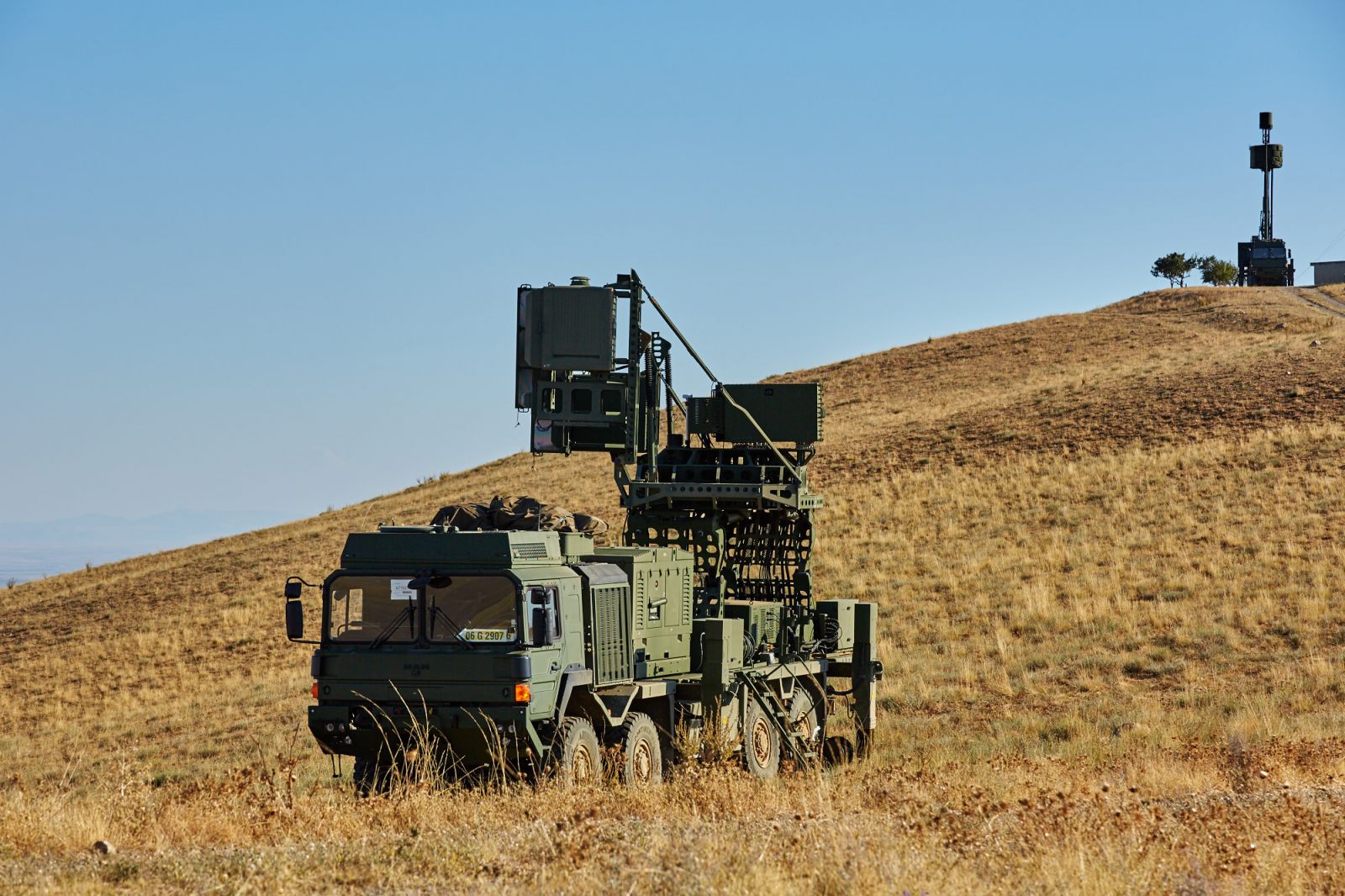

MILKAR-3A UHF/VHF ESM&ECM System
MILKAR-3A3 UHF/VHF Electronic Support (ESM) and Electronic Attack (ECM) System (Aselsan): The system consists of two separate 6x6 trucks with related system antenna assembly and generators. The system has been developed for electronic attack operations against UHF/VHF frequency band communication systems located on the battlefield. The system can either completely block the UHF/VHF frequency band or spoof enemy communications by sending incorrect information to the enemy forces on the battlefield.

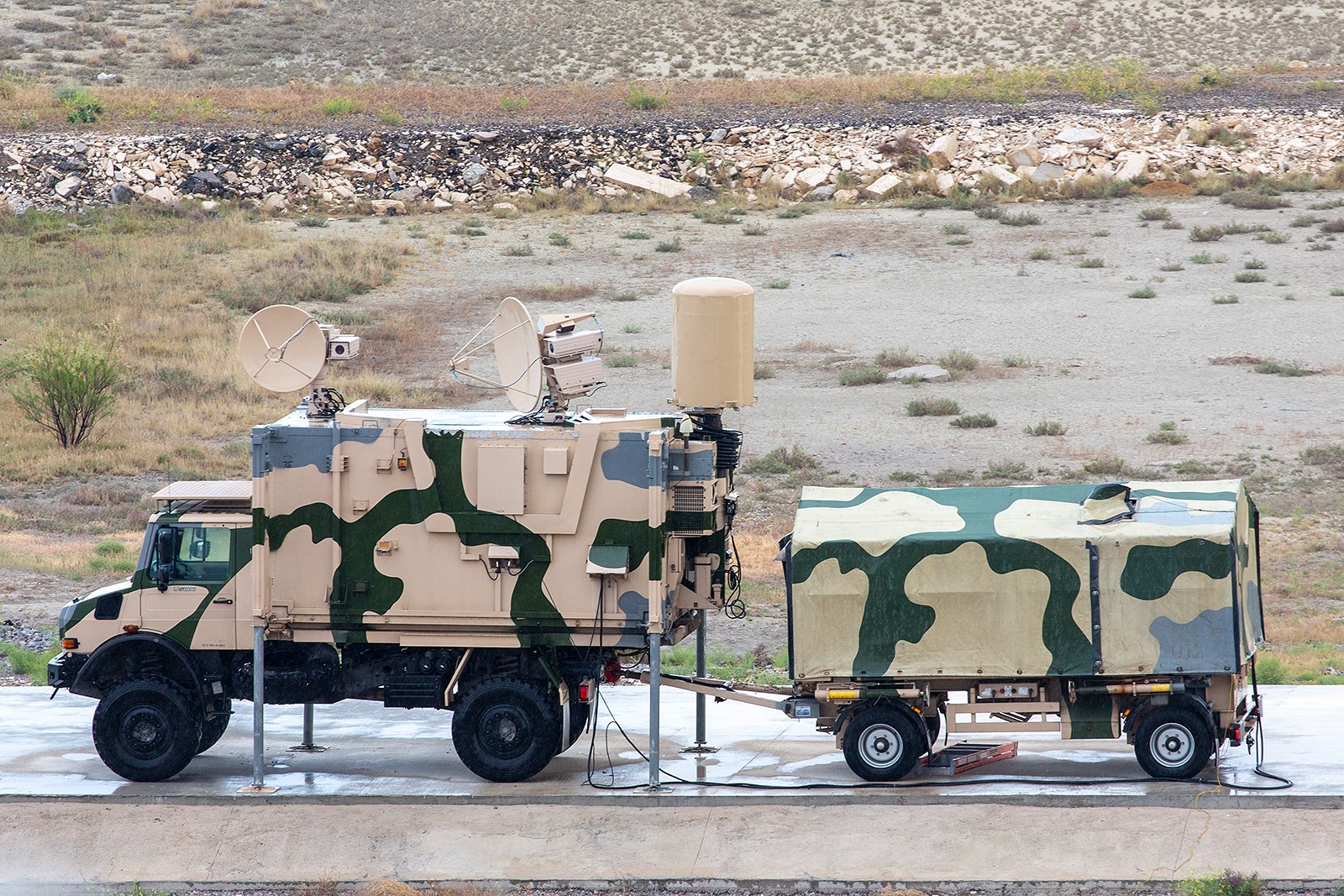

KORAL Electronic Support and Electronic Attack System (Aselsan): The KORAL is a land-based, full-spectrum radar electronic warfare system designed and produced by Aselsan. It became operational in 2015 and saw first operations in Syria against a wide range of air defense systems, including Russian S400 or Syrian ADS. The system's architecture is based on the operational needs of the Turkish Air Force (TuRAF). At first, REDET-I/II and KORAL look similar systems for similar needs, but the TuRAF’s requirements or specs were much higher than the Land Forces due to the radar and ADS threats faced by the TuRAF from the neighboring states around Turkey. The KORAL system consists of two 8x8 military trucks, each carrying electronic support (ES System) and a multi-band electronic attack system to cover the full electronic spectrum. KORAL has a different antenna architecture compare to the REDET system used by the Turkish Land Forces. According to open sources, KORAL uses a phased array antenna structure to perform multi-band electronic support and attack duties. The system also uses the latest DRFM (Digital Radio Frequency Memory) technology to digitally copy the RF threat signals and retransmit them back to the original radar source with fake signal returns by altering the actual radar returns. This way, the threat radar is spoofed with false targeting information and the air defense systems can miss identify or cannot track real targets for a firing solution. According to open sources again, KORAL is so powerful that it can perform electronic attacks up to 150-200km against RF threats.
