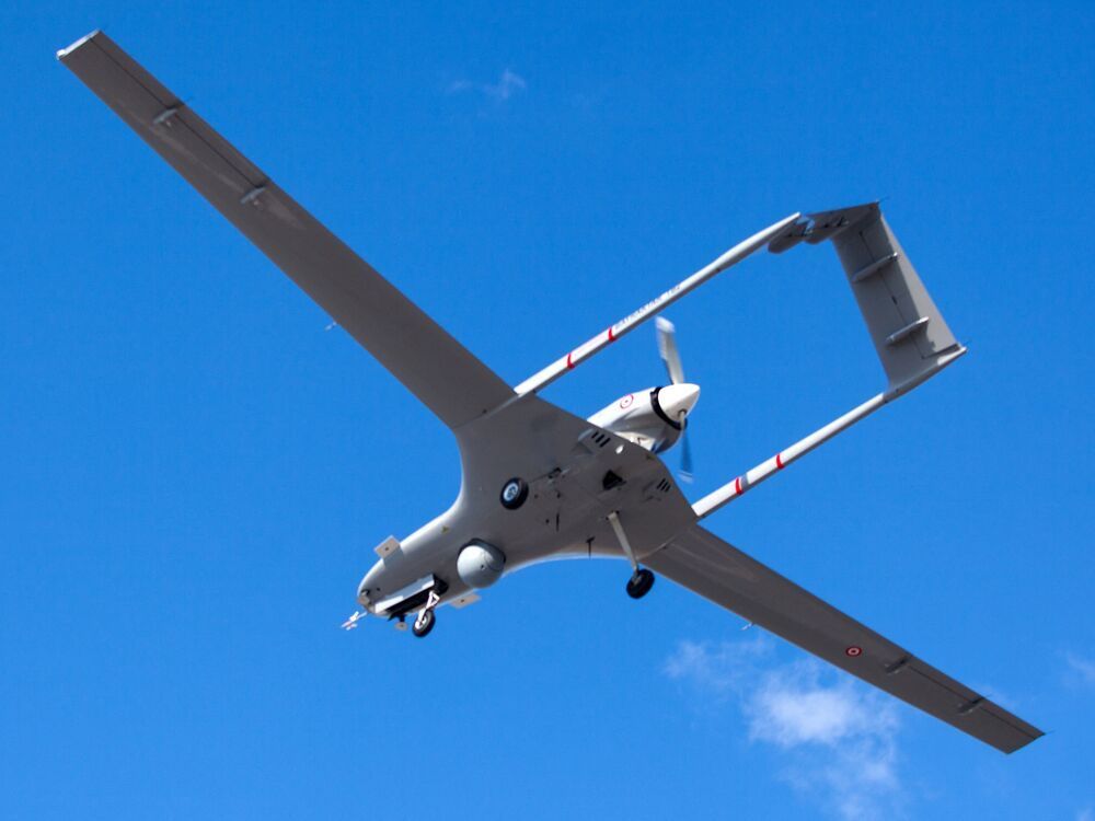

Drone cameras Canada to send to Ukraine banned earlier for export to Turkey because of use in combat​
The cameras Canada will provide to Ukraine for use against the Russian military are the same ones the Liberal government earlier banned for export to Turkey after they were used in combat.
Prime Minister Justin Trudeau announced Wednesday the government would provide $50 million in new military and humanitarian aid to Ukraine. Some of that money will be used to purchase Wescam surveillance cameras for Ukraine’s Bayraktar TB2 armed drones. The Bayraktar TB2 is built by Turkey and has been sold to Azerbaijan, Ukraine, Poland and several other nations.
Sources tell this newspaper the money will be used to buy between 30 and 40 of the cameras from L3Harris Wescam in Hamilton, Ont. It is not known how quickly the surveillance cameras can be made available to Ukraine and the Canadian government has not provided any details.
Last April, Marc Garneau, then Canadas foreign affairs minister, put a halt to exports of L3Harris Wescam cameras to Turkey for use in the Bayraktar TB2. The ban on exporting the sensors to Turkey came after the Canadian government determined the Bayraktar drones were used by Azeri forces fighting Armenia in the enclave of Nagorno-Karabakh.
“This use was not consistent with Canadian foreign policy, nor end-use assurances given by Turkey,” Garneau stated.
The ban on exporting the cameras to Turkey will remain in place.
Ukraine is believed to have around 50 of the Bayraktar TB2 drones, which it first bought in 2019.
The relatively low-cost Bayraktar drones have been successful in targeting tanks and other armoured vehicles during various conflicts. Ukraine has posted video of one of the aircraft attacking a Russian military column.
The Wescam equipment is also installed on U.S. Predator drones that have been used in what the Americans call “targeted killings” involving terrorist targets. But it has also been estimated that between 10,000 and 20,000 innocent civilians have been killed in those drone attacks in Afghanistan, Somalia, Pakistan and Yemen.
Turkey, a NATO ally, reacted angrily to Canada’s decision last year on the export ban. Officials there warned that the Canadian response could cause serious problems to Turkey and its drone clients.

And what are Ukrainians gonna do with those flir camera's? It's only worth something if it is placed on a drone

They will not waste their time awaiting for the maintenance (doubt if they can even maintain those). They will swap the E/O and the drone will continue its schedule with minimal maintenance.

I wonder if the E/O on TB2 to Ukraine is using Wescam. I think it may be since Canada announced the aid. It would be really ridiculous otherwise.
Would Aselsans E/O on TB2 use same configuration as Wescam. Wouldn't there be a difference in programming to a certain degree including calibration ?

The train bombing scene had the usual GUI but the quality was a bit low, like Aselsan CATS. It could be due to capturing a monitor screen by a phone though and I don’t think if CATS is used the GUI/symbology would remain the same.
Also I saw a new GUI mode where constant laser spot or representative of it is visible, like the one in the moving vehicle bombing. I don’t remember it from previous footage. Could it be due to a new designator or a new symbology mode to help the operator? (The black lines are edges of multiple screens so disregard it but the spot is there)

Unless Canada embargoes the export customer, then TB2s are delivered with Wescam E/O upon customer request.
I don't think they have embargoed Ukraine earlier or restricted export of the Wescam products, i presume? If they did otherwise their recent act becomes funnier.
