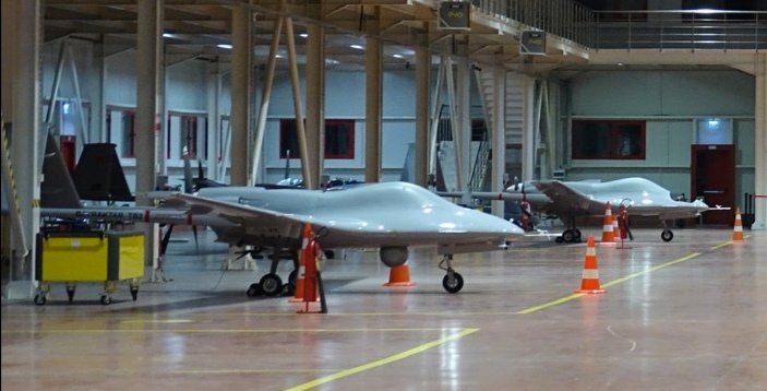

Could it just be an image anomaly, or is that a SATCOM on TB2?
The first to realize this was @Combat-Master (Sharp eye) :)

Why do we need TB3 now ? This is perfect!
MALE UAV, bigger payload, better electronics, much more room for new better subsystems, can be used as subsystem testbed for bigger drones. Much cheaper than Akıncı.
Also think about the export market, would be mistake for Baykar to not to get into MALE UAV market.

If they could fit the PG115, Aselsan CATS and Turkish made SATCOM and tested and verified it in such a relatively short time all the kudos to the Bayraktar team for their remarkable work. If so this will shoot the local input rate to 98+% on component basis I guess.
