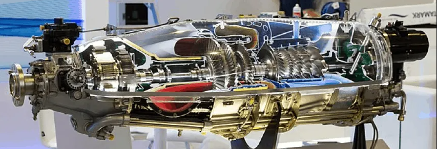

Piston vs. Turboprop: Efficiency
Piston engines and turboprops are both internal combustion engines that must compress air, burn that air using fuel and expel the resulting exhaust gas. The thermodynamic properties that govern these engines result in interesting compromises between the two systems.
Generally speaking, turbine engines lose efficiency as they become smaller while piston engines become less efficient as they grow larger.

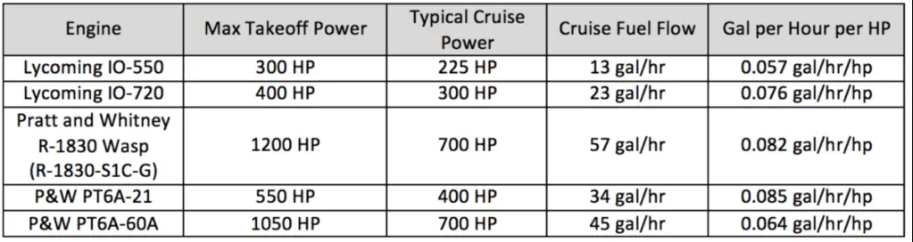

As an example, consider the following engines and their respective fuel flows at typical cruise power settings.
Typical Piston and Turboprop Cruise Efficiencies
Before digging too deeply into the chart above, it is worth noting some details. The data above is representative, and non-specific to a particular aircraft, and represents typical values only.
Turboprop engine cruise data is more typically referenced with respect to torque output, but for the sake of direct comparison horsepower values are used.
Finally, the data above is for maximum continuous cruise, not for reduced power settings, this flight condition was selected to represent maximum performance of the engine.

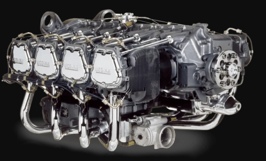

Lycoming IO-720

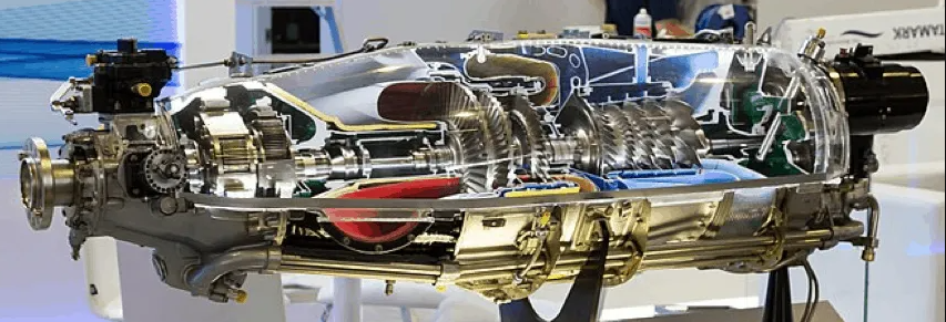

Pratt and Whitney PT6A

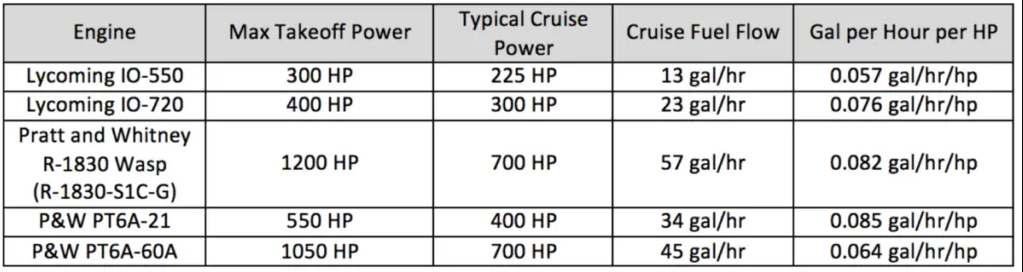

Fuel Flow and Specific Fuel Consumption​
Using a cursory review of the data above, the raw fuel flow values are misleading. The Lycoming engines appear to hold the advantage in terms of pure fuel flow, besting the PT6A-21 by at least 11 gallons per hour.
Closer inspection however reveals that the specific fuel consumption or Gal/Hr/HP value favors the IO-550 and the PT6A-60A. At the extremes of the power output ranges, efficiency is dramatically improved, the engines burn less fuel per hour to generate a given power output.
It is apparent that at some point larger and larger piston engines become less efficient relative to similarly sized turbine engines, and conversely, smaller turbines become less efficient than similarly sized pistons.
The exact crossover point where this happens is somewhat dependent on the particular installation and the mission profile of the aircraft.

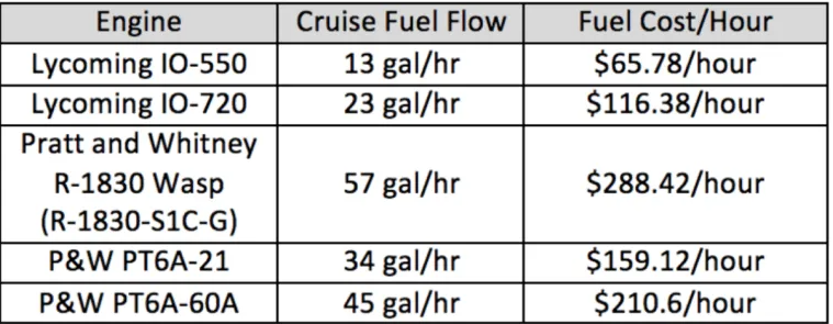

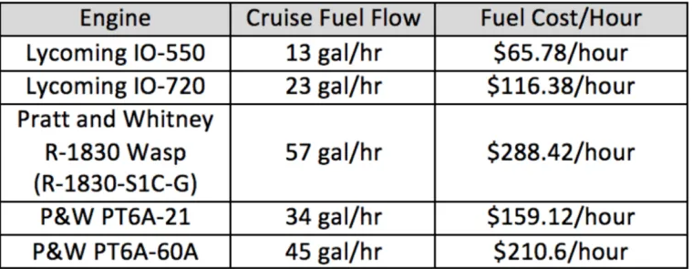

Fuel Costs
Finally, discussion of cost would be incomplete without a discussion of fuel costs. Referencing AirNav.com average fuel price data as of December 2019, 100LL fuel (avgas) averages $5.06/gallon and Jet-A averages $4.68/gallon (see our article on “Why does jet fuel cost less than 100LL?”).
Applying these averages to the fuel burn data above in table 1 the
following direct fuel costs result:
It is again evident that the turboprop engines command a premium with regard to direct fuel costs at the “low” end of the power range; however, that margin narrows as the power output of the turboprop engines increases.
This is a direct result of the improved thermal efficiency of turboprop engines. This fact again makes the operating costs of small turboprop engines difficult to justify in small aircraft such as the Beechcraft Bonanza or the Cessna 206 Stationair.

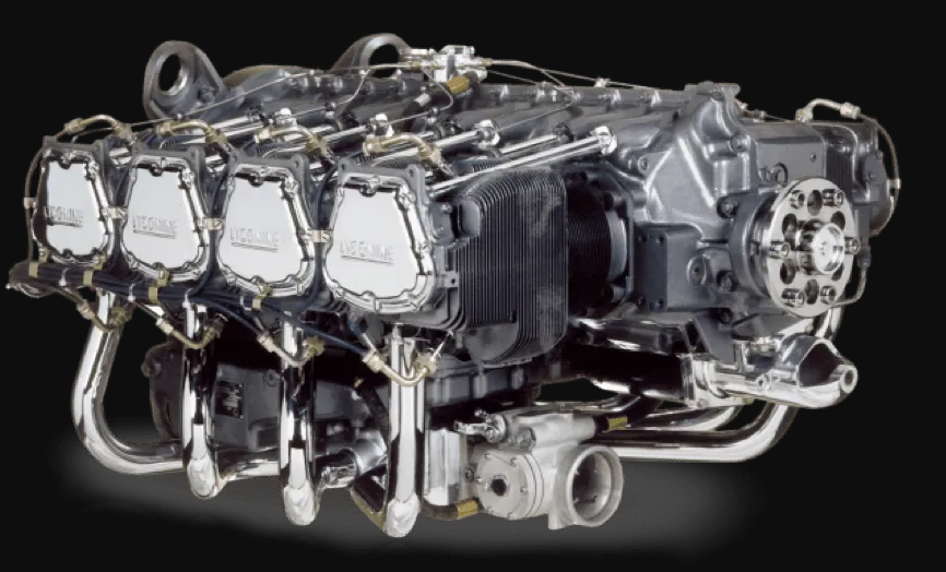

Lycoming IO-720
