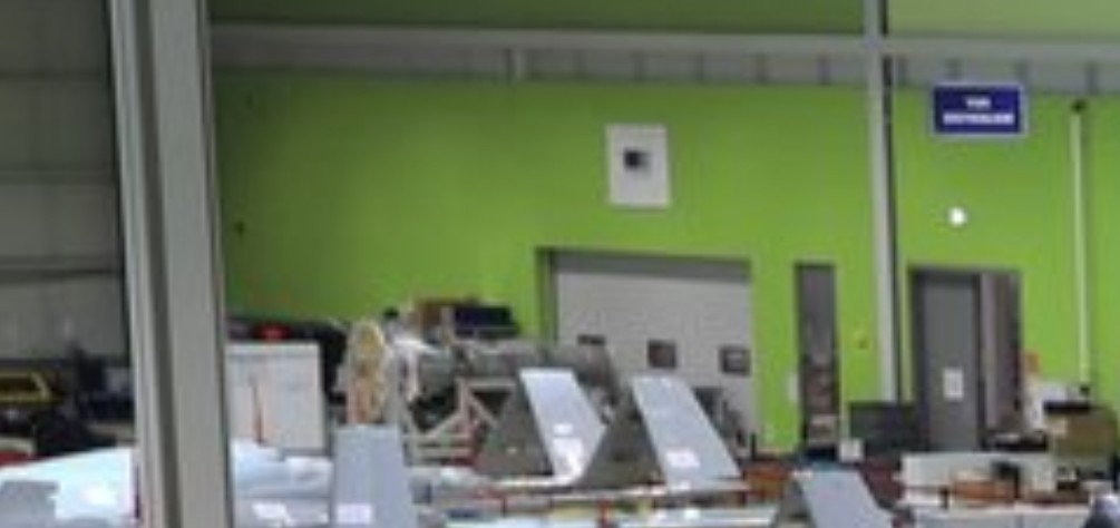

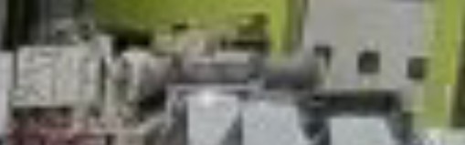

The only place that uses the AI-25TLT connotation is Wikipedia. (We all know how dependable Wikipedia is!) . That is supposed to be a joint venture manufactured engine of ”Black Sea Shield” between Ukraine and Baykar. We don’t even know if such an engine exists.
What we can see in the pictures here is an engine that looks like a Motor Sich turbofan. It may even have an afterburner.
There is an AI-25TL engine that has similar specs to what you have quoted, among the Motor Sich turbofan range. But no TLT!
All sites I have checked quote AI-322F engine being the engine to be used for MIUS.
Are you sure about the TLT version of this engine?
They may have picked out an engine from a production line that Motor Sich produces for the Chinese; like the AI-222-25F. At least that one has similar thrust values to the AI-322F that we want. (By the way even the AI-322F is not among the engines Motor Sich produces. These are designs of Ivchenko Progress. And they don’t manufacture engines)

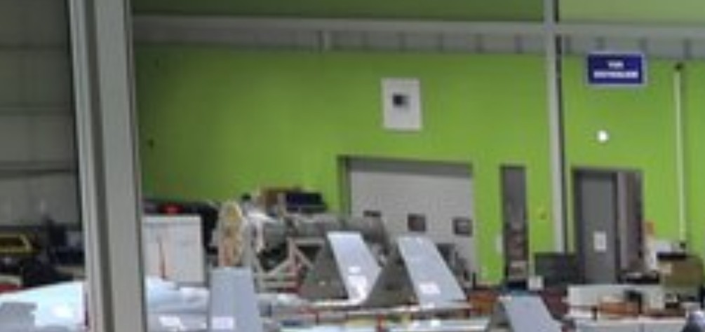

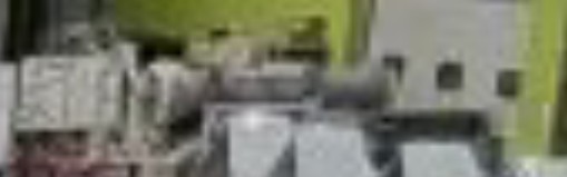

Also, the engine I have posted (from Baykar facility) is exactly an AI-25
4,336
276 22,718
Ivchenko Progress can not manufacture. They are like TR Motor. A design Bureau. Baykar signed that to manufacture under Black Sea Shield JV.
Just check out below engines that Motor Sich produces:
First one is AI-222
The other three are AI-25 derivatives varying from 3100lbf to 4000lbf
that Motor Sich Produces.
I really would like to know how you can tell from a heavily distorted picture that the engine there, is AI-25TLT.
To be honest with you, my understanding with everything that has happened is like this:
Baykar signed this agreement and a few months later war broke out. None of the engines were manufactured. But they picked out a AI-25 derivative of one sort or another to try on the prototype before production was halted. They did the same with Akinci. A 450 hp engine was used before the 750hp it was supposed to have.
Now there are no engines being produced at Motor Sich anyway. So TF6000 is the only way out. (Unless there is a production unit no one knows about that is producing engines under Black Sea Shield!! )
