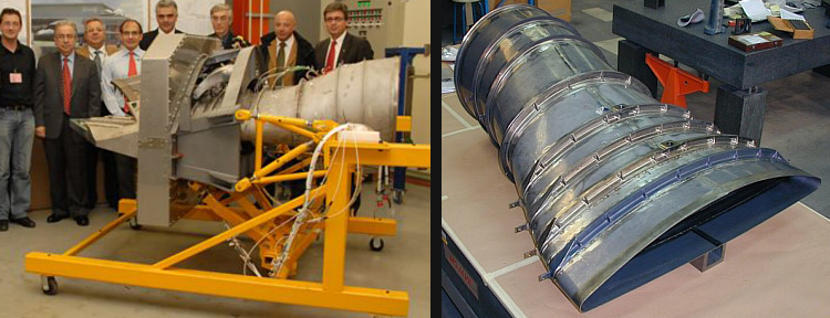

What would be the reason as to TAI not making the exhaust section of ANKA-III stealthy?
Exhaust section of nUEROn powered by Rolls-Royce Turbomeca Adour
To me it looks simple enough to do and with the resources that TEI has, having developed exhaust sections of turbofan/gas engines - I don't see why it wasn't achieved in the prototype ANKA-III
TAI must be holding some cards up their sleeve. The US kept the rear section of the B-2 secret for decades. I think TAI has a "public" version of this drone which can be used for development and testing and for public viewing. Ball gimbal on a stealth flying wing drone...for sure some TAI engineers had a laugh about that.
