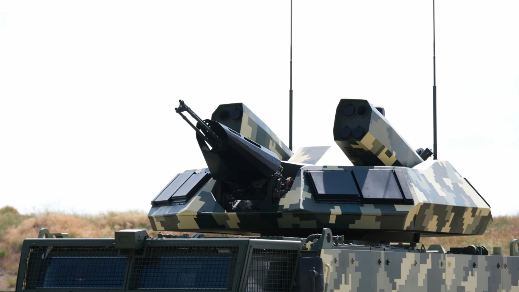

Is the Gatling a good choice?

On Burc System. It’s not our Army who developed this system. Don’t you think a single barrel canon would be better?
This triple barrel Gatling gun must be from ATAK helis. One cannon for multiple platforms however single barrel auto cannon would be more effective against cheap UAVs?
That 3 barrel gatling is 20mm, a single barrel 20mm would have very low firerate like 300-400 rpm. M197 is 750-1500 rpm. 6 barrel M61 is 6000 rpm.
M197 is certainly not rated for anti air role as it was devised. I'd like to see some actual fire tests with multiple high speed drones before I give my thoughts on it. We only saw one test, at night, firing at nothing.

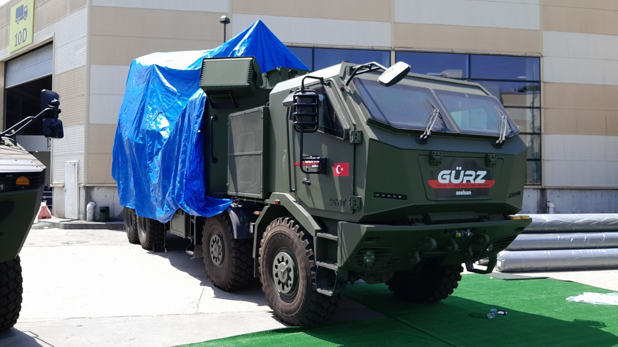

The first of the products unveiled by the company was the GÜRZ Hybrid Air Defense System. The company’s first product was the GÜRZ Hybrid Air Defense System. GÜRZ, according to Aselsan, is an innovative air and missile defense system with multiple interceptors against very low and low altitude air threats. This new Air and Missile Defense System will protect both fixed facilities and in-transit convoys from threats such as UAVs, helicopters, and airborne munitions. Mounted on an 8×8 armored wheeled platform, GÜRZ consists of components such as a 35-millimeter air defense gun, 8 low altitude air defense missiles, 4 active electronically scanned array (AESA) search radars, a fire control radar, electro-optical sensors, and data link.

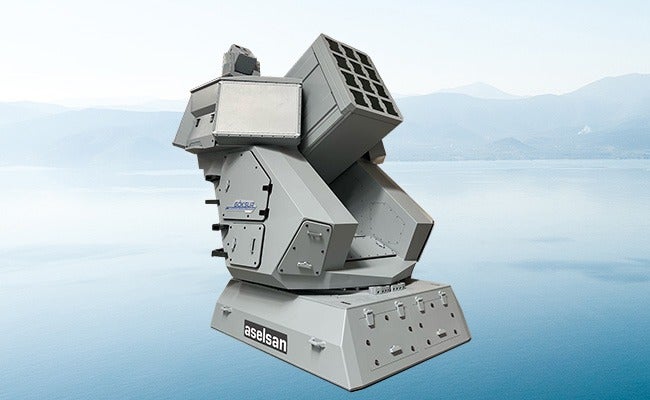

Another product unveiled for the first time was the air defense system GÖKSUR, produced for naval platforms. Developed as the equivalent of the US-made RIM-116 RAM System in Turkish Navy Ada class corvettes, GÖKSUR is a short-range, close-range air defense system. Three different configurations will be offered to adapt to changing threat conditions due to the modular design of this new system, which will be able to detect and neutralize various threats such as anti-ship missiles, unmanned aerial vehicles, cruise missiles, aircraft, and helicopters. The system will employ 12 IIR guided BOZDOĞAN-DH missiles developed by the Defense Industry Research and Development Institute of the Scientific and Technological Research Council of Turkey (TÜBİTAK-SAGE) as interceptor missiles. The GÖKSUR Close Air Defense Missile System, according to the company, has a number of features, including 360-degree threat destruction capability, the ability to intercept multiple targets, standalone and/or platform integrated operation, intermediate guidance with data link, and high single launch interception possibility.
The GÖKSUR Close-Range Air Defense Missile System developed by Aselsan / From Aselsan

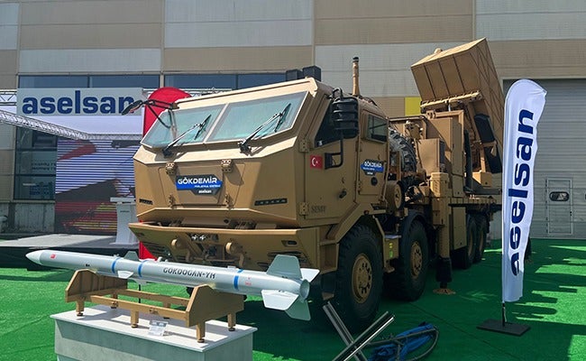

The GÖKDEMİR medium altitude air defense system was the last item the company launched in the field of air defense. The GÖKDEMİR Launch System mounted on the SEYİT carrier vehicle will be used to launch the GÖKDOĞAN missile, which was developed by TÜBİTAK-SAGE and updated in accordance with air defense requirements, during air and missile defense missions against threats from aircraft, unmanned aerial vehicles, helicopters, cruise and air-to-ground missiles. By integrating with the ASELSAN Fire Control Device, the GÖKDEMİR Launch System successfully completed its first test-fire in June 2022. According to the company, GÖKDEMİR, which can be prepared and deployed in a very short amount of time, has features such as 360-degree threat neutralization capability with its rotating turret structure, multiple engagement and sequential firing, intermediate stage guidance with data link, missile loading platform and crane system, multi-use canister, and wired/wireless communication.
The GÖKDEMİR Medium Altitude Air Defense System / From Aselsan

According to company officials, GÖKSUR has three configurations.
  • Full variant: The system showcased in the fair. This system will have the capability to work stand-alone and seek and destroy air threats autonomously.
  • Medium-sized variant: This variant will not have sensors on it, only missiles, just like the RAM system. In this variant, the number of missiles is expected to be increased, just like the difference between RAM and SeaRAM systems.
  • Fixed-location variant: This variant is projected to be fitted to small combatants with weak air defense capabilities, such as fast attacking crafts. In this variant, there will not be a rotating launcher. The missiles will be fired from fixed-angled launchers.
Fixed launchers are sure interesting, might be under consideration for highly maneuverable platforms and 2x at least.
I have heard that Mixed 35mm + Sungur-D/Sungur/Cirit/Others (with a pod) configuration was also considered for small boats with limited space and one-mount point or auxillaries, that rather can be a variant of Goker-D, not Göksur's.
Would they limit the engagement of the missiles? I wonder if that mixed system would be something like Aselsan's Atılgan, but with 35mm gun instead 12.7? It could be really great for our smaller boats and maybe even bigger USVs.

GÜRZ: I gotta say it perfects the concept of Pantsir. Especially by having a constant 360 degree search-track field and having missiles those don't rely on illumination constantly. Another plus would be ATOM capable 35 mm gun which is more effective against small UAVs.
That needs to be studied. I don't think they necessarily mean angled. The missiles have thrust vectoring, thus it might be a scenario to be applied with cold launch maybe? SAGE works good on the cold launch.
This one's for stationary base/landmark defending, covering the SAM sites against missile swarms, defending command sites etc.
