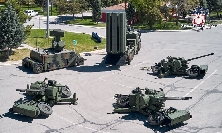

I think you're a bit confused there mate, because Oerlikon is just 35mm aa guns and not a missile system. The modernisation just allows it to use the same radar as Hisar, I think.
Read and look at this picture again.

Those are not Oerlikon "batteries" those guns are Oerlikon guns, built by MKE and modernised by Aselsan
I don't what that launcher is, but it isn't a part of Oerlikon aa system. It is either Hisar or something else.
At some point, Hisar-A has been conceptually incorporated into Oerlikon batteries (for base protection), but then it was said that Hisar-A wouldn't be part of it. I am not sure of the current situation, however given the specifications and duties of the A+ missile, it should be part of the Oerlikon battery. As I recall, Hisar-A also has the towed version, which seems reasonable for the earlier statement.
But man, I have grown old and my memory is weak and I lack the search skills.
You are wrong. That launcher is a Hisar-A FFS launcher and is part of the modernized Oerlikon battery.
Here you can read this.
"The AIC System is an air defence system developed for the effective air defence of critical facilities and fixed military units.
defence system. The AIC system will undertake the fire and command control of the 35 mm towed air defence guns modernised by ASELSAN and the Low Altitude Air Defence Missile Launch System (HİSAR-A FFS), which is also being developed by ASELSAN within the scope of the HİSAR project."
Hisar-A FFS is basically the same thing with Hisar-O FSS the only difference is one is loaded with Hisar-A+ missiles the other is loaded with Hisar-O+ missiles.
Here is the proof.
Land forces chose to distribute a low amount of Hisar-A FFS to Oerlikon batteries and mix Oerlikons with Hisar-A to achieve a cost-effective solution. Land forces freed up the budget and used most of the budget to get Hisar-O+ batteries with this approach.
Here is the proof.
GBkn2jyXsAA892e
Again, Oerlikon 35mm guns were modernized to use the same fire control system to be used with aa missile batteries, but they are not an inseparable part of them. We just put 35mm guns with Hisar batteries under the same control system to make them operate together. They also operate completely separately as they do for us and dozen or so countries around the world. It's semantics at this point, let's agree to disagree mate.
Again no. AİC can only command a single Hisar-A FFS. You can't set up Hisar-A batteries with AİC because commanding a gun and a missile launcher is inherently different. Read the document again. That is why, the Hisar-O+ system which has the same FFS as Hisar-A+, has a separate command control vehicle and a better sensor.
"The capability to undertake the firing and command control of 3 35 mm towed air defence guns and 1 low altitude air defence missile launch system"
