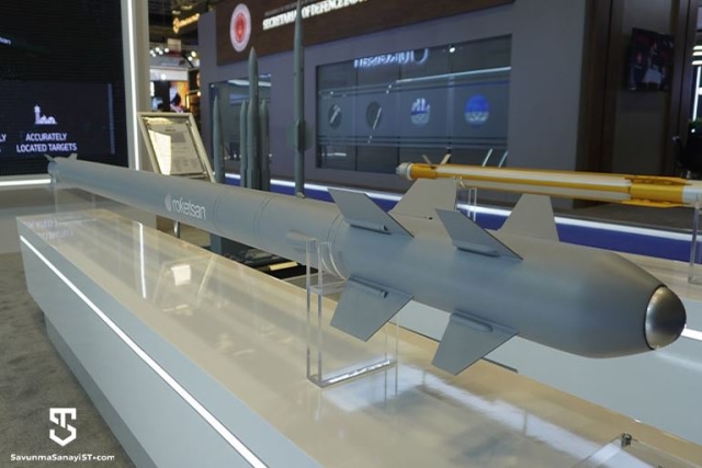

Levent missile is a larger version of the Sungur missile with a 128mm diameter. Also as can be seen from the below picture it is much longer than the Sungur. All this points to a much higher operational altitude and more than the 11+km expected range quoted by Roketsan.
There seems to be a cloud of secrecy about the development of this new missile. But if and when it becomes operational it will definitely be a game changer weapon.
Both missiles are very much capable to be effective from Sea, Ground and Air platforms. This would make them extremely versatile weapons.

SUNGUR missile is very important as it is MANPADS but i can't understand why to be created new design Levent line of sight missiles ?
The dimensions of Levent are almost as same as Bozdoğan on the other hand Levent is not as compact as RIM-116.
And both Levent and rim-116 can't be preprogrammed before launch however Bozdoğans flight path could be preseted before launch. Also current first block Bozdoğan without datalink should cost very reasonable rather than Levent.
This microwave seekers of Levent are vital? İ doubt. I would prefer GÖKSUR launcher with current Bozdoğan B1 rather than Levent .
If microwave seekers are vital,then they could add MW seekers to Bozdoğan.
I also find SUNGUR useless for navy.
35mm Göker with Göksur launcher is the best naval point defense systems.

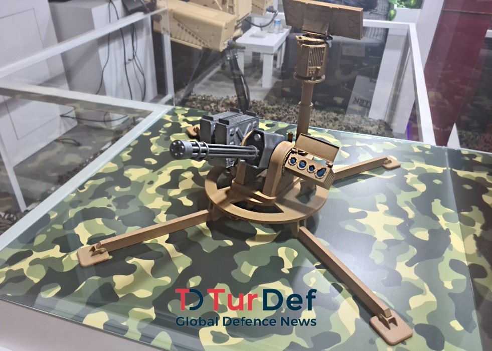

In how many seconds would that catridge need to be refilled?
No idea , but Phalanx doesn't burst all ammunition on to the one target. İts storage for 10 interception.
İf your ship had 4x this light CIWS, you would have enough ammunition to encounter several attacks. Why not put four modular light CIWS ? Several guns could shoot cross fire which would give you more hit.
With AESA and new sensors, This must be more sensitive than Phalanx. Modular, light, compact and autonomous.
Suppose it fires a 100 round burst at each target. If it carries 800 rounds then it will be able to intercept 8 targets. This would make each of these equivalent to 2x Hisar-A/O 4x4 TELs (in the munition defence role)
If it only carries 400 rounds then it would be able to intercept 8 targets by firing 50 round bursts at each target.
It depends on target. If you need to fire 150 rounds to hit the target. You will fire 150 rounds.

BTW what are they going to hunt from 20mm Gatling gun that fires one piece sabot?
İt would be useful just against low flying objects like helicopters, SU-25,A-10 warthog. You couldn't engage TB2 as flies Higher than 20mm cals range .
Quadrocopters and tiny UAVs could be intercepted from airburst ammunitions.
İn Ukraine they use shotguns .
İf 20mm could be programmed or time fused would be great. At least 10 pieces tungsten, kinda shotgun.
This is for low and slow flying targets, mostly drones as the name suggests. And as far as I know, smallest airburst round is 25 mm, 20 mm ones I know are grenades with low range. 20 mm airburst would be great, otherwise this thing would eat through ammo trying to hunt small FPV drones.

I'd rather have a 30x113 with proximity fuse if you ask me, 20 mm chomps through your ammo supply when it comes to hitting small UAVs
2,959
61 5,291
İf aims are just UAVs, yes you are right, single barrel 30mm cal VENOM with proximity fuse would be more effective rather than 20mm Gatling gun with very limited ammo storage.
Even 40mm ATOM will be more useful.
Damn what if they created ATOM 30mm cal with time fuse.

Long range, high velocity (direct and linear flight path / rapid reaction), high rpm.
Would smaller diameter mean any of that? We have high velocity 40 mm grenades and 30/35 mm bullets, I don't see what difference 30 mm would make.
