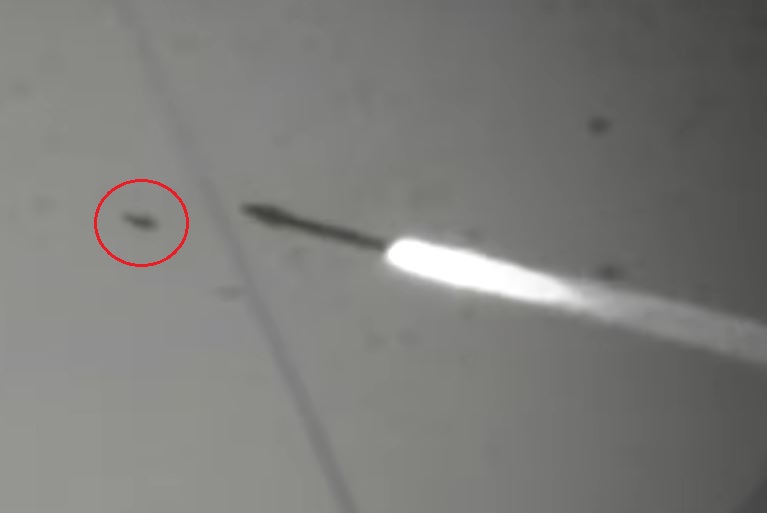

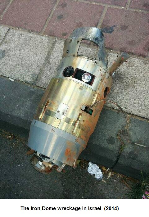

İron dome uses a Ku band radar seeker. No need to discard nose cone.
Iron Dome has optic seeker (radar seeker is too expensive). You can see separation of nose cone in this video (0:57-0.59):
As u can see nose cone is made of metal, not transparent for radar waves:

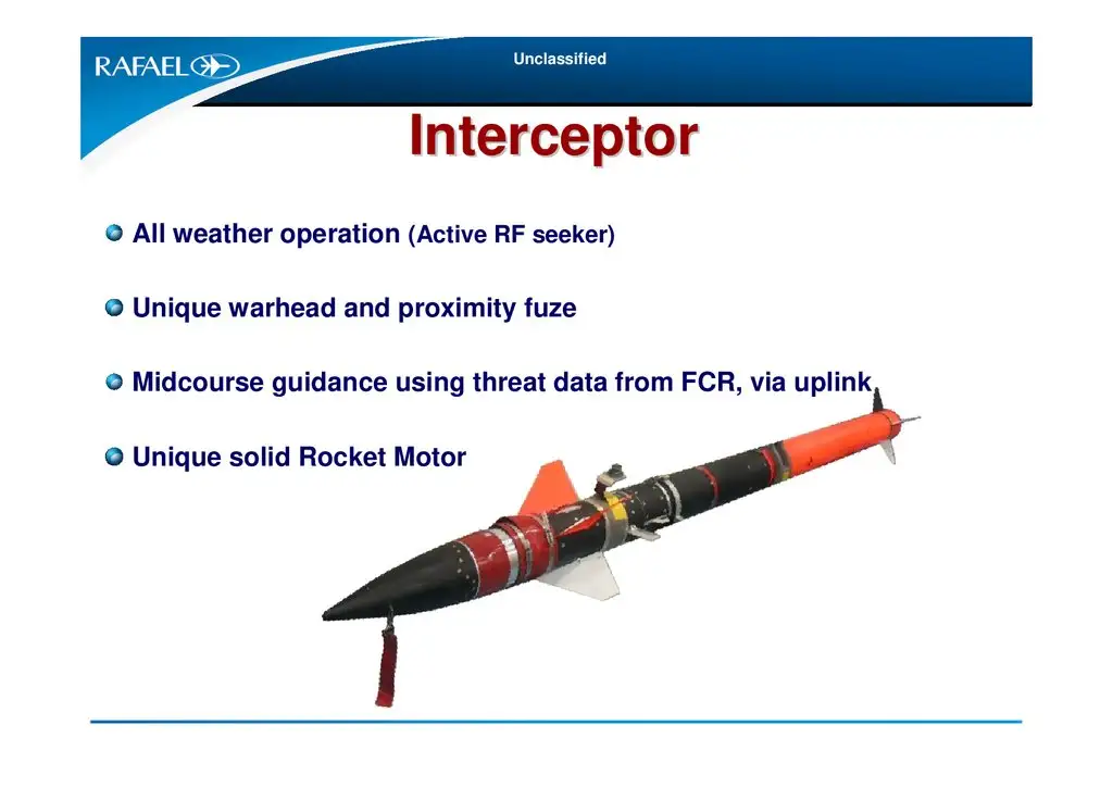

Tamir missile uses the most simple radar seeker , i would call it almost proximity fuse. The missile is mainly guided by main radar via datalink, Under electronic attack Tamir missiles are very vulnerable.
Remember how PANTSIR's 57E6 radio command missiles failed under EW in Karabağ.
Since Palestinians don't have EW capabilities , currently it is the cheapest and reasonable way to engage artillery rockets for Israel.
Just a tactical cheap solution against artillery rockets. Tamir missile costs 30-40k USD.
Hisar A+ with Imaging IR and also has strong resistance to ECCM, so it is not comparable with Tamir.
Just a tactical cheap solution. Tamir missile costs 30-40k USD.
1) All modern missile systems use radio command for midcourse guidance (except very short range). That does not make them vulnerable, on contrary. Pantsir uses radio command for final guidance as well.
2) There was no Pantsir in Karabakh.
3) Tamir has EO seeker.
Turko
İ can't see E/O here
There are a lot of different radio command devices ( datalink technology) subject to their prices.
Tamir is a cheap tactical solution.
