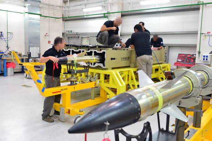

İ can't see E/O here
There are a lot of different radio command devices ( datalink technology) subject to their prices.
Tamir is a cheap tactical solution.
1) There is no datalink on missile, only a reciever.
2) You dont need anything complicated, just simple directional antenna looking backwards. It will be virtually impossible to jam.

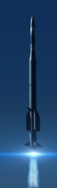

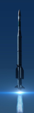

Also why RF has a longer range than IIR? Does the nose structure of a missile make such a big difference? If it does can someone explain how? Since a circular ball head has better aerodynamic properties and drag coefficient than a cone shaped head of same diameter, I would like to know what gives this extra range.

RF has wider body. Also one of the reasons that limiting the range was use of IIR seeker. RF seeker will have better range.

If RF missile has wider body, than it is less aerodynamic than IIR missile. That should make it’s range shorter.
Again; Why RF has more range than IIR? Please read my previous post. If IIR head is globular (circular) than it should be more aerodynamic. And should have a longer range than a conical shaped head.
It is the other way around. The pointed nosecone of a radar seeker has much less drag than the rounded seeker of an IIR missile. See the following link for example. Addition of a pointed nosecone to the Umkhonto ER is expected to increase its range by upto 10 km:
The Hisar RF could conceivably achieve a range of 35 km compared to 25 km for the Hisar O with just this modification.
