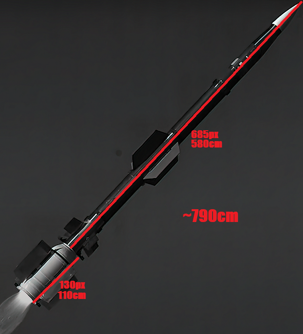

If "it has 20cm longer booster than Atmaca" rumour is true. I think Atmaca's booster has 90cm length so Siper's booster has 110 cm length with my calculation Siper B1 has ~7 meter length.

If "it has 20cm longer booster than Atmaca" rumour is true. I think Atmaca's booster has 90cm length so Siper's booster has 110 cm length with my calculation Siper B1 has ~8 meter length. View attachment 35158
You meant 690cm, right? 110+580=690 cm according to your notes. Above this length, it would not be good for VLS.

Oh sorry, my fault it should be 690 cm. In VLS it will probably use without the booster(for stacking quad/dual pack) so 580 cm should suitable for MDAS.
