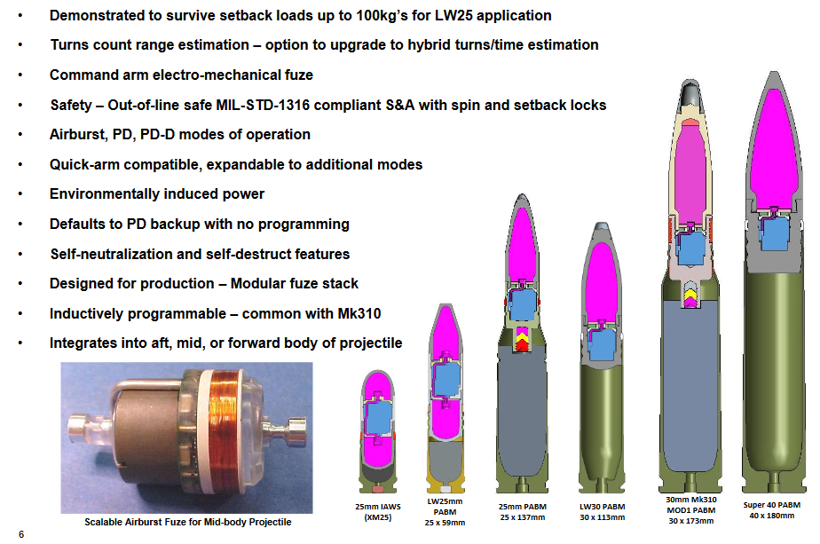

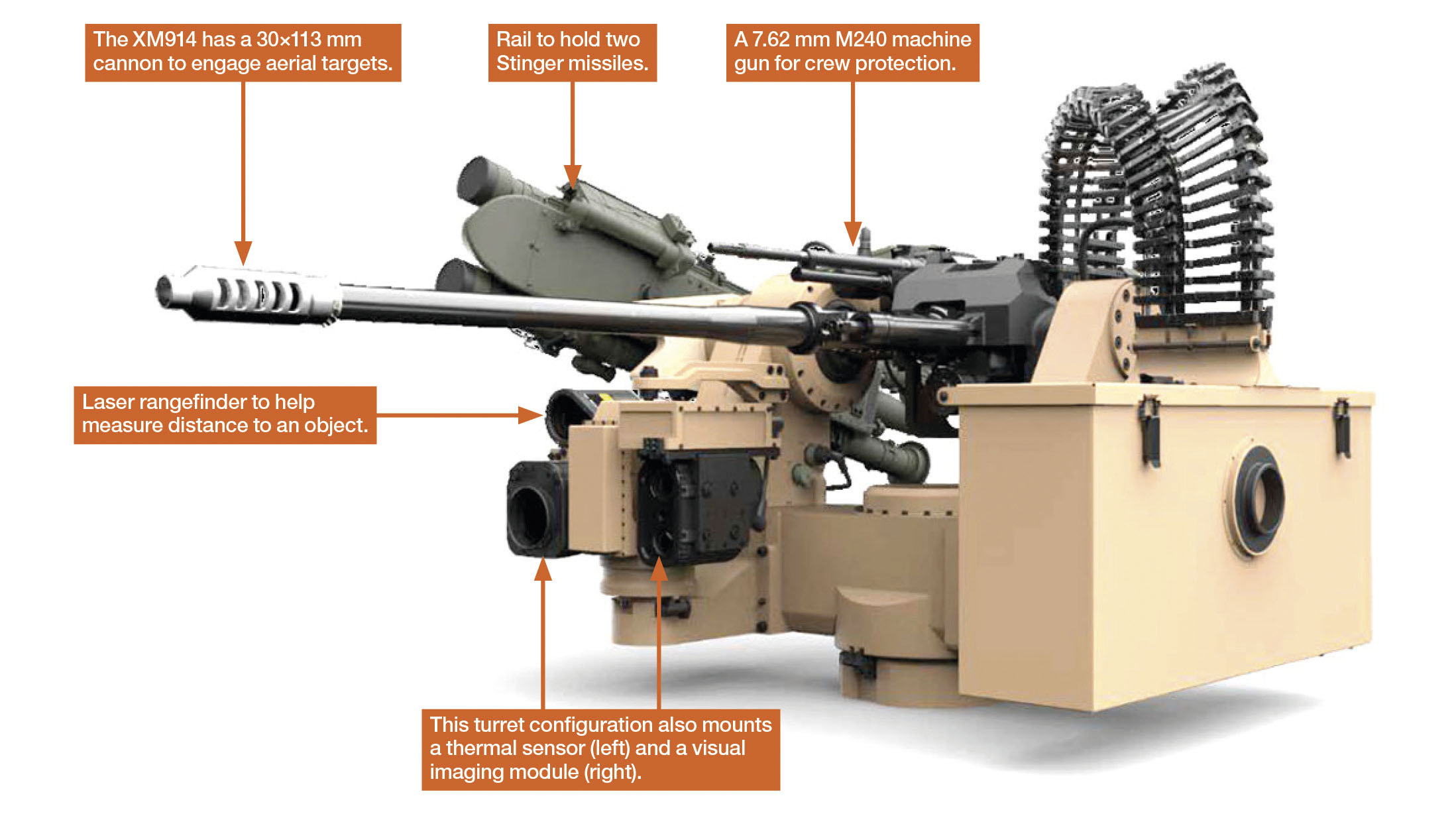

Americans have such projects. İt is unlikely a programmable ammunition, ammunitions have proximity fuse for airburst.
Even the short 30x113mm m230 chain could be transformed a CIWS with those smart ammunitions. Obviously it will allow creating compact platforms and easy loading systems.
İ don't know if short 30mm smart ammunitions would be effective against cruise missiles.

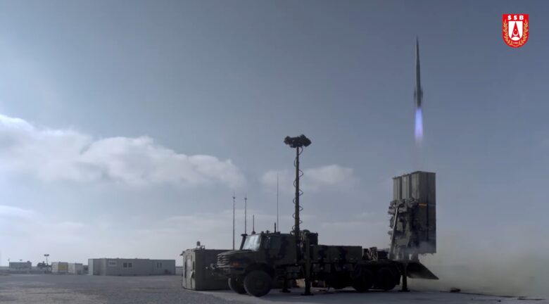

Hisar O+ system has been delivered to Turkish Armed Forces with all it’s ancillary equipment and elements.
So that means the short and medium altitude air defence systems for Turkey are now operational.
Next in line is the Siper, which will complete the first part of the AD needs of our military for the time being.
Then it is Siper with anti Ballistic Missile capability to come yet.

There will be no system between Hisor-O+ and Siper? Like Hisar-U?
