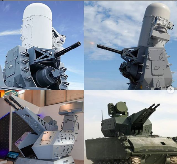

Is the c-ram not the same as phalanx, only that the c ram is the land version? If thats the case. MKE developed the 20mm CIWS, while aselsan have the gokdeniz 35mm. This 2 systems is for naval use, but i dont know if they are planning to have a land based solution.
C-RAM is the acronym for ; Counter-Rocket, Artillery and Missile
There are many versions. Best known one is the US Phalanx CIWS.
Yes both our Gokdeniz and the MKE’s Phalanx lookalike CWIS solutions can be used as C-RAMs. In fact Gokdeniz has been developed for naval use from “Korkut” close in air defence system.

Not necessarily! 20mm Phalanx system is imported, and costly. Korkut and Gokdeniz are local production and have many commonalities. If you think about economies of scale, then Korkut/Gokdeniz appears to be more economical way to go for us. Also it has a longer engagement range than Phalanx, and more versatile with the ammunition it uses.
MKE’s 20mm Phalanx lookalike version is an unknown entity at the moment. It is still in development stage. Long time before it can be accepted and integrated in to ships.
We know that a PHALANX costs best part of 14 million dollars. There hasn’t been an open source about cost of Gokdeniz. However Korkut system is being used and in the inventory of Turkish armed forces.
Most important part of a CIWS system is to be able to engage multiple targets as far away from the ship or ground assets, and not run out of ammunition. Phalanx has a very good search and track system. But uses a lot of 20mm ammunition to execute a hard kill. And is tested and proven system. Gokdeniz doesn’t use as many rounds. But by forming a wall in front of the target it achieves it’s goal. And is just as effective if not more from a further distance. It doesn’t run out of ammunition as quickly as Phalanx would.
Until a local alternative of Phalanx is in use, my money is on Gokdeniz.

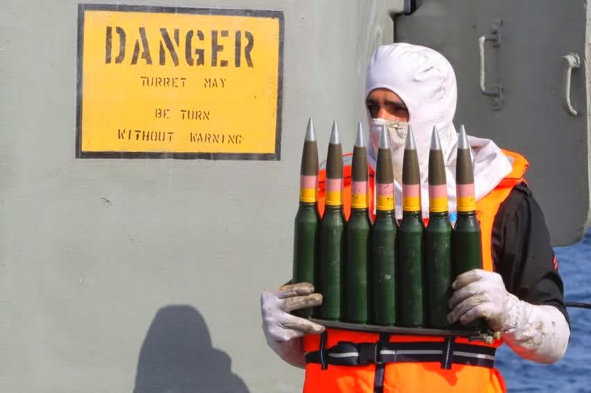

But Korkut has less ammunition since Phalanx has 1500 round which gives 15 engagements of counterattack.
Millennium gun has 252 round while it is bursting as hell. So neither Korkut nor Millennium can engage more than 5 times.

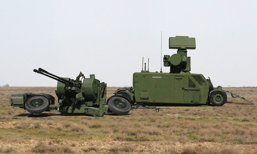

Korkut has 400 rounds of 35mm atom air burst ammunition. How many of these do you need to expend to form a barrier in front of the target?

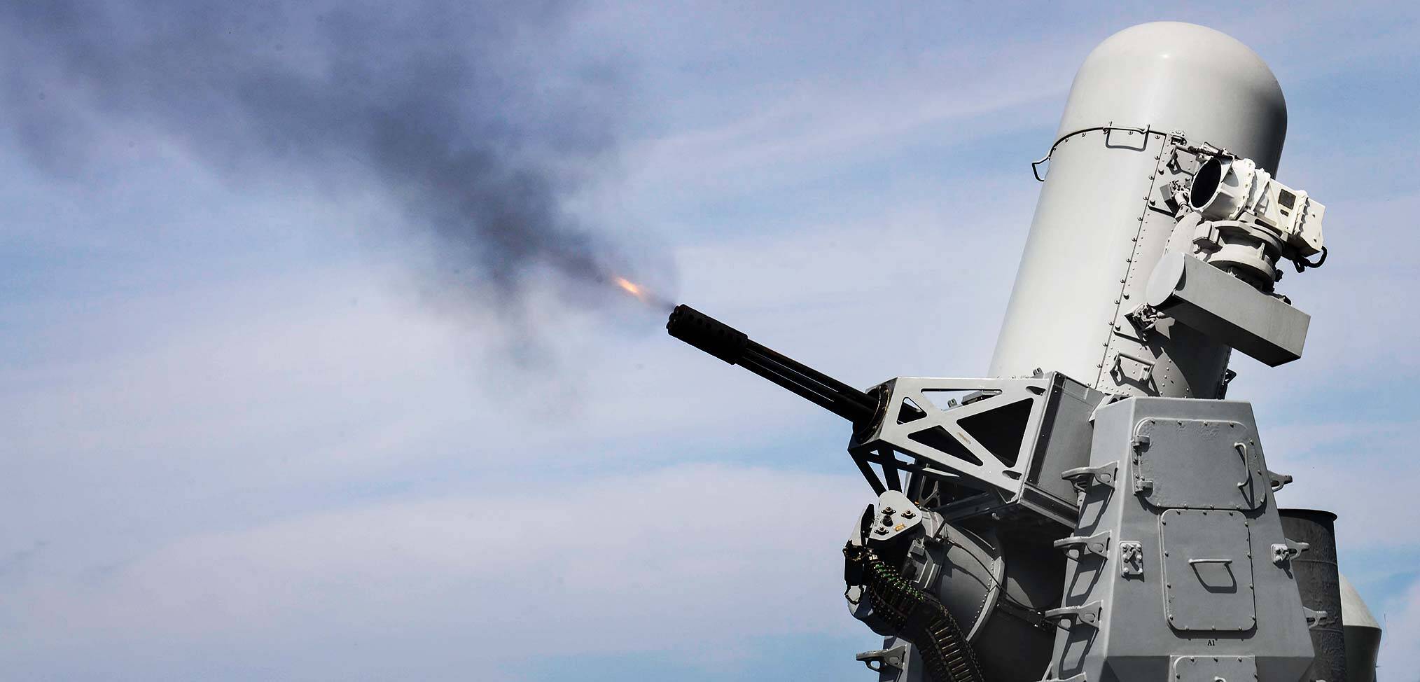

Latest version of phalanx has a 4500rounds/minute fire rate. That means in 20 seconds it uses up all it’s ammo.
Korkut fires at a rate of 1100rounds/minute. So at nonstop firing they are about the same. But since Korkut doesn’t have to achieve hard kill to destroy target, it doesn’t use as many rounds as Phalanx. Gokdeniz however, has not revealed how many rounds it will house. But looking at the size of it’s armoury it is going to be a lot more than 400.
Phalanx spends app 100 rounds for every engagement so 1500 rounds give 15 engagements.

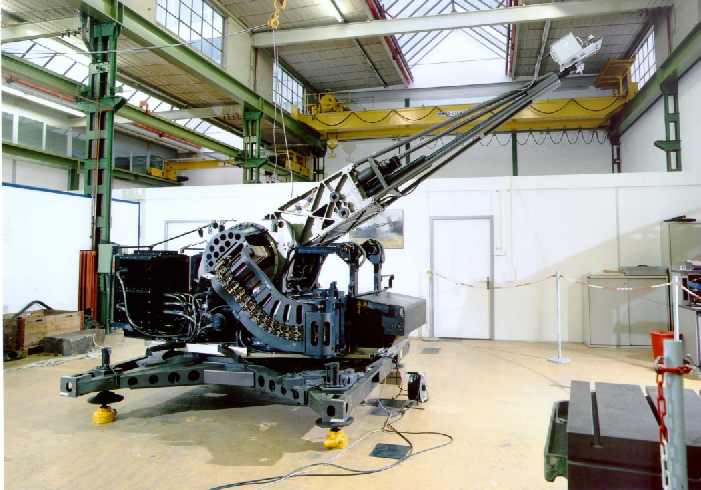

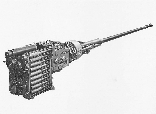

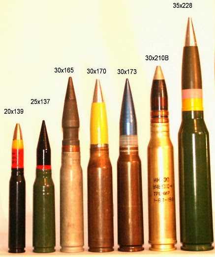

I don't think Korkut has more than 252 35mm rounds. Difference between Millennium and Korkut just is a number of barrels. Although millennium has one barrel , the system uses double feed mechanism at left and right sides. I saw a double feeding mechanism of Millennium Gun but unfortunately i can't find it now.
EDIT : i found.
KDA:

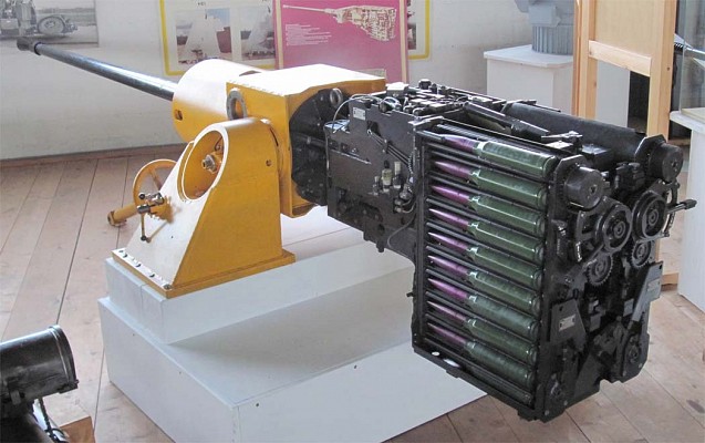

Also OERLIKON 35mm gun doesn't have too much capacity. Operators load ammunition while gun is firing.
Feeding mechanism of Sky shield might be different from Millennium.

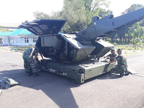

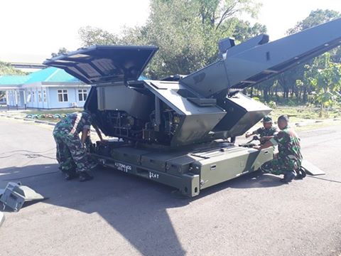

Some images of Skyshield.
Look neither Skyshield nor Millennium Gun is more compact than Korkut.

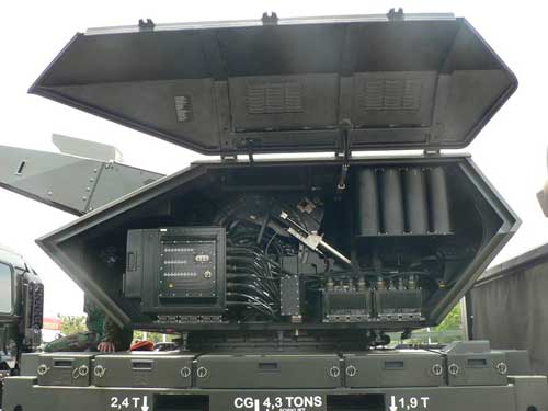

Korkut has like 420~ rounds for its 2 guns. Both are almost the same gun except cannons because actually they are products of the same project..
Turko
I'm sorry but i doubt that it has 420 pieces 35 mm rounds.

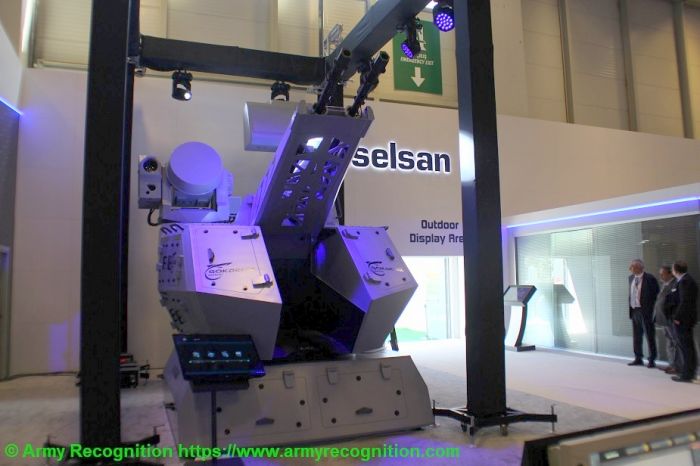

What we know about Gökdeniz (solely gun part) so far;
  • It is made to provide more engagements per reload compared to Phalanx.
  • It provides better scalability of rounds-per-minute and switchable munition that is vital against anti-symmetric threats.
  • Less agile than Phalanx but with the most recent configuration Navy is satisfied with the reaction performance in the most adverse threat approaches, there is no way to match reaction of Phalanx with the current architecture.
  • Probably better in capturing supersonic-hypersonic threats by using pellet-clouds at longer and safer distances.
  • Better if the threat is soft-shell, worse if the threat is hard-shell.
The rest of the advantages or disadvantages will be based on facts given above, so i am not listing those.

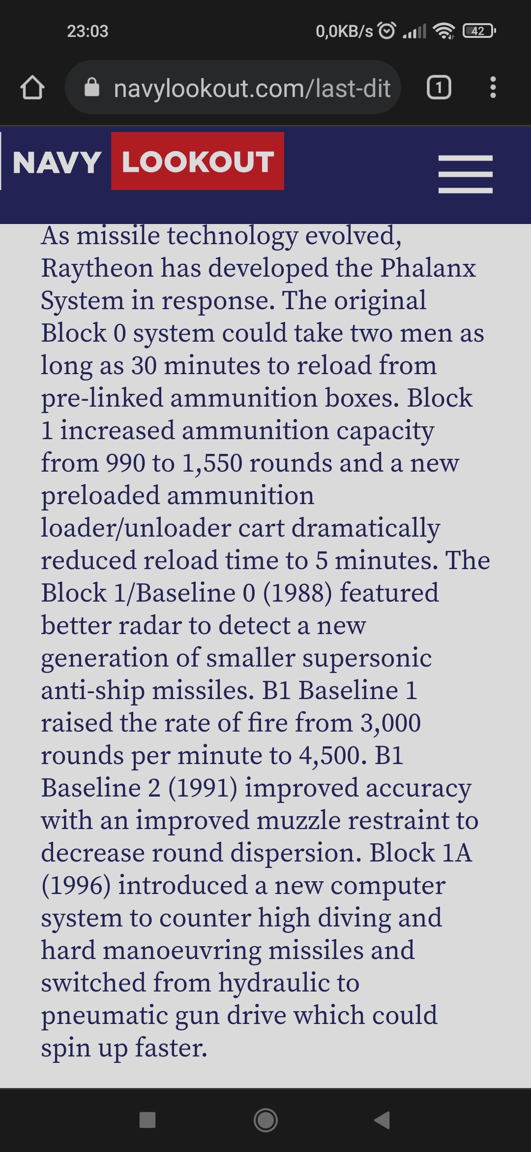

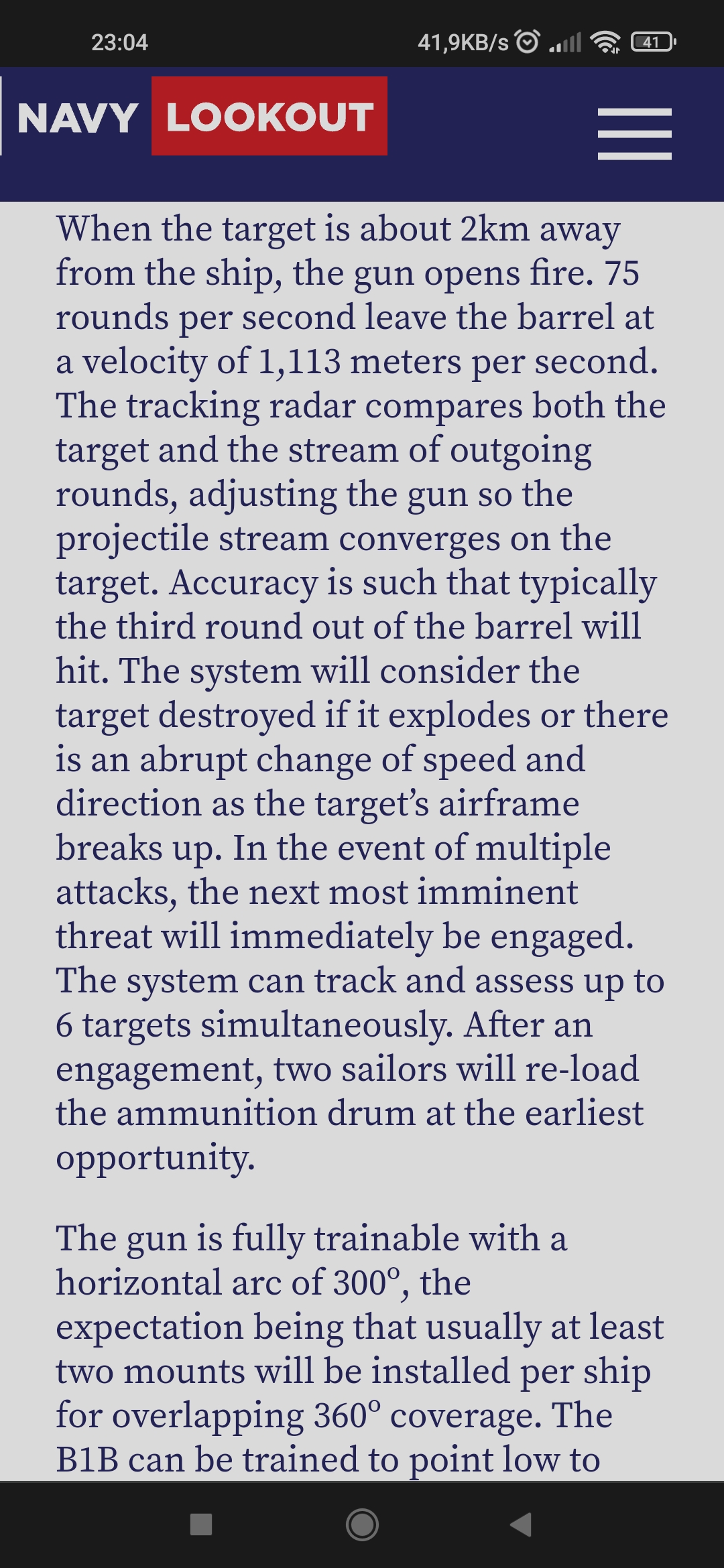

According to internet sources Phalanx bursts 100 ammunition for an engagement however we don't know Korkut/Gökdeniz how much bursts?
Yet loading is difficult, phalanx has 1500 rounds. Again we don't know about ammunition capacity of Gökdeniz either feeding system.
Edit : phalanx is reloaded in 5 minutes.

Gökdeniz, Korkut, improved - towed 35mm low-altitude defense system all uses the same mechanical system and ammunition that eases maintenance and logistics by a great extend. So if decision is made for 25-30mm in future, it shall be done with a common barrel, common reloading mechanism and mechanics. Now if time comes to urgent maintenance of Gökdeniz, that shall be done by a technicians affiliated to land forces in any of the ports with ease. For Phalanx you are going to seek for that technician who has the spares in stock, and then transfer him to the port that ship resides.
