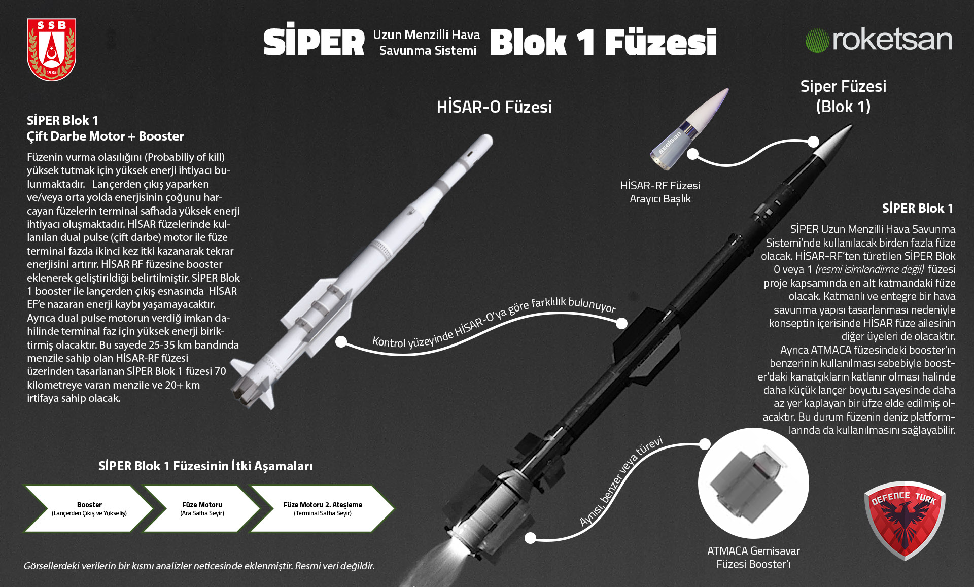

In short ; they have taken a Hisar O missile, slapped a booster used in Atmaca at the bottom of it then replaced it’s seeker head with Hisar-RF seeker head and to compensate the aerodynamic imbalance they have altered the side control wings .
Hey presto,
We have a Siper missile with a range of almost 100km.
Ingenious! That is all I can say!
Hey presto,

The HİSAR O-RF Missile is a missile with virtually the same physical structure as the HİSAR-O Missile. It is not yet in production and is still in development stage. They have replaced the IIR seeker head of the Hisar-O with a RF seeker head.
Due to warming issues in the atmosphere, the IIR seeker head was the stumbling block to achieve the extended range and altitude. This RF seeker head automatically increases the range and altitude envelope of the missile as the missile has the potential to achieve it. So literally what they have done is what you are asking.

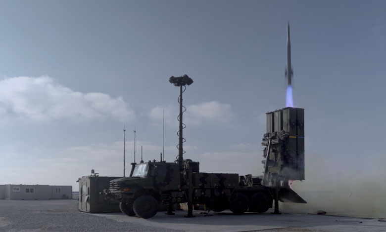

Guys what would you say? SİPER fuselage seems similar, doesn't it?
Are we going to create own MEADS?

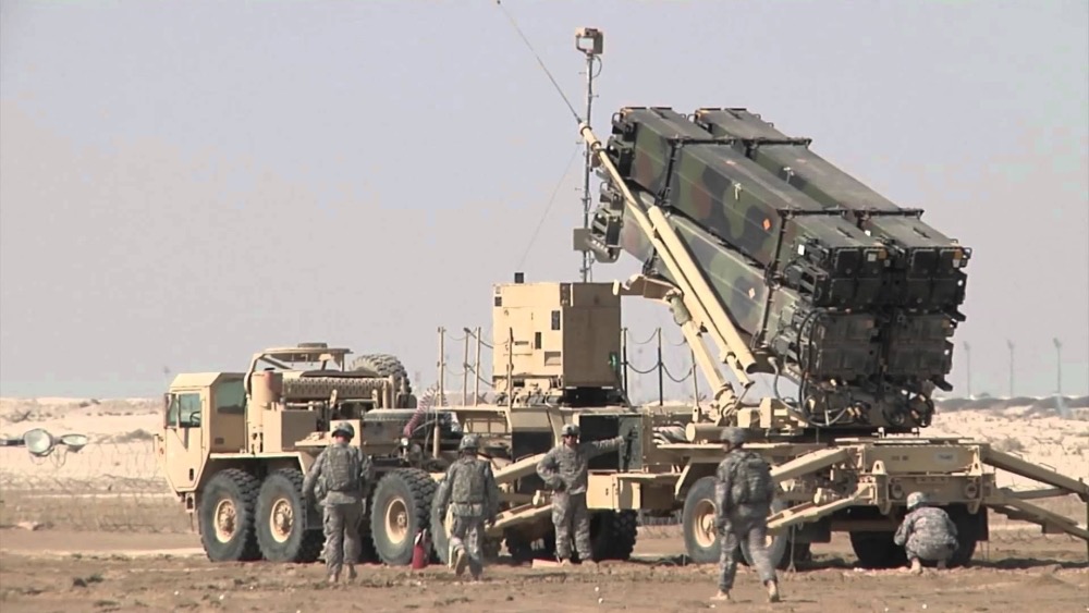

Lockheed Studies Sea-Launched Patriot PAC-3​
Lockheed Martin is studying several new air and missile defense systems, from an all-new six-foot rocket to a ship-launched version of the Patriot missile, a top executive told reporters here this morning. In keeping with the military’s emphasis on multi-domain operations that attack old problems from new angles, Lockheed is even looking at launching its Patriot PAC-3 MSE from an aircraft.
İ think we follow the same path. Good choice as PAC 3 has antiballistic capacity while antiballistic Standard Missiles (SM3)are very expensive.

There you go , quad packed PAC3 mse launchers;)
