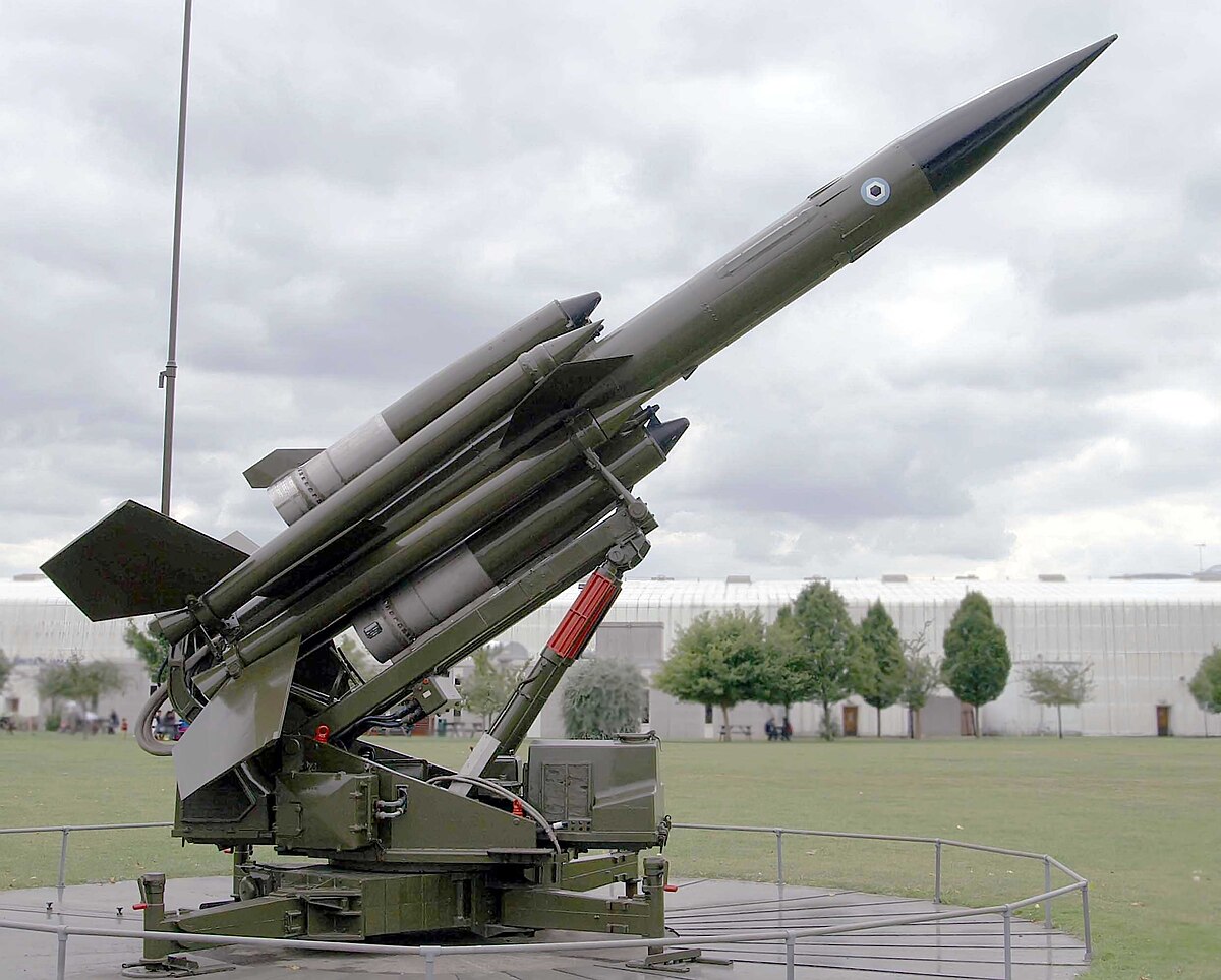

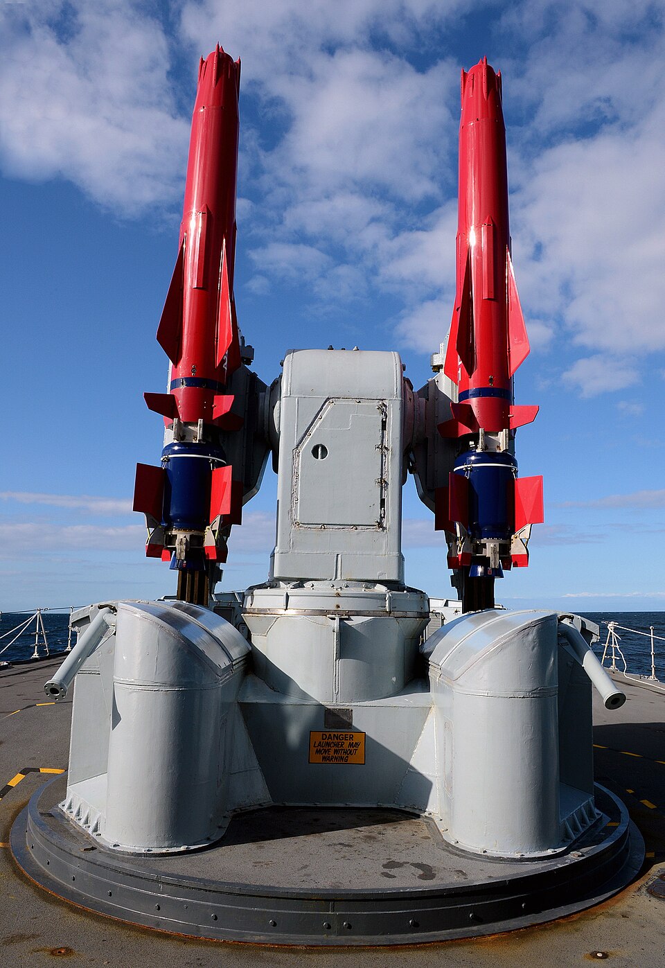

Could you please enlighten me ? If ramjet air to air missiles superior over solid fueled rocket a2a missiles, why today we don't have ramjet SAMs?
Why did UK and US Navy leave ramjet SAMs?
Today if we converted Göktan into SAM, What would be the pros and cons over rockets?
uçuyorum
1,132
15 1,799
Ramjets require an initial speed, thats why it's different for sam vs a2a. SAM are better of solid because ramjet also depends on air and would have difficulty with high altitudes.
To say they are superior is a subjective sentence.
To have a throttle control until it hits the target is a big advantage. But ramjets are costly. And they need to reach 1+ Mach before ramjet kicks in. A dual pulse long range a2a missile can do the same deed at half the cost. %ge kill rate may be lower than a ramjet version. But you can fire 2 per target.
Meteor costs best part of 4 million dollars.
Prior to Ukranian war the “sale” price of dual thrust engined, 160km range Amraam aim 120D was 1.8 million a piece to Japan. (To the US airforce it should be half that).
JATM Aim 260 with dual pulse motor and with a prospective range of more than 200km was expected to cost around 2.5 million dollars.
Also having an air breathing engine Ramjet’s flight limit starts around 30-32 Km altitude.
