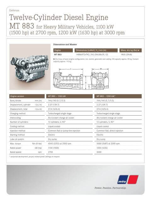

MTU 883 seems to give Maximum torque at higher RPMs.
No idea about Korean engine. Korean engine is said to have longer "Connecting Rot", so theoretically the Korean engine should produce more torque at lower RPMs.
Edit: i am puzzled
Korean engine at higher RPMs don't lose Torque as German one.
DV27K:
Peak torque rate is 4560N.M @ 2000rpm. It reaches 1479hp @ 2700rpm.

German engine is better. There are a lot of users of MTU engines around the world and everyone sings the praise of German MTU engines even the TAF. German engines have better power and torque to weight ratio and the powerpack is more compact and lighter than its competition. For us, the best engine is our engine.
2,975
62 5,319
Altay's Korean engine is "better"*( reliable) than German because it is heavier and engine has longer connecting Rot.
Being compact and light doesn't make an engine better!
Being compact and light just causes more troubles. I am hundred percent sure MTU has a crazy German complicated cooling system which must overcome overheating problems( another crazy German engineering)
I don't know what do you mean with "best power/torque ratio" but i shared above Korean engine outputs which is more consistent at high RPMs.
