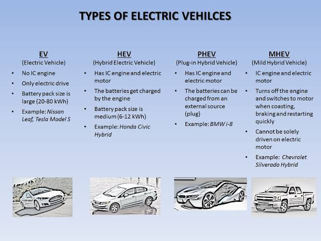

Now you are getting it.
You have a Diesel engine that is actually an electric generator. It develops electric current to drive the electric motors directly. But at the same time it also charges the batteries when needed. So both battery power and generator power can be used at the same time.
But you need powerful batteries to compansate less horsepower. Am i wrong? İt wouldnt cause Additional battery weight ? And it would limit the range.
Edit: if you want constantly generate an electric engine of 50 ton MBT without battery (or micro battery) , you will need min 1500hp Diesel/gasoline engine. If you use less powerful engine as generator, you will have to wait to charge.
There must be optimum battery endurance/ generator's HP ratio...
As @merzifonlu stated, these are “series-hybrid” electro diesel engines. They are not your run of the mill Diesel engines that power tractors or trucks. And there is fine balance between diesel power needed and the battery power needed.
For the Firtina howitzer, you wouldn’t need the diesel generation power to be too much. Because the howitzer’s movements will be quite different to a MBT‘s movements, it’s power needs (sudden power needs and continuous power needs) , the electro-diesel power to battery power ratios, will be different too.
So you may need a good deal of batteries for a MBT.. But Firtina howitzer weighs 56 tons. And with 1300HP electric power that weight is transported. So you increase the battery quantity and weight accordingly for the 70 ton MBT. But remember that you will have 1/6th of the fuel you would have in a diesel engined tank. And your generator will weigh a third of the weight of the Diesel engine. So you have already saved a lot of weight, which you could expend as batteries.

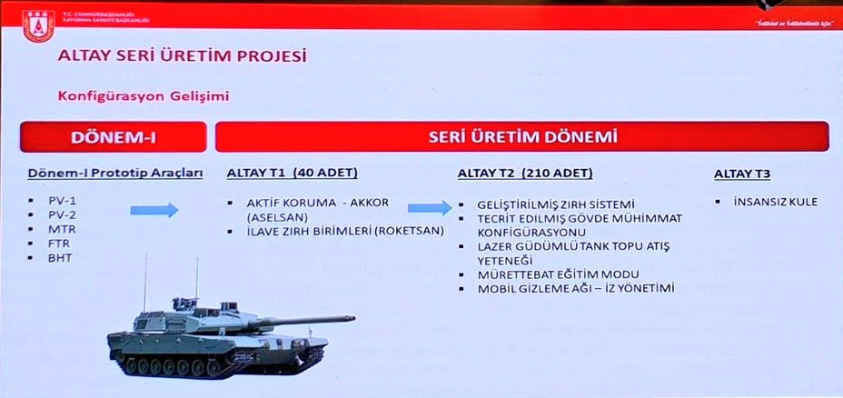

I Think most people have missed this Article from 22.06.2022
Muhsin Dere, Chairman of the Board of Directors of the Military Factory Operation Joint Stock Company (ASFAT AŞ) and Deputy Minister of National Defense:
Explaining that the search for the power group of the Altay tank continues, Dere said:
"BMC Power has started to work on domestic engine and transmission production, it continues, it has not been concluded yet. Apart from that, our Defense Industry Presidency is trying to buy power groups, engines and transmissions from Korea. We also have studies for the Storm howitzer and tank from the USA. But We do not have an engine and transmission at the moment. Therefore, this is the answer to the question "Why is there no tank?"
"By the way, we built and tested the second generation Altay tank in Arifiye with the spare power groups purchased from the Germans."
Now the question is what he means by 2nd Gen ALTAY.
It Could be the ALTAY T2 which would be massive news but rather uneventful announcement
This is what I mean by ALTAY T2

Also, seems like the tests of Korean powerpacks were successful as he stated that we are trying to get Powerpacks.
Tümosan might provide a version of its 540hp engine.

It is probably Altay T2 that is similar in performance to Leopard2A7.
