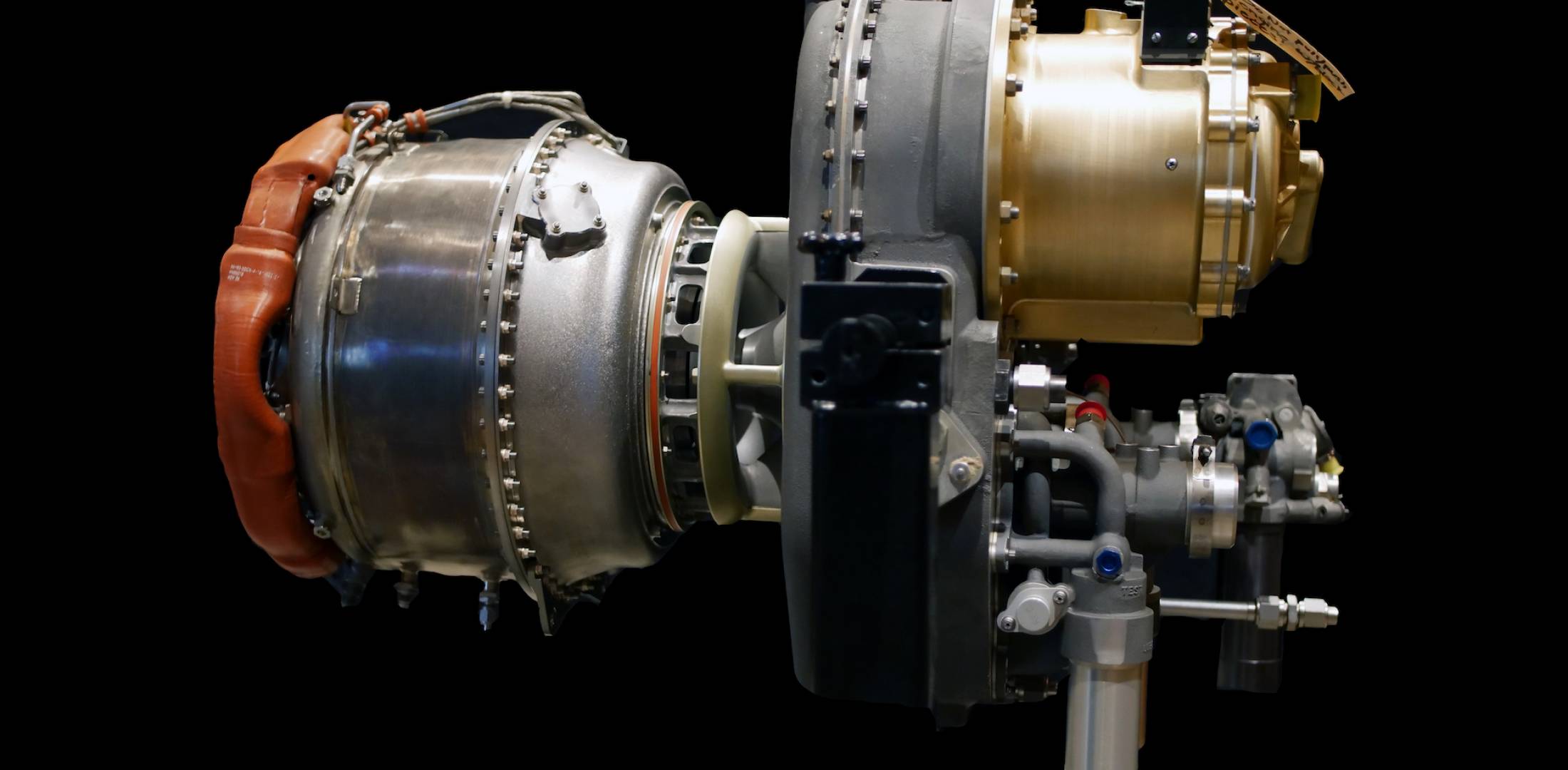

I think I need to make a correction here. TS-1400 turboshaft engine is 100% national with everything. This includes the gearbox. I personally heard it from my engineer friend at TEI.
Mahmut Akşit himself confirmed that the gearbox is ready.
""With the first shaft gearbox, we have reached the maximum continuous power cycle of our TS-1400. It is very important to achieve this in the first attempt with the gearbox produced for the first time. With the localized accessories in the TEI-TS1400 engine, we have reached the maximum output speed of 23 thousand rpm and the maximum continuous power of 1400 horsepower. "
