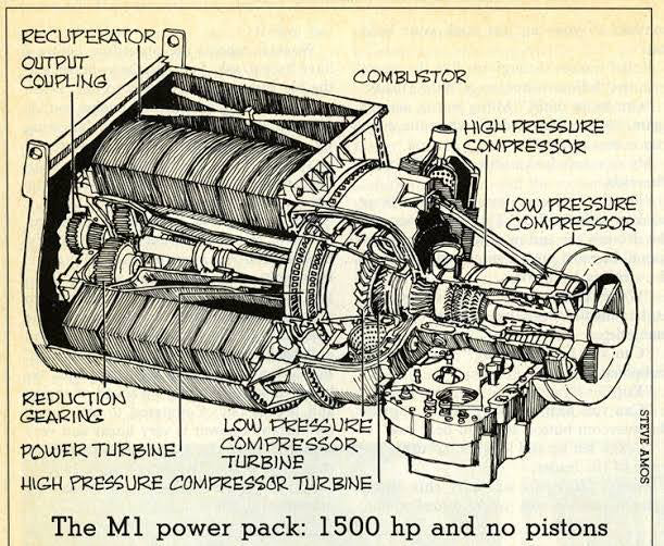

İ might seem repeating but Türkiye already has got powerful turboshaft engine TEI TS1400 for Helis.
Why not to transform those into powerpacks for ALTAY MBTs?
Why not to create Turkish version of M1abram or T-80?
Merzifonlu
820
30 2,511
I am answering you, but it will also be the answer to others. Our current problem is not in the power source (mean engine). The problem is in the transmission of that power. For this reason, I suggest a serial hybrid system that bypasses mechanical transmission.

Our problem is not the engine, it is the transmission.
That's why we are talking about diesel-electric hybrid systems, that were proven to work by MKEK in M113 and T-155 Fırtına
