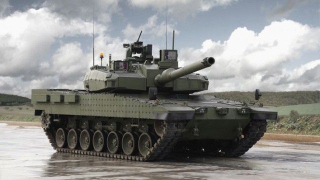

Altay was also developed as the main battle tank with heavy armor, but the K2 is a mobility tank for operation in mountainous terrain. South Korea was involved in the design and performance test of the composite armor of the Altay tank.
The Altay tank has thicker front/turret side armor than K2, and the accuracy rate should be higher than K2 when shooting a shell while stationary. The K2 turret side and the side armor are reduced due to the use of an autoloader. The Korean leadership is aware that the side armor of the K2 tank is weak, and started a program called K2 PIP.
In addition, a Korean ammunition producer in charge of designing Altay's composite armor and transferring bulletproof test technology tested the armor performance of Altay tanks with DM63, and DM63 failed to penetrate Altay's front armor and side turret armor.
Its many criteria when we compare tanks such as features like unmanned turrets, active protection systems, advanced electronics, gunfire detection, and advanced composite armor.
In reality, Korea only offered to sell the armor, thats why Turkey tried to gain the armor technology from 3 different direction, purchasing armor technology factory in England, then in Finland, and then nurol was able to make bor carbor armor that only US, Turkey and Israel is able to make. On the other hand, just recently, another Turkish company was able to make an armor based on Graphite, which is the only light armor could stand against 762/51 bullet with less than a kg weight on soldier. But disadvantage of it, it has liitle more size compare to bor carbor. Both of them offer at least 2 times less weight that others. The only problem with bor based armor is its little on expensive side, as Turkey started to put them on Turkish ships like ada and istanbul class. Comparing how important is Altay to Turkish people, im sure they will apply it there too.
