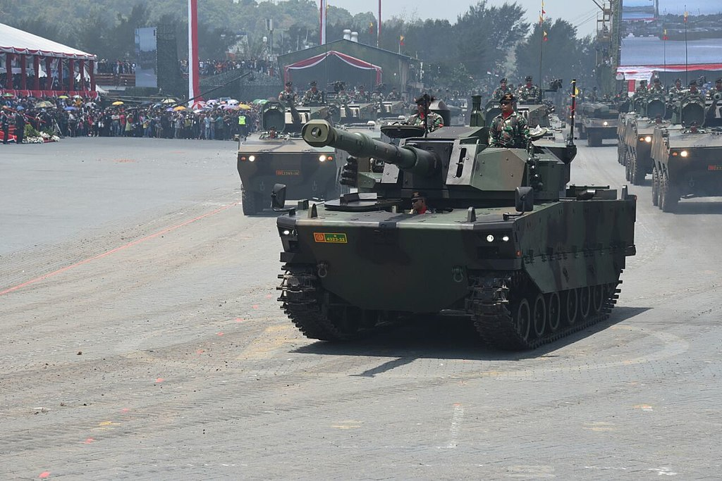

Indonesia has this one,
Kaplan MT / Harimau

As per RFE the weight should not exceed 25 tonnes with leverage of 10% , and Kaplam MT is 30-35 tonnes and I am not sure Pakistan will ever allow Turkey to collaborate with India .
The requirements literally suits the K21 and the experience with L&T gained from the manufacturing of the K-9s will come handy in the development of this tank. Glad due to this Russia -Ukrainian conflict we are not going to buy the sprut .
