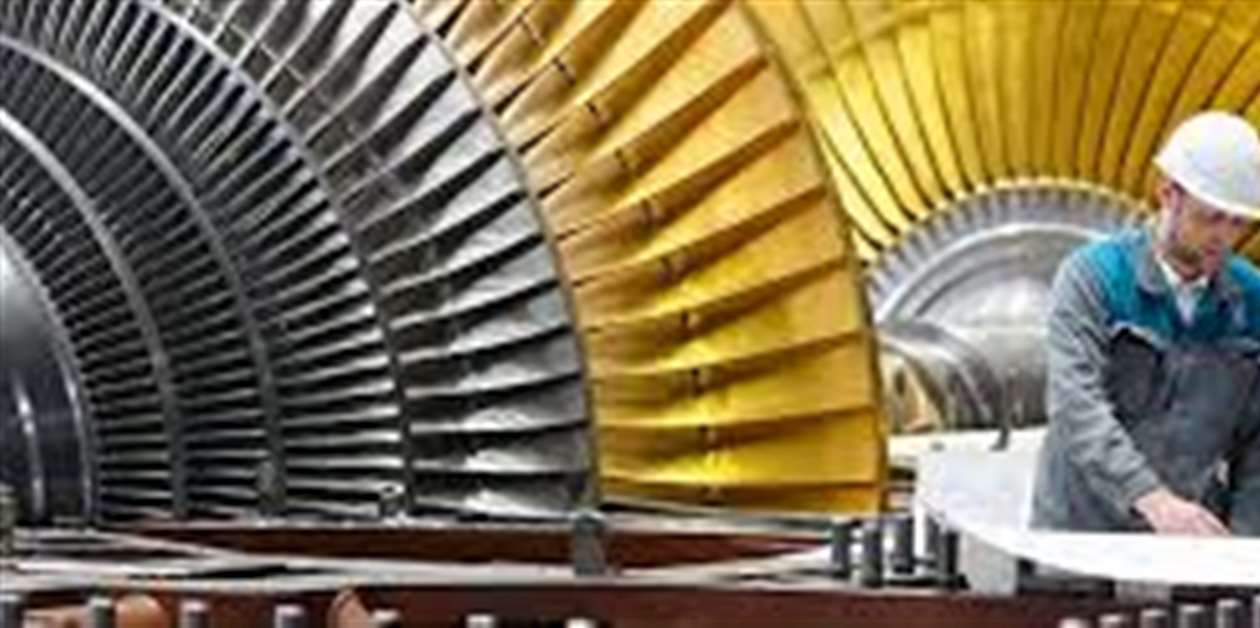

I explained in detail why they are not the same. Brayton cycle is the same that is it. That is why China is having real difficulty switching Soviet to western single crystal turbine blades. For example, Russian RD-33 and AL-31 use directionally solidified turbine blades while Turkish TS-1400 uses single crystal turbine blades.
Further read on turbine blades.
