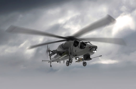

Atak II
•Maximum Take Off Weight: 12.000 kg
•Payload: 1.200 kg
•National TEI-TS3000 Engine
•Land and Marine variants
•First Flight: 18 March 2023
•Delivery: 2025
• Expected to carry 30mm cannon, AA missiles, ASW missiles and a laser weapon.
+Camo
+18 March (Naval victory day)
+The image was published above the sea surface,
It definitely will be navalized, maybe the first prototype will be directly developed as such.
