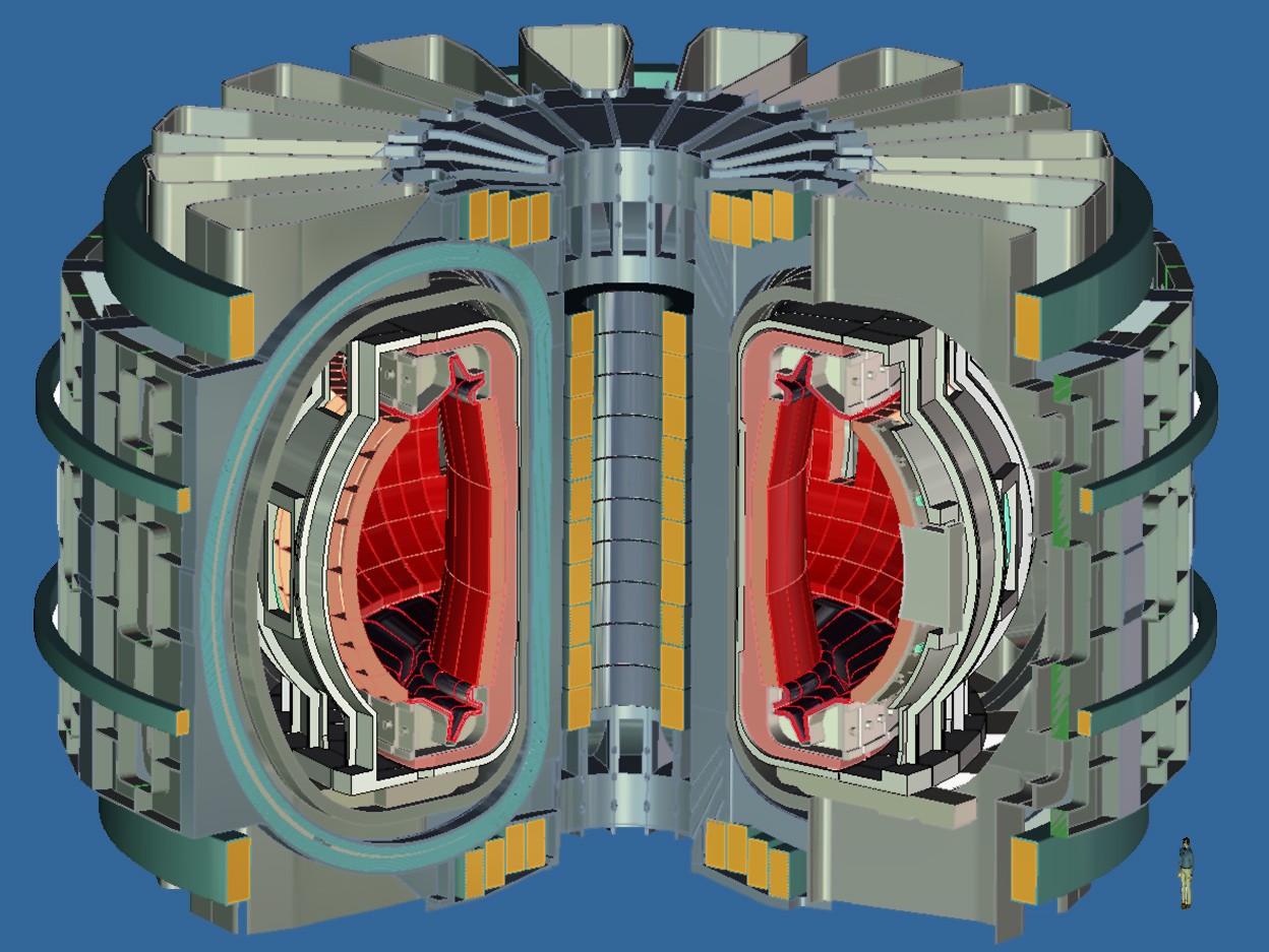

A lot of this has also been catalysed through India’s participation in ITER, which saw New Delhi emphasising domestic developmental work in the areas of magnet, divertor and cryopumping systems.
ITER-India​
India’s contribution to ITER, dubbed ‘ITER-India’ is being run as a special project under IPR. It was in December 2005 that India became the full seventh member of ITER with a 10 per cent ‘in-kind’ contribution share out of a total of 150 distinct procurements.
India’s Larsen & Toubro supplied the ITER’s cryostat, which is the world’s largest vacuum application stainless steel vessel. It weighs 3850 tonnes, with a height of 30m and a diameter of 30m. The cryostat was installed in 2020.
The ITER Cryostat, the largest fusion-containment structure in the world, manufactured by India's L&T​
ITER-India is also responsible for supplying a number of other critical components and sub-systems, such as cryolines and a cryodistribution system for ITER’s cryoplants; in-wall shielding, which requires around 9000 blocks from 70,000 precision cut plates; a cooling water and heat rejection system; ICRF source system; diagnostic neutral beam system to detect He ash during the D-T phase of the ITER plasma; plasma diagnostics; power supplies for DNB, ICRF and ECRF systems; two gyrotron sources of 1MW power output at 170GHz for 3600s pulse length; X-ray crystal spectroscopy; electron cyclotron emission as well as various optical fibers, detectors, visible spectrometers and opto-mechanical components.
Elements of the ITER complex's cooling system being installed. Pic credit: The ITER Orgnization​
Participation in ITER has led to significant blanket and divertor technology development initiatives in India. In particular, identification of special materials that provide long life and low induced radioactivity in the extreme environments associated with tokamak operations has been emphasized.

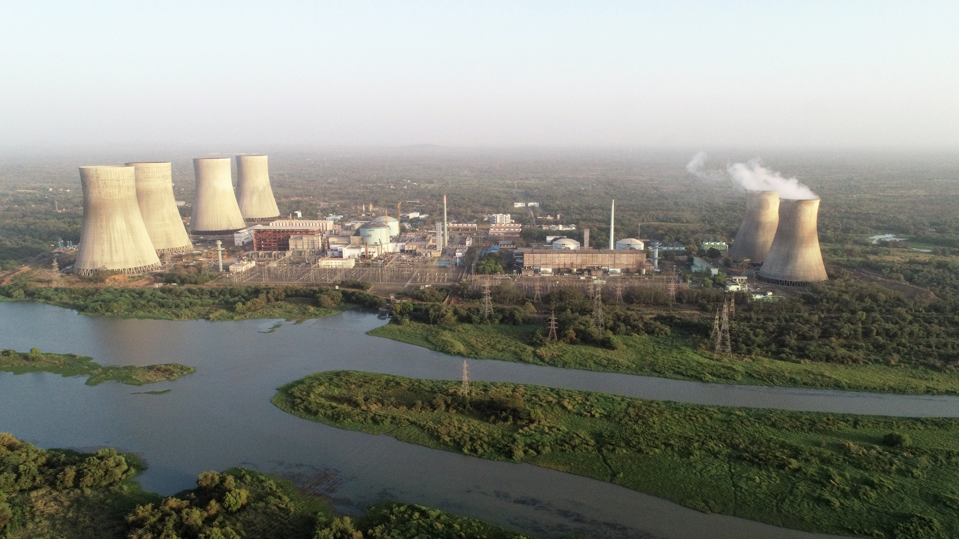

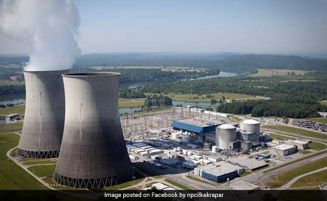

Kakrapar Atomic Power Station​
India's first indigenously developed 700 MW nuclear power reactor at the Kakrapar Atomic Power Project (KAPP) in Gujarat started commercial operations on Friday, a senior official said. "With great pleasure, this is to inform that our first indigenous 700 MWe Unit, KAPP-3, has become commercial on 30th June 2023 at 1000 Hrs," a senior KAPP official said.
Presently, the unit is operating at 90 per cent of its total power, he said.
The Nuclear Power Corporation of India Limited (NPCIL) is building two 700 MW pressurised heavy water reactors (PHWRs) at Kakrapar, which is also home to two 220 MW power plants.
Various commissioning activities were underway at KAPP 4, which had achieved 96.92 per cent progress by May end, according to officials.
KAPP 3 & 4 during construction phase, 2016​
The NPCIL plans to build sixteen 700 MW PHWRs across the country and has granted financial and administrative sanction for the same.
Construction of 700 MW nuclear power plants is underway at Rawatbhata in Rajasthan (RAPS 7 and 8) and at Gorakhpur in Haryana (GHAVP 1 and 2).
The government has sanctioned building of 10 indigenously developed PHWRs in fleet mode at four locations -- Gorakhpur in Haryana, Chutka in Madhya Pradesh, Mahi Banswara in Rajasthan and Kaiga in Karnataka.
The IPHWR-700 builds on the previous IPHWR-220 & 540 MWe models - of which 14 and 2 are in operation respectively.
