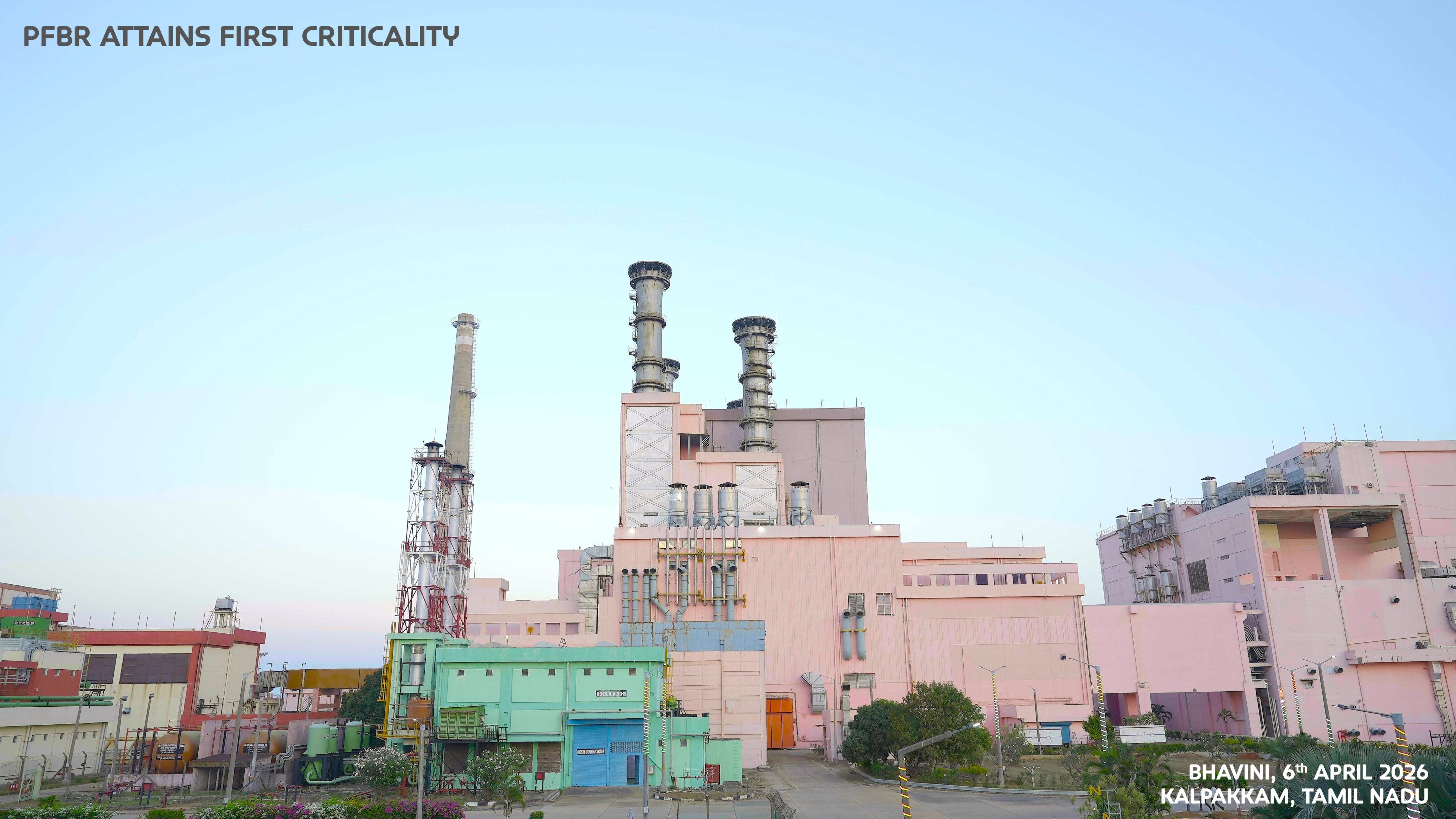

The 1st large one is the PFBR - prototype fast breeder reactor ( incorporating what is learned from the smaller two test reactors: KAMINI and FBTR).
Earlier last year they said it will achieve criticality around this month (March 2026) and start operations later in september this year
Maybe it is delayed somewhat further, we have to see.
This is the 2nd stage of 3 stage program, i.e producing comprehensive steady amount of U-233 from Th-232.
The 3rd stage will be the AHWR (advanced heavy water) reactor, that will be constructed later pending what is learned from producing U-233 in the PFBR. That's the one that will actually use the surplus U-233 produced by the PFBR.

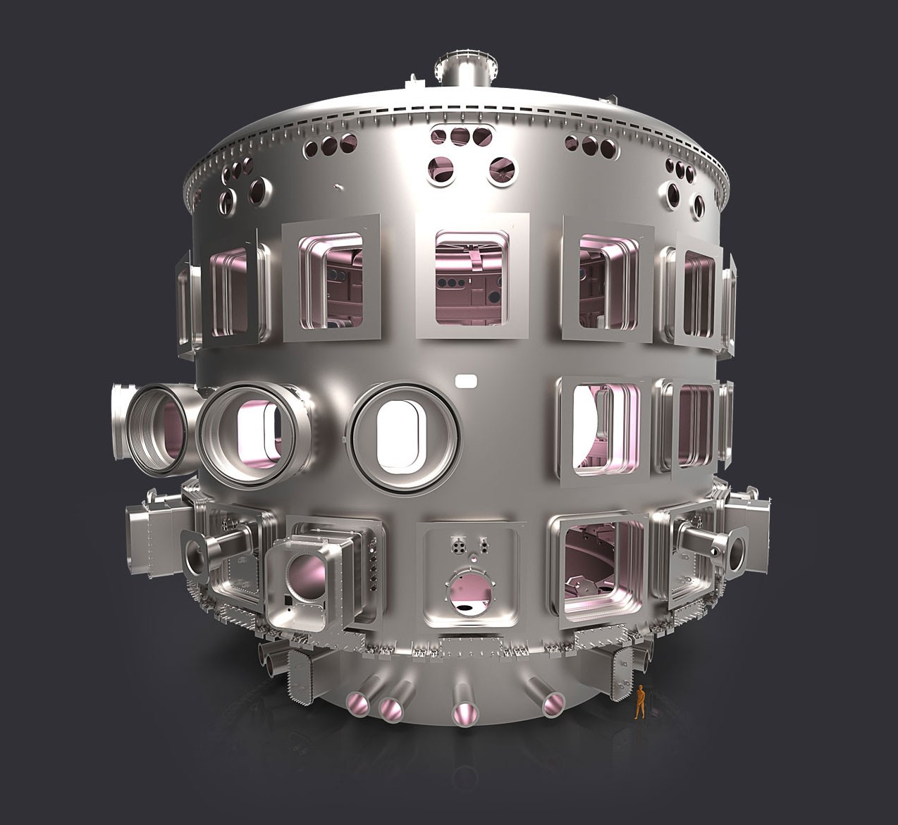

With this, there are now 3 tokamaks active in India:
Refer to this post going over the other 2 already operational ones, namely Aditya-U (originally from 80s but later upgraded) and the larger SST-1:

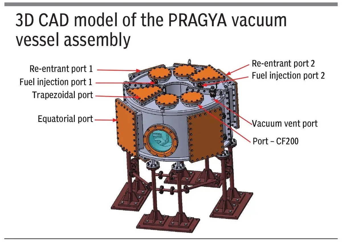

Bangalore-based start up Pranos Fusion has received ~$7 Mn in PE capital, they expect that their PRAGYA (medium-scale testing tokamak) prototype is now funded. Once it's commissioned, it would only be the 4th tokamak in the country, and the first privately-built one!

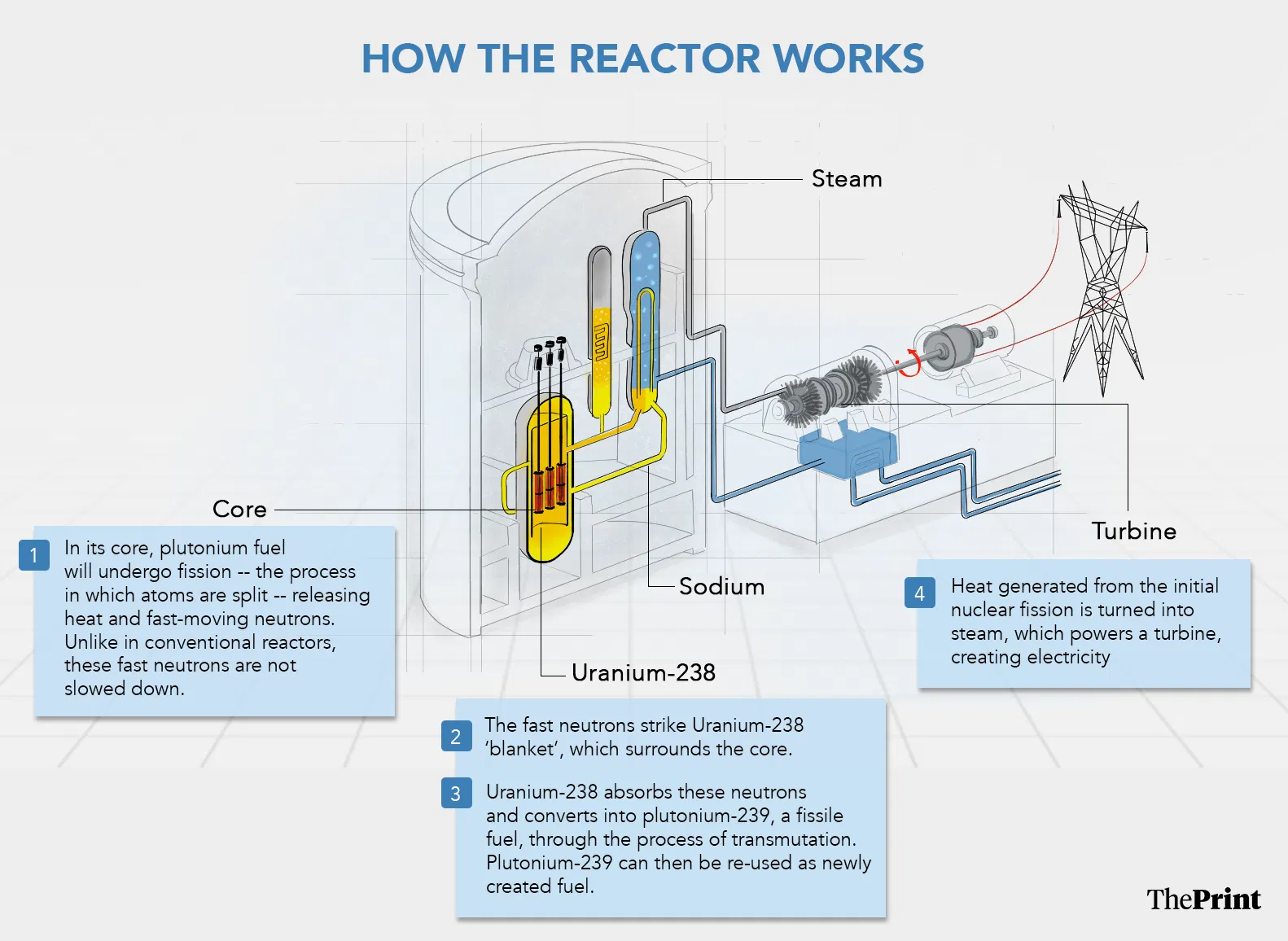

By the way, the fact that PFBR remains entirely outside IAEA safeguards represents a theoretical increase in our production of weapons-grade plutonium from the current ~25 kg/year (Dhruva only, now that CIRUS is shut down...not counting any theoretical civilian reactors' contribution) to about ~170 kg/year.

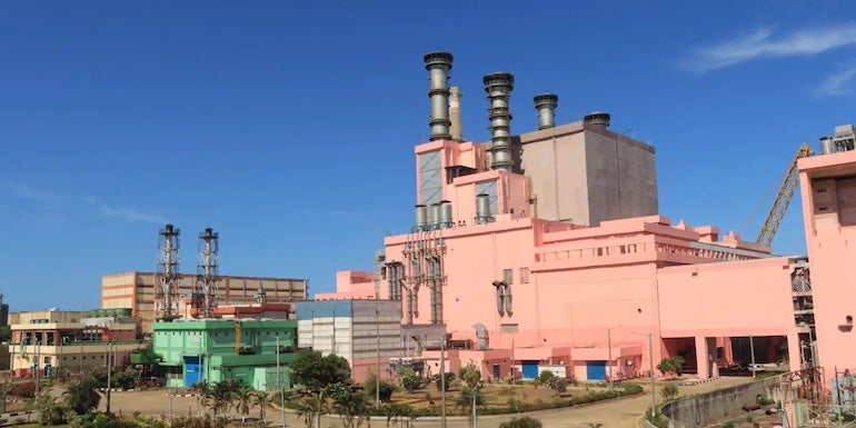

A short summary of some of the technical challenges that went into PFBR's development, part of a larger article by Nuclear Engineering International (NEI):
"...Developing the PFBR was not an easy task. Construction of the PFBR began in 2004 and was originally scheduled to be completed in 2010. The project was delayed by approximately 16 years due to a combination of technical, financial, and external challenges. The 2004 Indian Ocean tsunami that struck the Kalpakkam site shortly after construction began required a re-evaluation of safety features and protective structures. Repeated delays caused the project cost to more than double, rising from an original estimate of about INR 35bn ($375m) to approximately INR77bn.
India’s PFBR is a pool-type reactor. In this design, the entire primary circuit (the core, pumps, and intermediate heat exchangers) is housed inside a single massive stainless steel main vessel filled with liquid sodium. Fabricating a vessel of that size (nearly 13 metres wide) to hold 1,150 tonnes of sodium at high temperatures while ensuring it could withstand seismic activity was a massive hurdle for Indian industry.
Because of India’s historical position outside the Nuclear Non-Proliferation Treaty (NPT), there was very little sharing of technical “know-how” from Russia or the West for the PFBR. India’s exclusion from the NPT also led to international trade bans, making it difficult to procure high-end nuclear components and technology.
India had to develop its own materials, such as specific grades of stainless steel (316LN) that could survive 40 years of sodium exposure without corroding or becoming brittle. Every component – from the sodium pumps to the steam generators – had to be designed and manufactured by Indian companies (such as L&T and BHEL) for the first time. India also had to integrated post-Fukushima safety requirements into a breeder design.
Handling liquid sodium is extremely complex as it reacts violently with air and water. Significant setbacks occurred during the commissioning of sodium pumps and secondary cooling systems. There were also persistent difficulties in producing the mixed oxide (mox) fuel elements required for the core.
Despite these difficulties, India’s nuclear programme is progressing. Currently India has a fleet of 18-20 pressurised heavy water reactors (PHWRs) that use natural uranium as fuel and produce plutonium-239 (Pu-239) as a by-product in used fuel – the first stage of the programme. With criticality of the PFBR it is now embarking on stage two."
As a side-note: L&T, the Indian company responsible for manufacturing the PFBR's critical pressure vessel (and also the PVs for India's IPHWRs) is the same company that's responsible for making the nearly 4,000-ton cryostat pressure vessel that contains the ITER experimental fusion reactor, which is also the largest high-vacuum pressure chamber ever built, anywhere in the world.

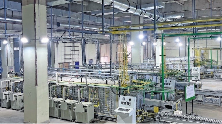

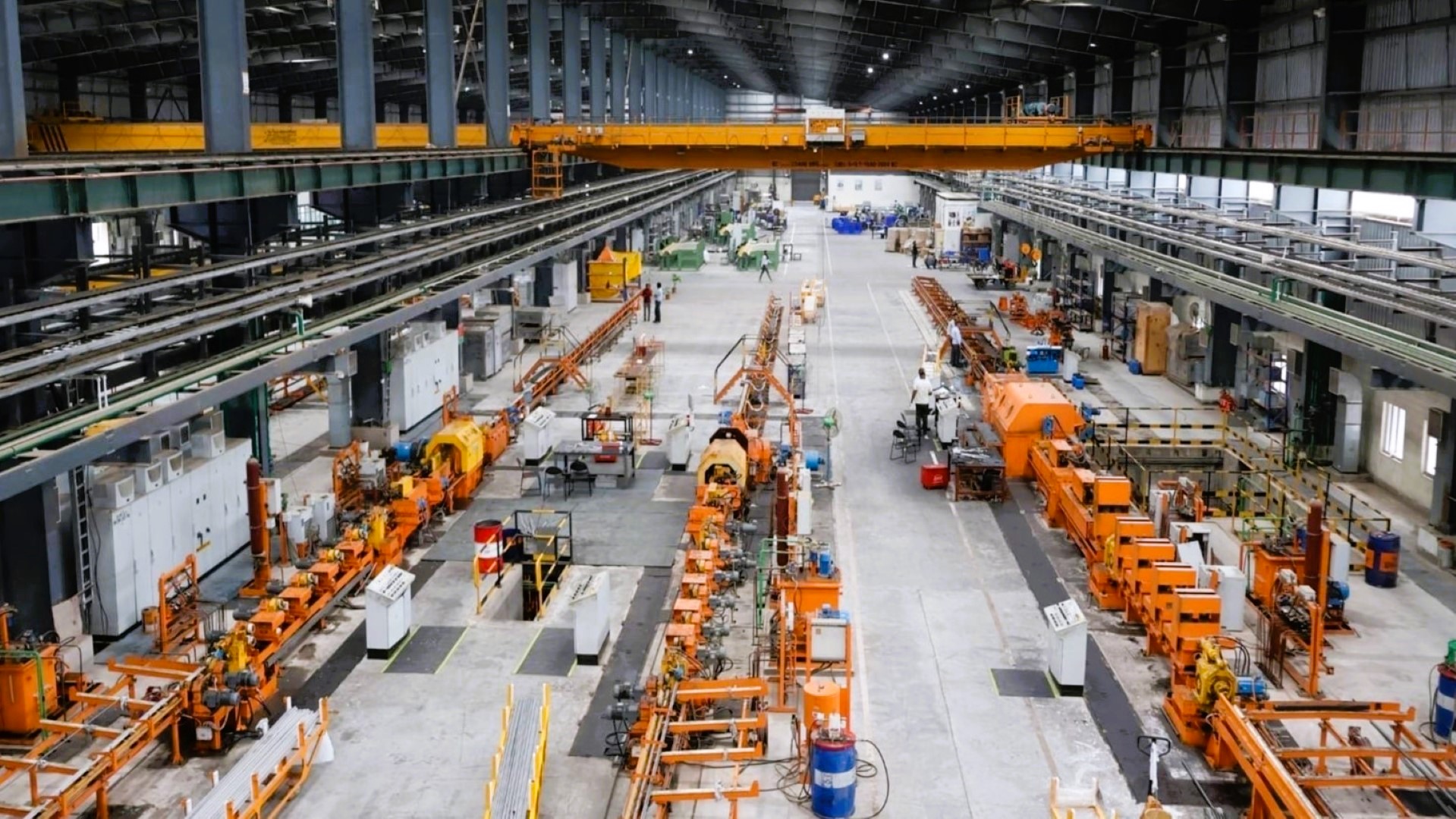

India licences NFC-Kota fuel plant​
The Rajasthan facility will produce 500 tonnes a year of natural uranium dioxide fuel assemblies, with approval valid until 30 April 2031.
May 6, 2026
India’s Atomic Energy Regulatory Board (AERB) has granted an operating licence to the Nuclear Fuel Complex-Kota (NFC-Kota), which will provide fuel for 700 MWe pressurised heavy water reactors (PHWRs). The facility in Rajasthan’s Rawatbhata has a licensed annual capacity of 500 tonnes of natural uranium dioxide (UO2) fuel assemblies.
The licence was granted after AERB conducted a detailed safety assessment under its regulatory framework. “The activities at NFC-Kota are of low hazard category. The systems required for radioactive waste management and prevention of spread of contamination during operation are available,” AERB noted. “The application, the subsequent submissions and the review carried out have shown that the associated safety aspects have been adequately addressed.”
The licence is non-transferable and subject to modification, suspension, or revocation, as considered necessary by the AERB. It includes conditions such as adherence to reporting of safety-significant events and submission of periodic health physics reports.
The Nuclear Fuel Complex (NFC) headquarters in Hyderabad submitted its application for an operating licence for the Kota facility in March 2026. The authorisation also covers the safe handling, disposal, and transfer of radioactive waste, and is valid until 30 April 2031. The approval follows the Consent for Hot Commissioning issued in November 2025 after NFC-Kota’s satisfactory demonstration of fuel bundle assembly production in April 2023.
The Department of Atomic Energy (DAE) said operational clearance for NFC-Kota “marks a decisive step in strengthening the nation’s nuclear fuel cycle”, meaning NFC is now “fully geared” to supply nuclear fuel for Nuclear Power Corporation of India Ltd’s 700 MWe indigenous PHWRs.
India is constructing 10 indigenous 700 MWe PHWRs in “fleet mode” to boost nuclear capacity. These include: the Kaiga Atomic Power Project (KAPP-5&6) in Karnataka; Gorakhpur Haryana Anu Vidyut Pariyojana (GHAVP-3&4) in Haryana; Chutka Madhya Pradesh Atomic Power Project (CMPAPP-1&2) in Madhya Pradesh; and Mahi Banswara Rajasthan Atomic Power Project (MBRAPP-1-4) in Rajasthan. The 700 MWe PHWRs already in operation include units 3&4 at the Kakrapar Atomic Power Station (KAPS-3&4) and unit 7 at the Rajasthan Atomic Power Station (RAPS-7) where RAPS-8 is undergoing commissioning.
NFC was established in late 1960s as a pivotal industrial arm of the Department of Atomic Energy with the mandate to fuel India’s nuclear power programme. It is the only facility worldwide to have a comprehensive manufacturing cycle from ore to core, involving processing of both uranium and zirconium streams under the same roof. NFC manufactures assemblies for existing PHWRs (mostly 200 MWe), boiling water reactors (BWRs) and fast breeder reactors as well as many reactor core components, various tubes, and high purity special materials.
It has developed state-of-art facilities and process technologies with several innovations in the field of nuclear fuel production and fabrication. The complex also symbolises the strong emphasis on self-reliance in the Indian nuclear power programme.

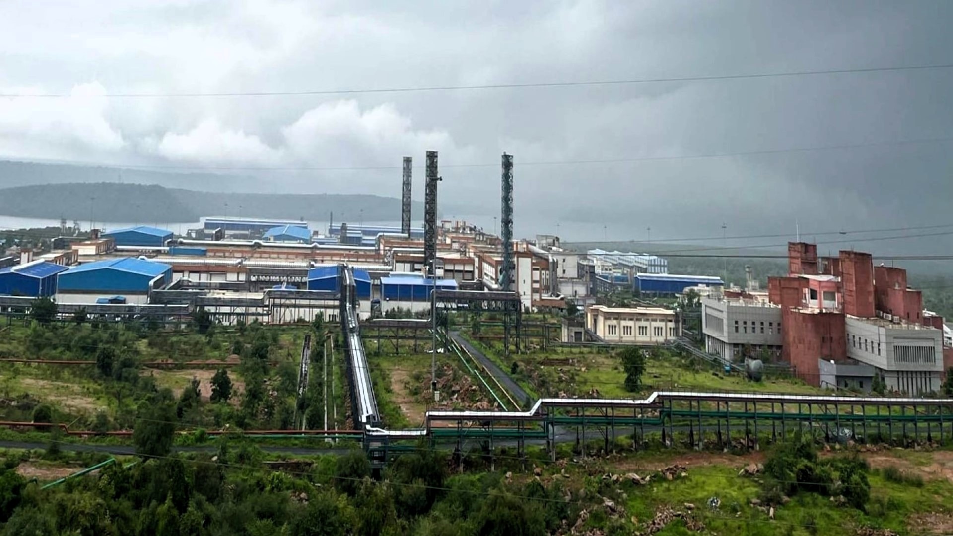

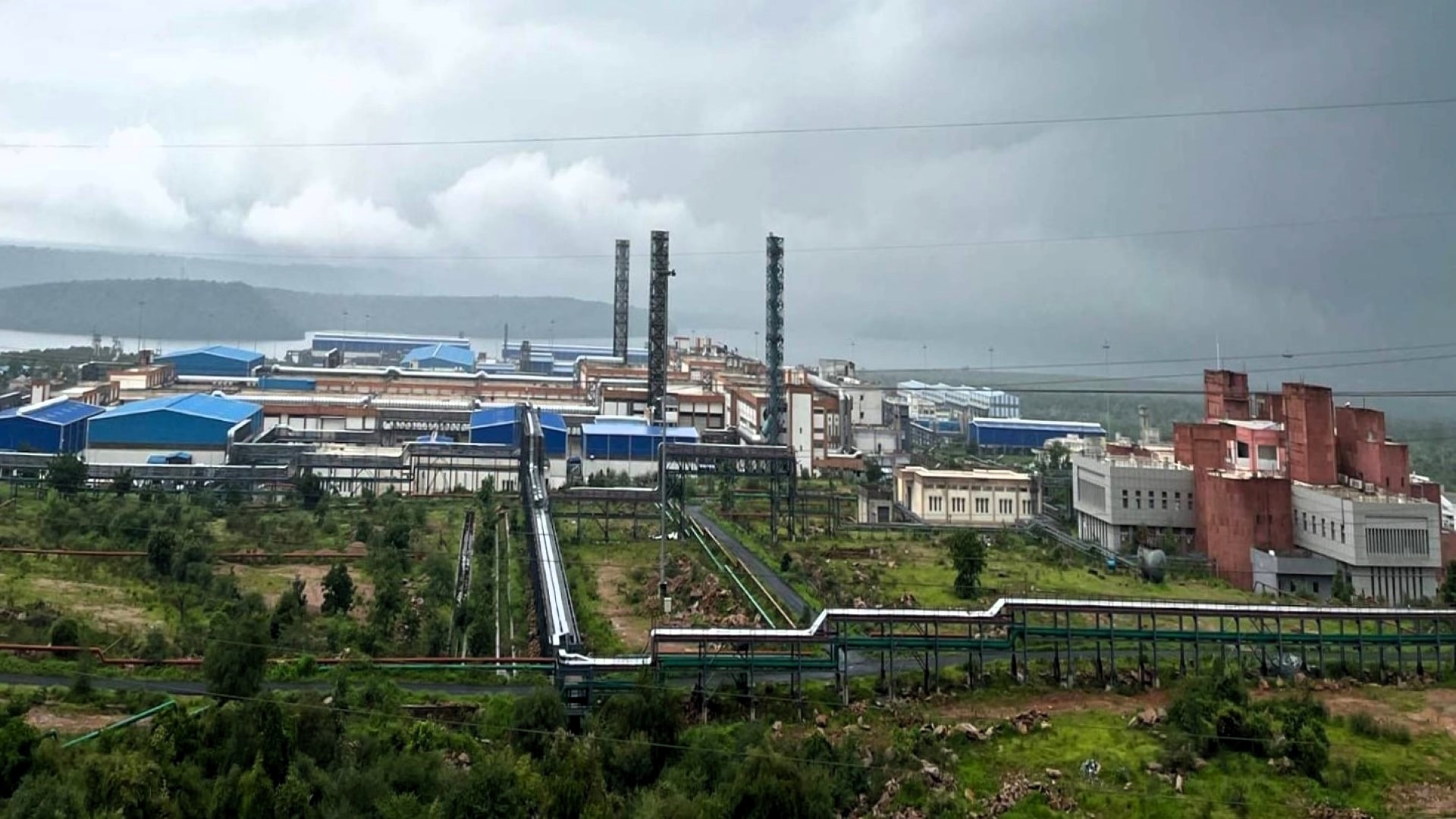

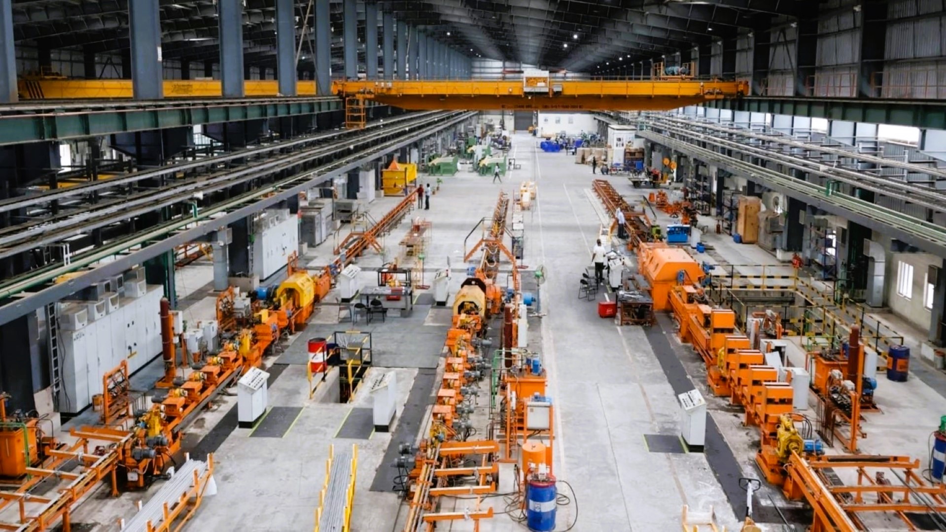

View attachment 80488​
May 6, 2026

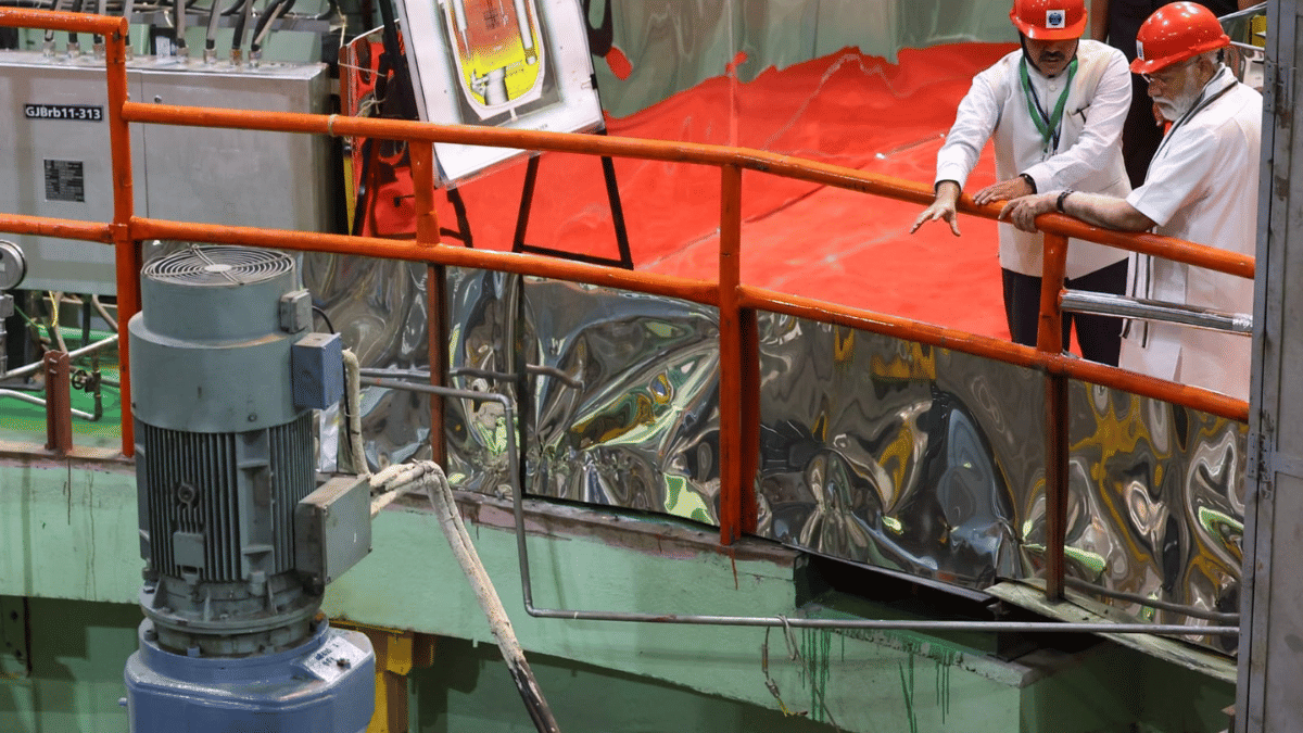

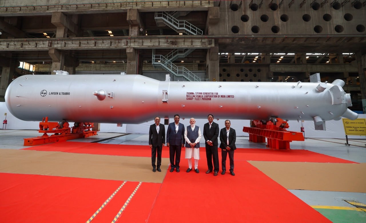

What you see behind PM Modi is a 700 MW nuclear steam generator, indigenously manufactured in India. Only a handful of countries can manufacture these at scale. For a nuclear engineer, this photograph is actually more impressive than most missile or aircraft photos. It represents industrial capability at its finest.
^^ This seems to be among the first steam generators produced for the IPHWR-700's fleet-mode deployment program. India (thanks to L&T and BHEL) is one among 7 countries globally where large-capacity nuclear steam generators like these are produced at an industrial scale.
