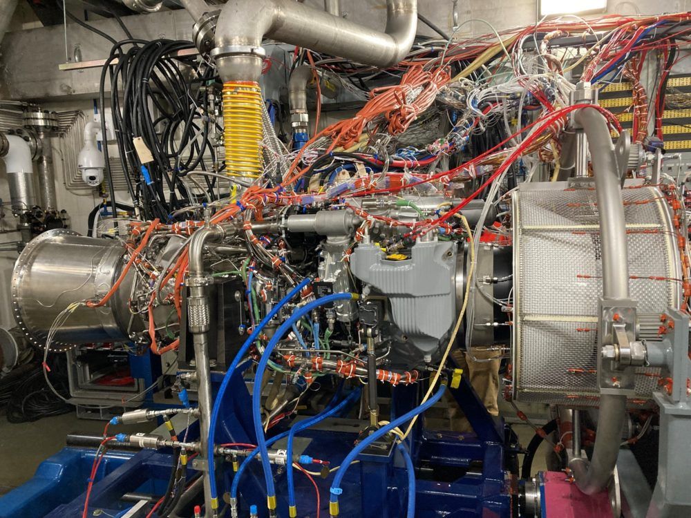

GE has upgraded three test cells at its Lynn, Massachusetts facility to test the more powerful T901 rotorcraft engine (Image: GE Aviation)

The first engine to test milestone is being performed in a recently upgraded test cell at GE’s Lynn, Massachusetts facility. GE has upgraded three test cells in Lynn to efficiently complete the T901 engine test program.
The test cell upgrades include systems capable of absorbing the increased power and allow no-load operation of the engine, improved instrumentation capability, and upgraded test controls.

Testing of the first engine is the start of a multi-year test campaign to reach full Army qualification. During the remainder of testing for the first engine, the integrated test team will perform a number of simulated flight conditions to collect performance data of the highly instrumented test engine.
