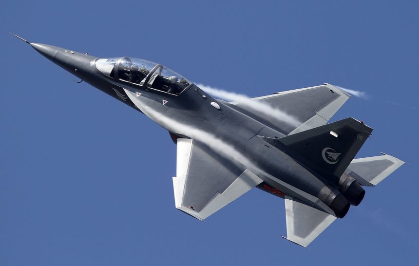

L15-B uses two AI-222-25F engines with afterburner
Engine like the AI-9500F could be used for Hürjet and other jet aircraft including drones in the future.
These are 9000lbf thrust range engines. You need two of these to power Hurjet. Hurjet’s design has been consolidated to a single engine design. From eastern block only the Klimov RD93 engine (18200lbf) could be a contender.

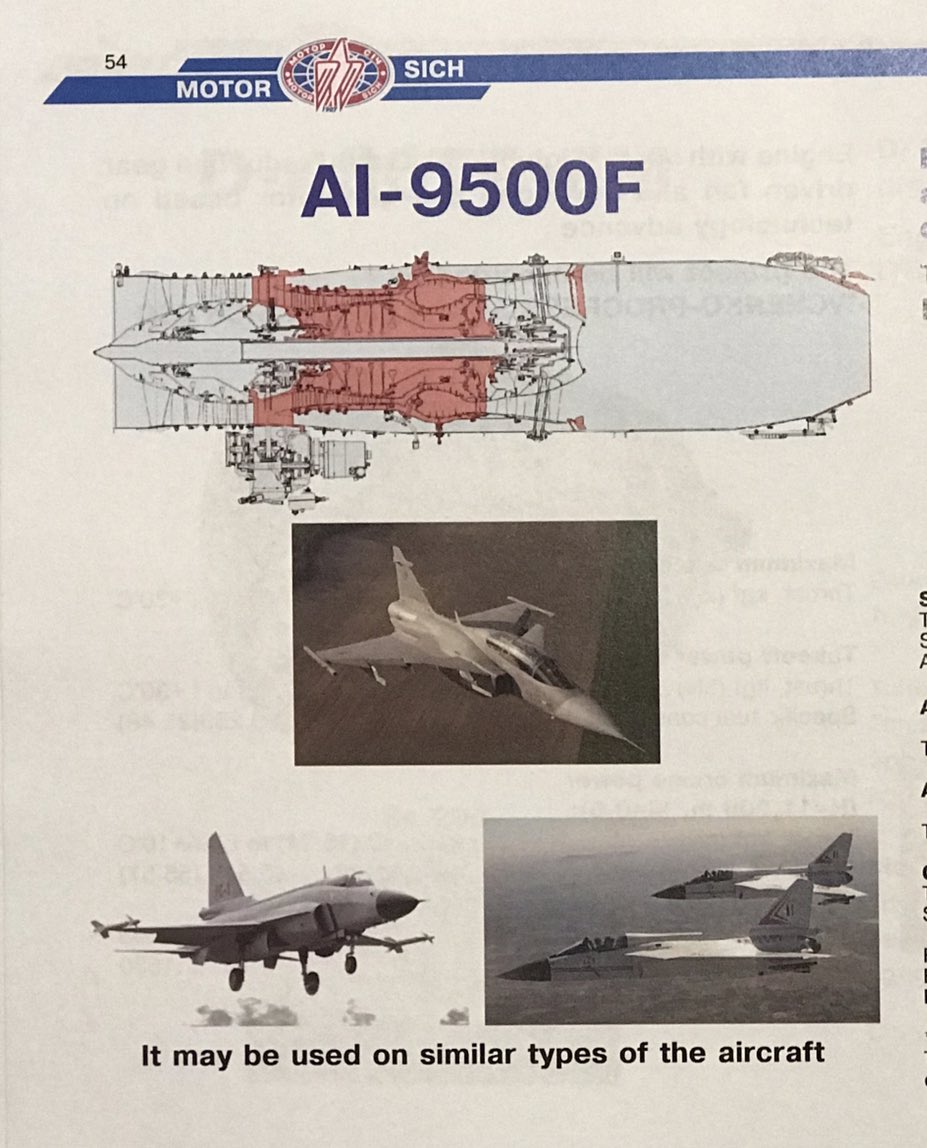

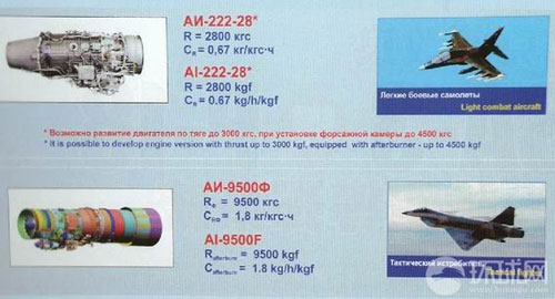

It was offered to China, AI-9500F is said to produce 9 to 11 ton thrust. Motor Sich said that they "could" make a 15 ton thrust engine based of AI-9500F.
4,305
274 22,501
Motor-Sich is the engine manufacturer (sort of our TEI without development arm).
Ivchenko-Progress is the engine designer (similar to what Tr Motor is trying to do)
Since the collapse of Soviets, Motor Sich only produced what was already in their knowledge library. Nothing new has been added.
Ivchenko Progress has not really developed something new either.
They have lost most of their innovative workforce. So really not developing anything!
AI9500F is an engine in only Ivchenko Progress’s new engine development program. No physical engine! And I doubt very much if it will ever materialise either. If you check Motor Sich site you will not find this engine.
quote:
The company also is continuing research on a new engine that builds on the design methods employed in developing the AI-222-25, but this will have a 21,000-pound-thrust rating.
The engine, which is still a design and not yet in prototype development, is the AI-9500F and has been in the design stage for years. Ivchenko describe the engine as being a candidate for a “lightweight tactical fighter” program, but no specific design or customer nation has been designated. The engine would be close to the thrust rating needed by China for its Shenyang FC-31 fighter that appears to be an analog to the Lockheed Martin F-35, but there have been no reports of the Chinese being willing to finance putting the engine into production.
unquote
