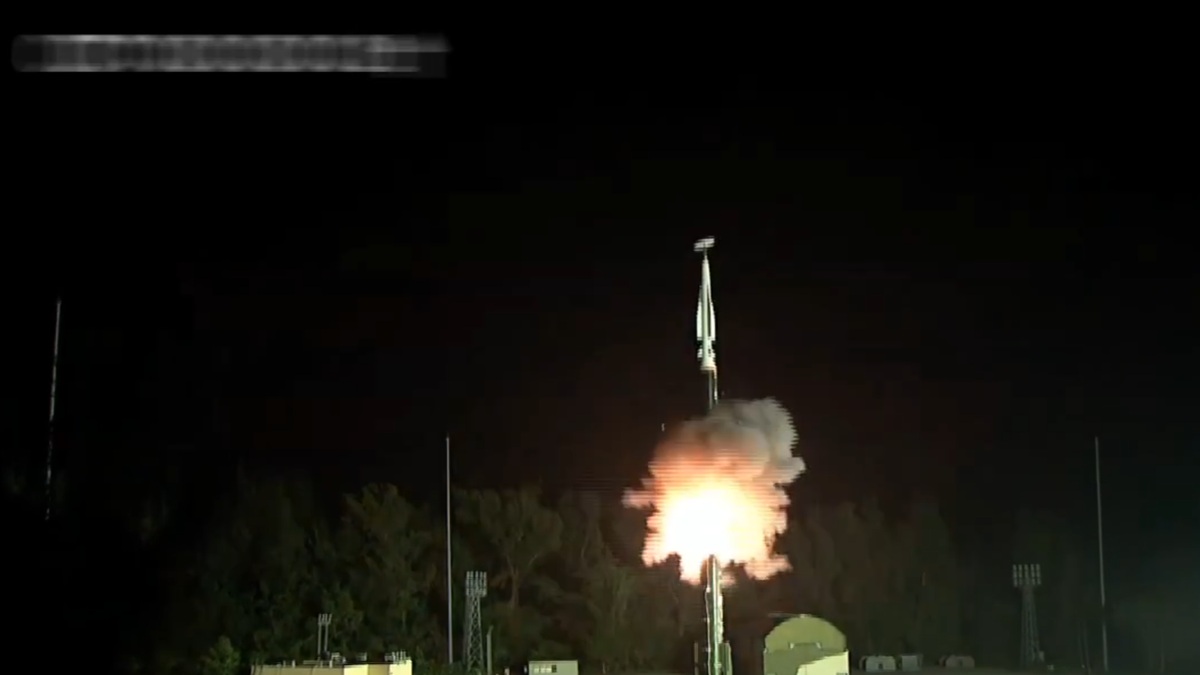

There was always rumors that we had tested HGV sometime ago.
Nope, that's a very very depressed trajectory to reach its range at 5000-Km. Otherwise it would add few thousand Kilometers easily and hence the weird thing in the sky. Everyone knows it can reach 8000-Km and MoD would always like to downplay its range not to irk "Garden People".
Garuda
79
7 191

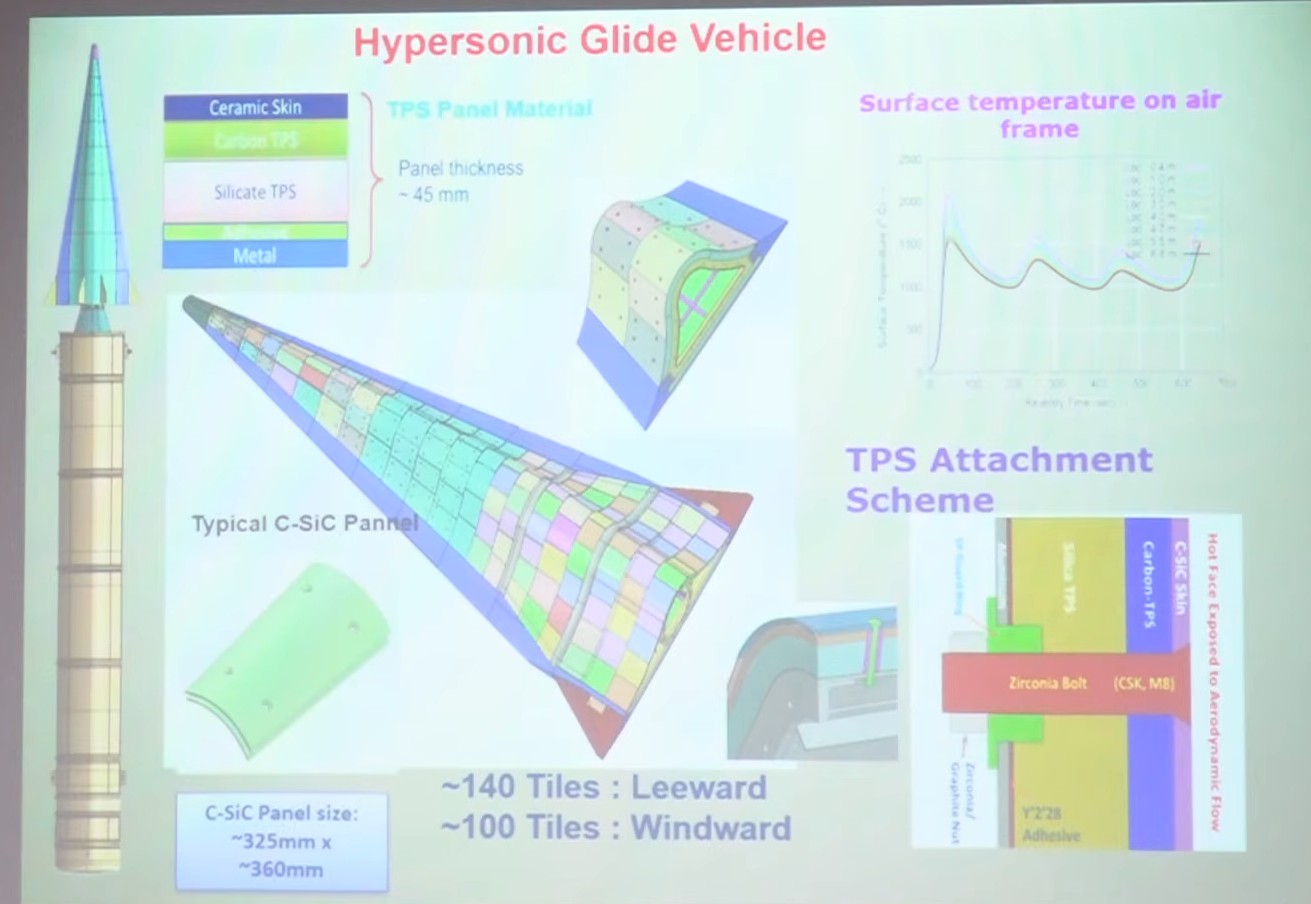

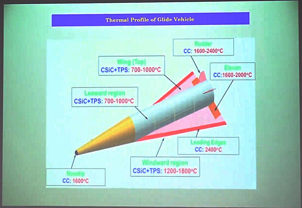

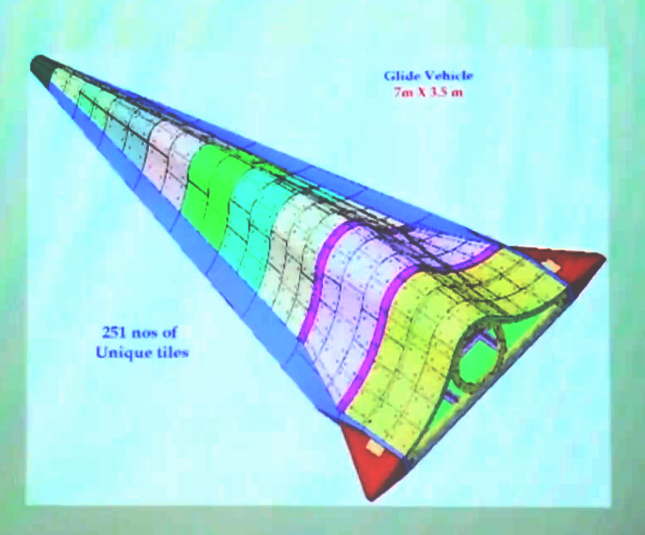

There's various kinds of lifting bodies you can go for, all have a tradeoff to be made.
There are also other HGV bodies in the works as previously shown in some slides:
What they're likely to settle on would depend on a bunch of factors including manufacturing cost. There might even be different HGVs sitting on the booster depending on use-case. The press release does not mention any service in specific and says "Armed Forces" so there are likely to be several versions.

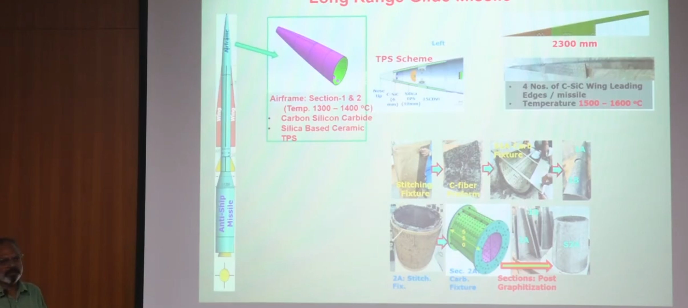

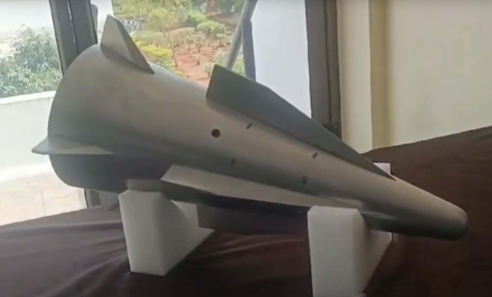

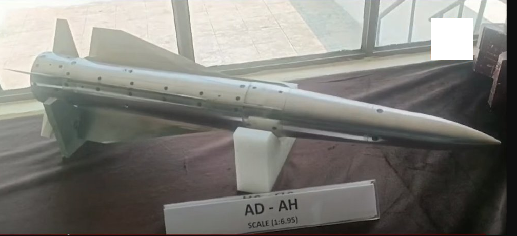

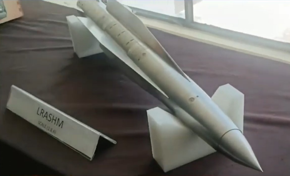

LRAShM:
Air Defence - Anti Hypersonic (a possible variation of the KV that goes on the AD-2 BMD SAM meant to defeat enemy HCM/HGVs. DACS thrusters on nose are clearly visible):
Unknown HGV...looks like a variation of the Agni-1P's RV with addition of forward fins:
DRDO is for sure putting their new Hypersonic Wind Tunnel to good use!
@Nilgiri
11,096
153 22,675
LRAShM:
@Nilgiri
Excellent finds. This is great to see.
