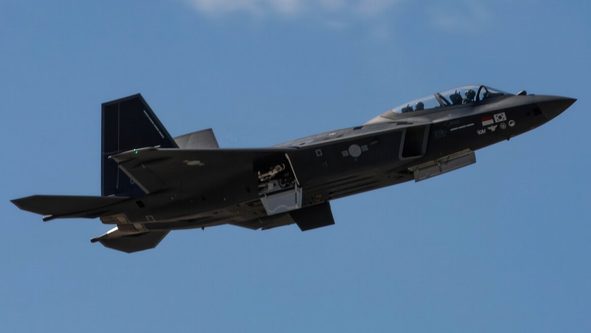

"KF-21 Prototype Unit 4 with a golden arrow pattern on a black background. KAI plans to choose the one that looks the most inconspicuous and cool in the air after different base paints and patterns for each prototype."
KF-21 Prototype Unit 3:
Not necessarily related to TNI AU, but okay...
KF21 is surprisingly bigger than F35, but why has less internal fuel?
"The KF-21 is also equipped with functions such as automatic posture recovery, automatic terrain tracking, automatic terrain collision avoidance, and automatic steering."
Auto GCAS?

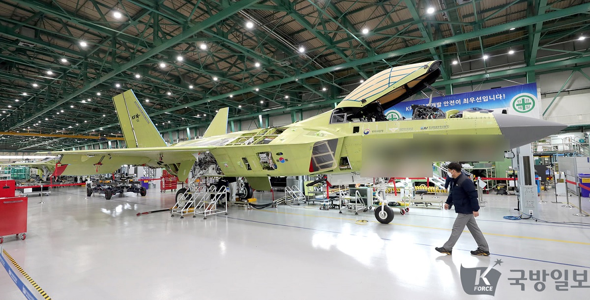

How may prototype Korean build?
Is it possible ours already on this queue?

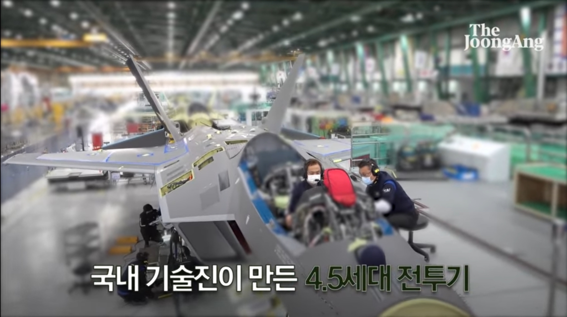

Cmiiw i once read an article and if i'm not mistaken its would be 6 prototypes. Indonesia to get 1 prototype.

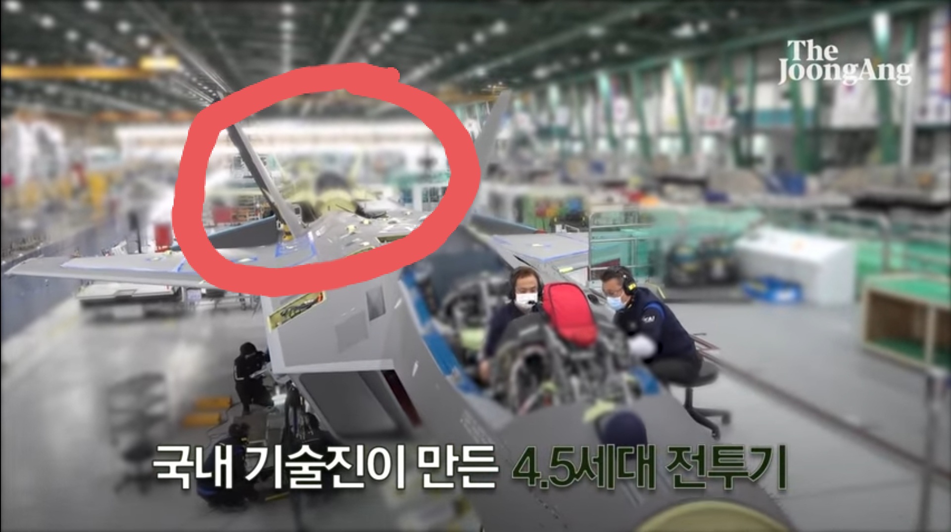

If you look carefully from the blurry pic there are unpainted KF-21 Boramaes being constructed in the background. It could be Prototype Unit 5 & Unit 6.
As of now, 8 prototype aircraft are being assembled simultaneously and four of them are already in late or final stages. 6 will be used for flight testing while 2 will be used for ground testing. 2 prototypes will be two-seater variants.
So we get the 9th one.
I see.
F-35 has much higher MTOW and thus much larger mass-range (MTOW - empty weight) to play with.
i.e F35-A:
MTOW = 31.7 tons
Empty weight = 13.3 tons
Fuel capacity = 8.3 tons
Don't let the raw volumetric size of aircrafts fool you.
About 45% of that range is max internal fuel
i.e 8.3/ (31.7 - 13.3) = 0.45
KF-21 fuel ratio/mass range:
Prototype around 30%, and gets bumped up to about 40% in production.
Conventional (4th gen) fighters have this % around 30 - 33% typically.
Other 5th gen fighters (like F-35) tend to have it around 45%*.
It comes intrinsically somewhat with incorporating internal weapon bay on fuselage and RCS blended planform for stealth at same time.
i.e naturally leads to a higher cross-coefficient for fuel capacity compared to conventional fuselage (and external hardpoints only) found in 4th gen and earlier
KF-21 by blending 4th and 5th gen....has RCS-reduction planform but no internal weapon bay...thus comes up around 40% max fuel fraction (of total buffer) for its current production block series. i.e somewhere between the two.
Likely bumps up to closer to 45% in subsequent blocks that go for internal weapon bay and shift to 5th gen design philosophy etc.
*J-20 which is really more 5th gen fighter-bomber gets it to 60% even... given its beefy + long fuselage (21 m long) from the large weapons bay + range req. etc.

So in Layman's term?
In a clean configuration and full of fuel internally, who got more range?
