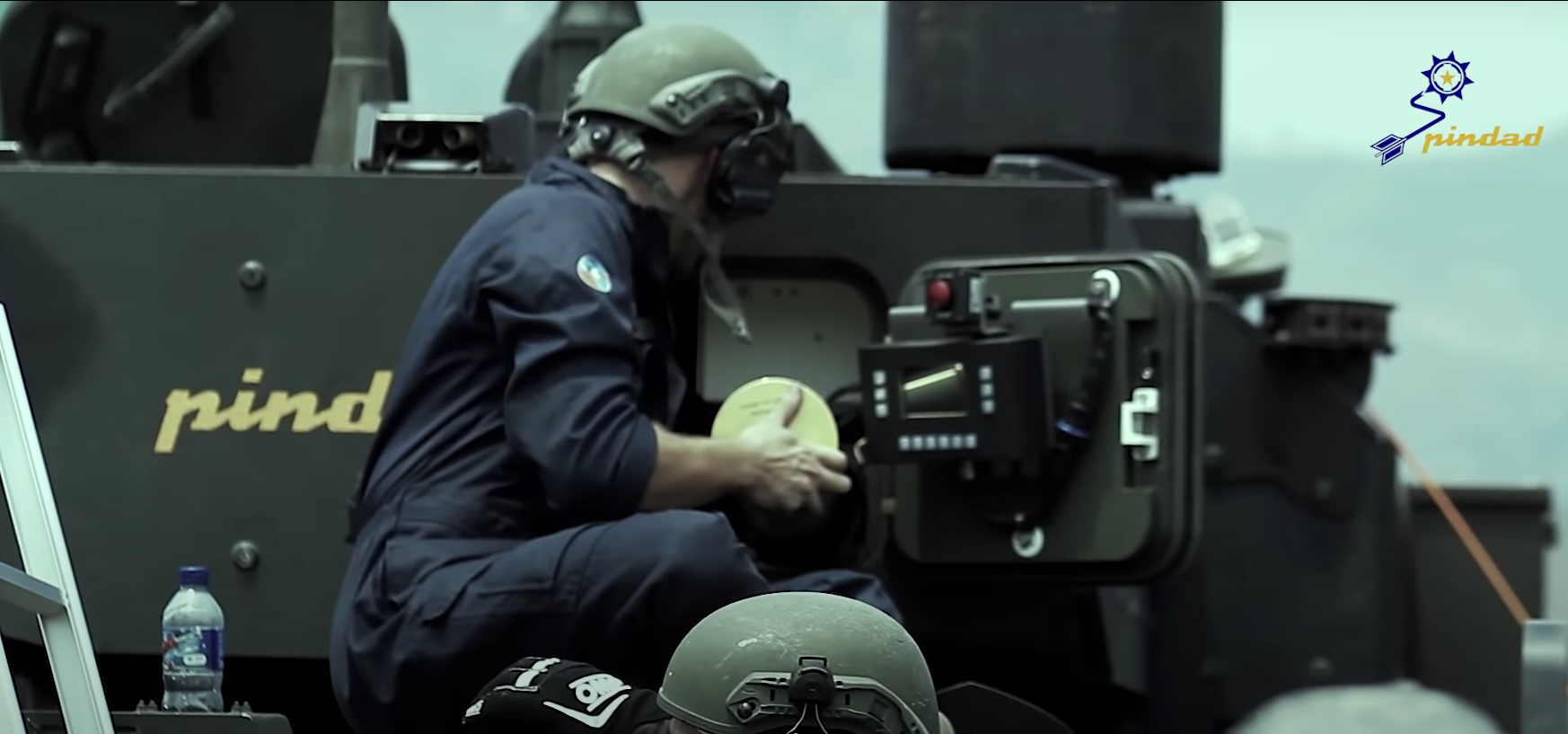

In John Cockerill official datasheet, this Turret can Mount 12 to 16 ready to fire 105 rounds in turret bustle. Have you ever heard how much the ammunutions can be carried ? Because that substantial number is a common in MBT that store their ready to use ammo in turret. (Around 12 tp 20 ammo, except for Type 90 and Lecrec)
also does this Harimau Hitam tank as a whole is capable to reload the auto loader without exposing its crew (like AMX 13)?
it's 12 round.

it's 12 round.
Bold: That my biggest concern
AMX 13, can carry 32 rounds in total. 12 ready to fire, 24 store around the hull. AMX 13 intended to be use a a pair; while one reloading the other is covering.

Abou the Black Tiger, i didnt know wether how many rounds can be carried at a time or did it can be reloaded from inside.
Captain Wales
227
188
CMIIW here
the cockerill 105mm gun from what i see and found on the web, when the round in the turret are empty they must reload from the outside.
from pindad and cockerill website that it can store about 12 round on the turret and 26 round on the hull.
Well, what i can say ?
This tank build not inteded to do longtime fighting. And still hold te role of AMX 13 both doctrine and function.
