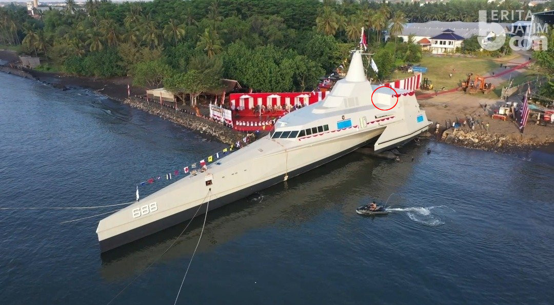

If it so, i didnt spot exactly where the provision to put AShM and RCWS.
See this boxy structure in the ship's aft section? The one marked with a red circle?
That's the place on both sides of the ship for two or four AShM embedded inside that section. On top of the superstructure just ahead the ship's mast, either a 40 mm or a 30 mm cannon will be installed there - I'm assuming that it will be encased within a special housing.
As for CIWS, there's still room behind the ship between the missile section. If not, it's also possible to just forego the naval cannon installation and use the space for the CIWS instead.
Another interesting thing is that, if I recall correctly, in their old brochure that was shown years ago, there was a CGI render where an anti aircraft missile being launched from the "nose" section. I'm assuming, again, that if this still true, the anti aircraft missile will be short range, in the same class as the Mistral or something like it.

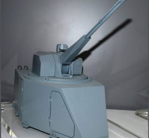

Edit:
Take this as you will:
Latest CGI.

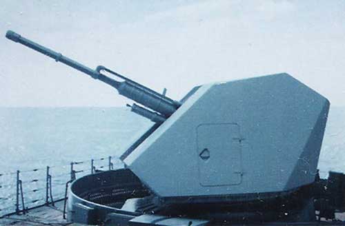

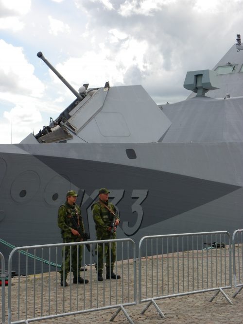

looks nice if using turret like below
Indeed. In fact, there was a modified "Klewang II" design which features the very same gun and its turret as the one in the last picture - or so, I assume, since I'm not well versed in naval guns technology.
