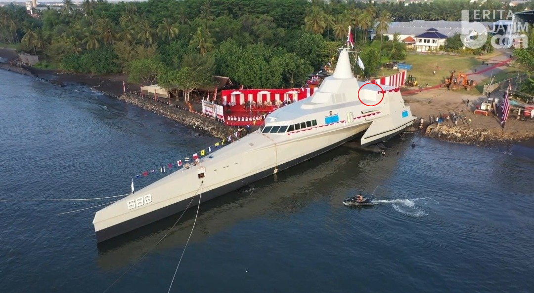

See this boxy structure in the ship's aft section? The one marked with a red circle?
That's the place on both sides of the ship for two or four AShM embedded inside that section. On top of the superstructure just ahead the ship's mast, either a 40 mm or a 30 mm cannon will be installed there - I'm assuming that it will be encased within a special housing.
there should be an exhaust system in the back which is not present I think.
like this...
like this...
