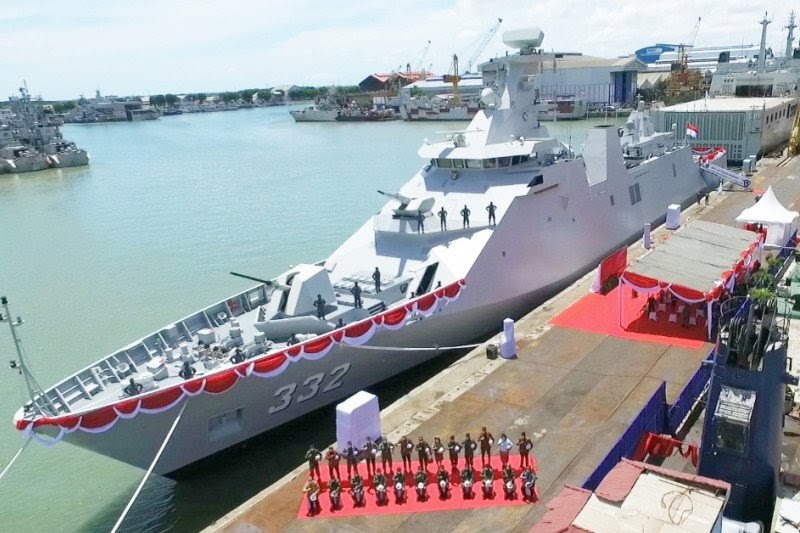

Maybe I'm getting old, or maybe something else has changed me to become more cynical lately.
But after reading this:
Which was actually posted in the official instagram account of PT PAL:
My first reactions especially about this part:
Mampu meningkatkan kemampuan produksi dari yang awalnya hanya dapat launching 1 kapal kelas fregate dalam 1 tahun menjadi 3 kapal kelas fregate dalam 1 tahun secara pararel.
Was like:
"Just f***in' do it then!"
and,
"While you're at it, put more actual news about your products and real achievements and less about ceremonials, official visits and whatnots in your website!"
Oh well... It's time to order a big glass of iced tea, I guess...
Was like:
and,
this isn't the first time you see BUMN trying to give our people a false sense of achievement .
