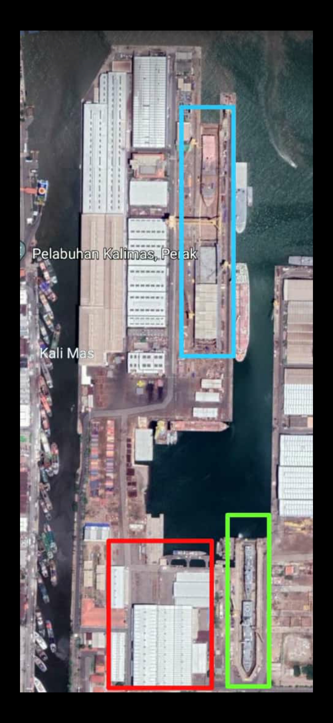

They did it very quick once the occupied dock was clear, the other new ship will be took it. I wonder did PT PAL only has one dock for shipbuilding process that could be use one at a time, if it so there'll be more streched schedule for locally made warship.
currently PT PAL has 2 dry docks,
-blue- 300+ meter, 50.000 ton capacity is used to use to assembly the ships in produce,
-green- 230 meter 20.000 ton capacity is ussually use to maintenance only,
-red- and the other facilities is small ship fabrication, like kcr 60

I think we have to improve our shipyard capabilities, not only depending on PT PAL, must include private shipyard to collaborate, such as PT. DRU, Palindo, Tesco, Citra Shipyard, etc. PT PAL has capabilities on Modular knowledge, they should be transfer it to other shipyard to build some modul and then integrate it in PT PAL. As far as I know PT PAL built the LPD & KCR modular but the modul construct in the same area too (PT. PAL)

as far that i know PT Bandar abadi shipyard got the capability to build block (even though they are in the early stages) and the facility that they got is quite good.

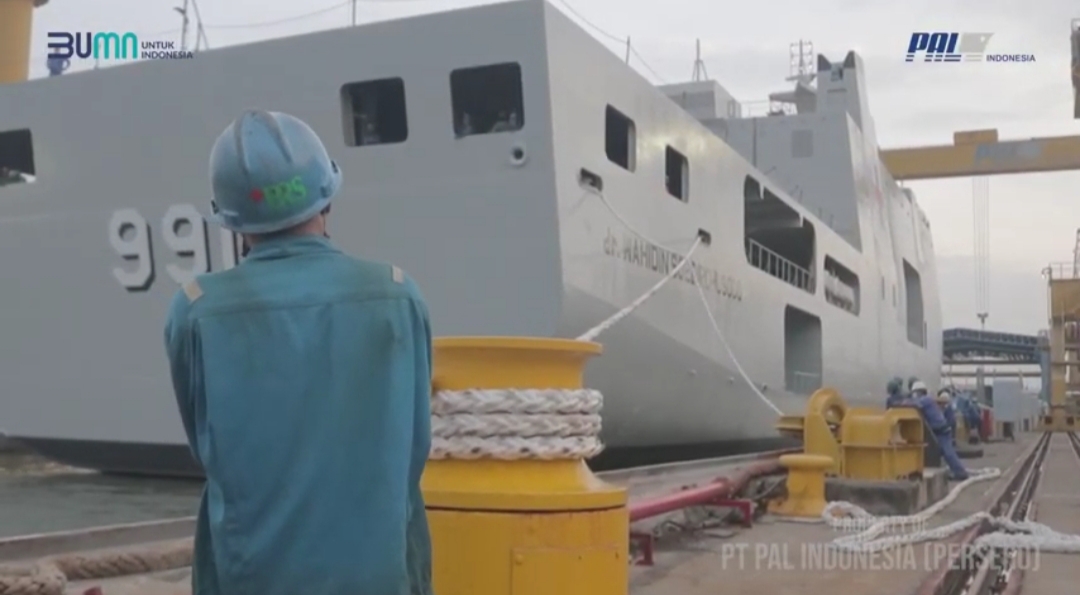

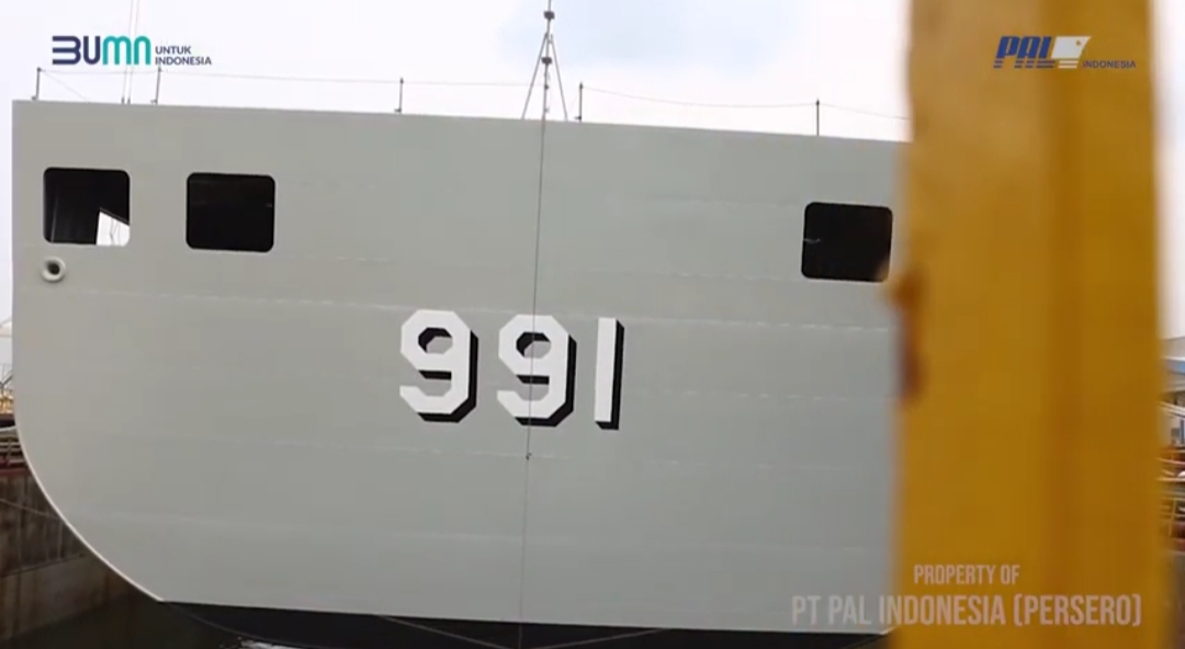

Just noticed from the PT PAL video of KRI dr. Wahidin Soedirohusodo (991) launching ceremony the vessel is without any ramp door.
