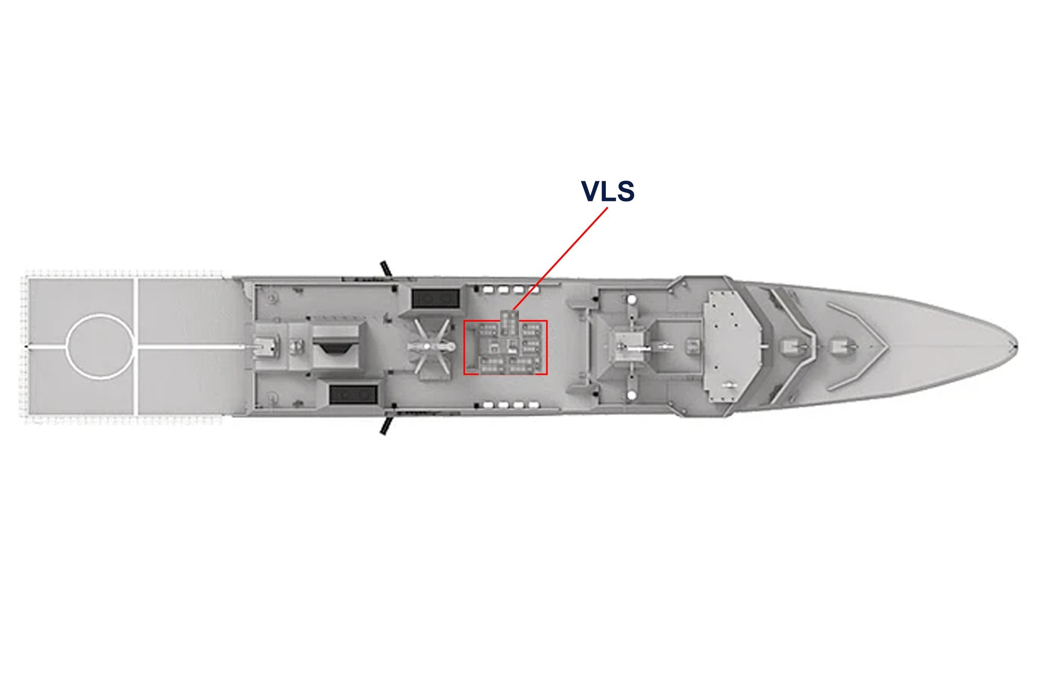

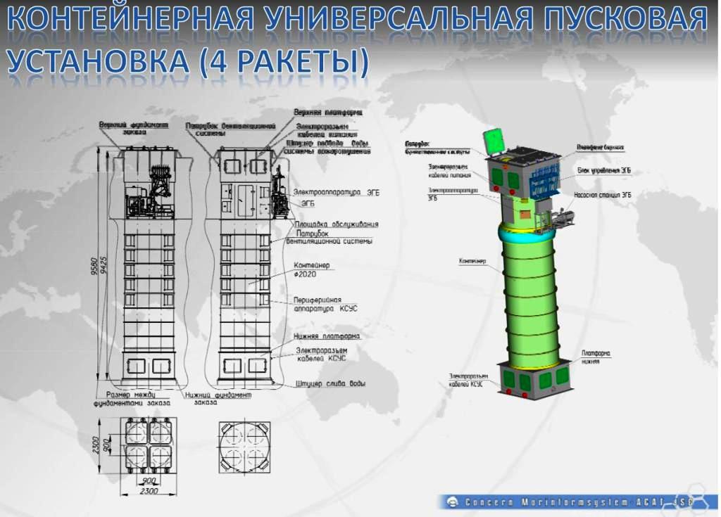

Center ones look like Brahmos VL. I can count 4 + 4 but as shown in elsewhere the modules come with 8 or 4 in co-centric launchers: However, the depth of the launcher (9580 mm) is well above what AH140 can originally made to support (Strike module length 7700mm) +1880 means another deck is occupied.
Surrounding ones could be Sylver (given the size), Mk41 or any other alternative is not that small, assuming the ones neighbouring Brahmos is long variant, i would guess A70 and forward ones likely shallow (A50 - 43). That brings us to; 4x8 Aster-30/15, 3x8 MICA/Aster-15.
Mk41 is 3.4 * 2.6 meters, Sylver is 2.6 * 2.3 meters.
A big question mark for the doubts; Brahmos VLS is given as 2.3 * 2.3 meters, the dimensions of surrounding VLS do not fit to this.
And here is the correction assuming it is a Sylver; Top (Port side) was a trial to fit in vertical orientation, it doesn't fit to VLS bay of AH140, starboard is likely arrangement for horizontal placement. This concludes me, you guys are either getting Barak-8/ER or the naval architect has done a grave mistake by misreading Sylver VLS dimensions.
However, afting wasting my lunch break, the naval architect fellow was cool;
Side by side with Brahmos VL (8 cell), the Barak-8/ER launchers that seem to fit given dimensions and correlating with earlier mentioned 64 (56+8) VLS and the image published by PAL - generated by Babcock. Hence why they refer to these missiles as "MRSAM - LRSAM" a designation that India uses. @Nilgiri @Gessler.
Another image that may suggest the idea Brahmos VLS vs Barak-8 VLS.

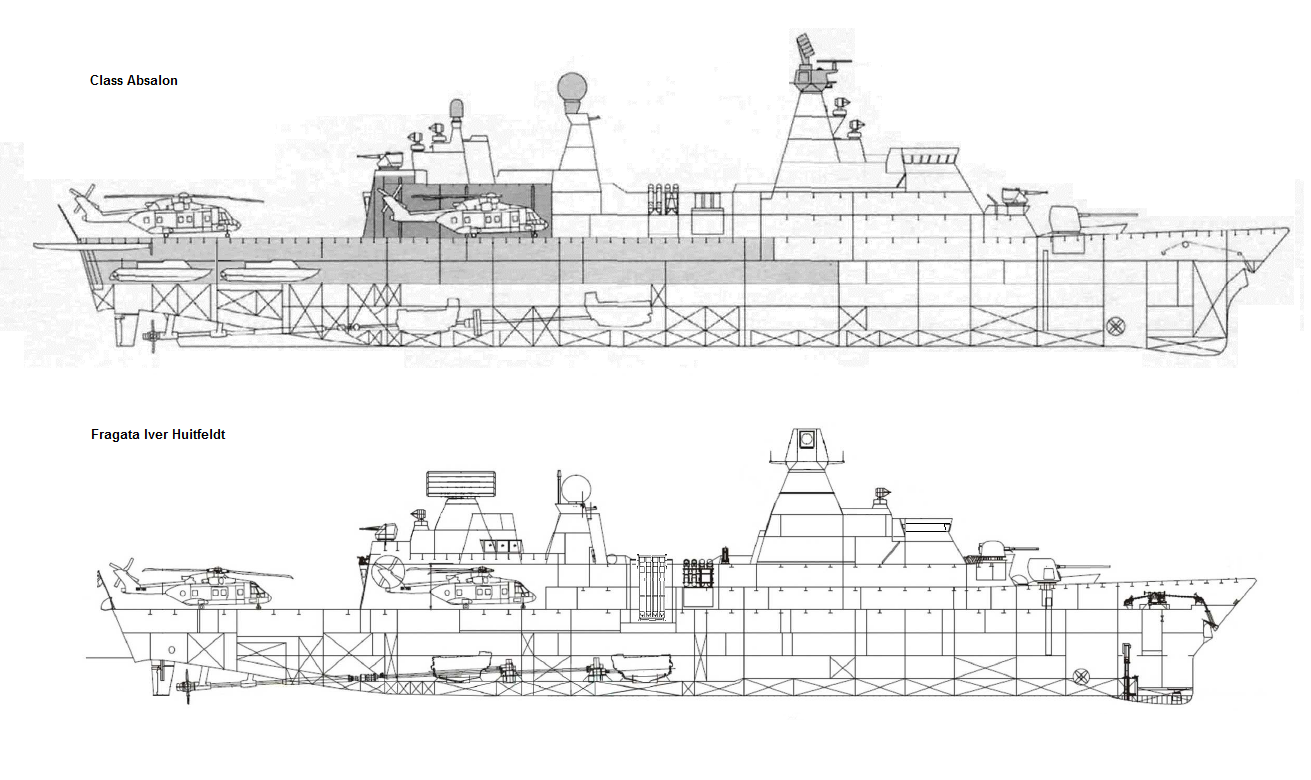

So they will levelup the middle deck only for the Brahmos VLS?
absalon class
Iver
Elevating deck is not simple as thought ( that actually means adding another deck) , Just my guess but they would rather leave the VLS standing out from the or extend side plates to shadow it to reduce the RCS.
One aspect I worry the most is stability.
That is a pretty huge weight hanging up there.
And it is the main engine room below the VLS. So, i am doubting if they will ever penetrate through that deck.
