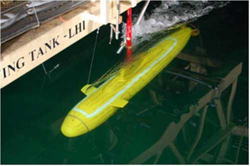

Indonesia doesn't still have an infrastructure to design and build a submarine,alone, thus a foreign partner to provide a major assistant is still present.
It can be imagined to design and build submarine at least after there are one test tank ( one for towing, one for submarine maneuvering), and one water tunnel (if possible dual purpose, one for cavitation and flow tests, another for acoustic tests)
So without these:
- a towing tank (optional, because if done right, a water tunnel can be used for these purpose)
- a deep-maneuvering tank (a must)
- a cavitation tunnel -water tunnel capable to do acoustic tests. ( a must)
- or optionally a water tunnel dedicated for acoustic&flow tests (optional, if done right, the water tunnel can serve this purpose)

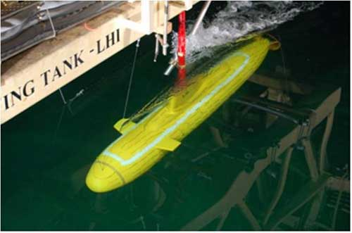

BPPT has made midget submarine design as well and has been tested in their facility
"Tested" for what? , and the design originates from somewhere else still. In 2016-2017 SK has delivered a concept to be developed jointly, i think it is being recycled.
Aero tests are only valid for flow-hydrodynamic preliminary form optimization, it doesn't help for further.
There is one towing tank but i think it is not enough for submarine tests. ( to hook and tow)
IBT and UI (also either a design office or PT PAL) also have been working on one design, again assisted by Korea in the background, probably this one in BPPT is theirs.

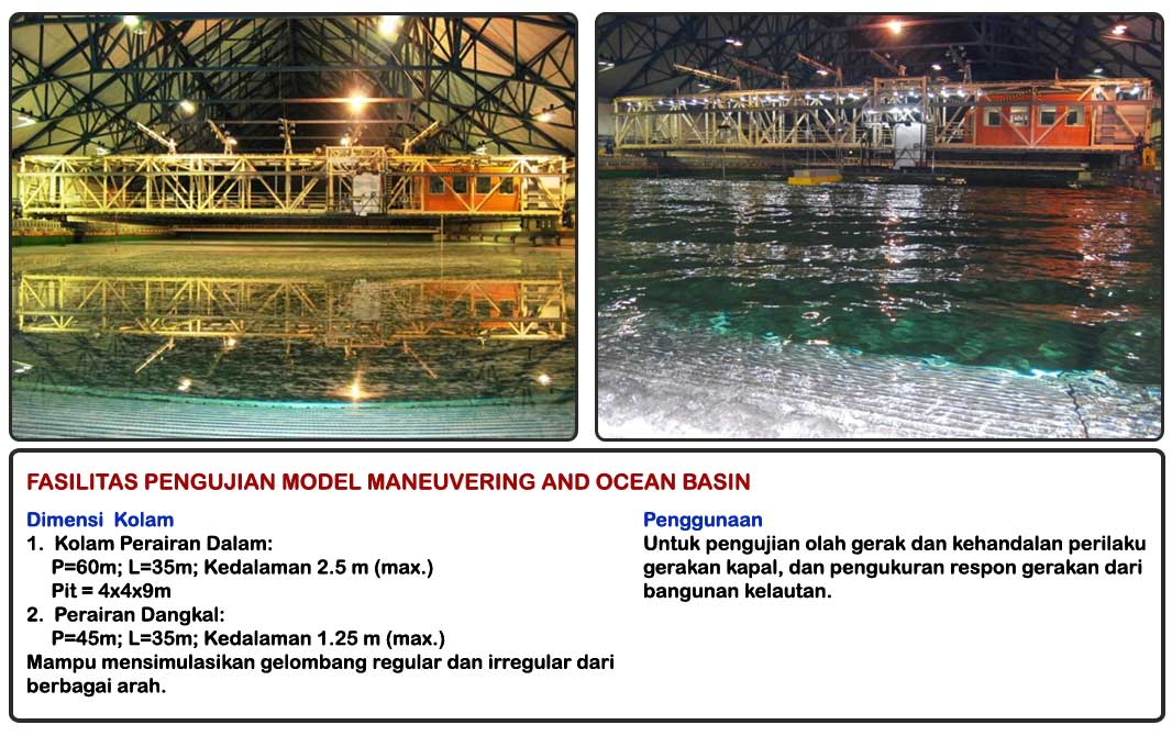

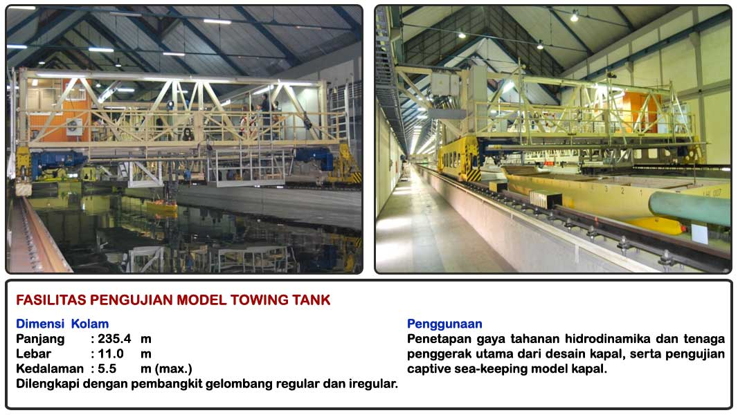

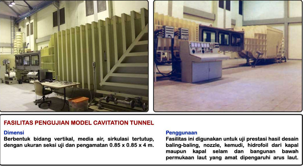

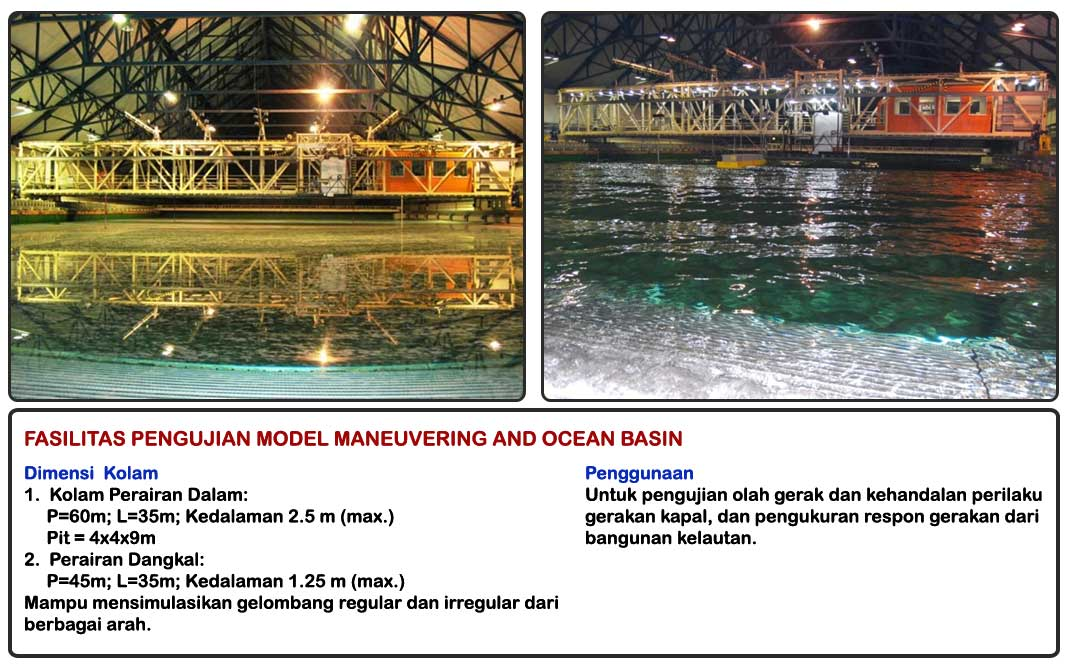

hydrodynamic testing laboratory ? like this ? we do have one in surabaya near ITS (surabaya / 10th november institute of technology) which well known with its shipbuilding and naval engineering graduates (surabaya also where PT.PAL is located)
https://layanan.bppt.go.id/index.php/layanan/fasilitas?Layanan[id_pengguna]=3

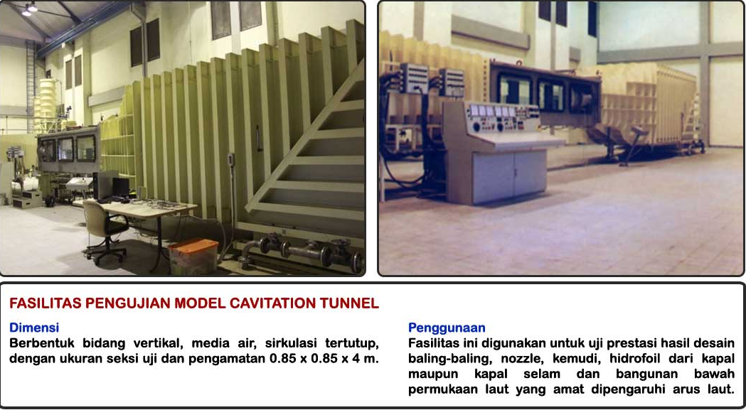

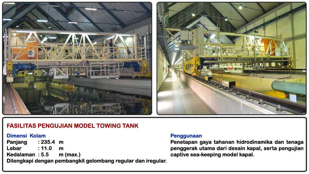

BPPT has cavitation tunnel, towing tank, basin tank. If not tested in those, then it is not a serious project.
You don't test a submarine in a wind tunnel when you have these previous three.

hydrodynamic testing laboratory ? like this ? we do have one in surabaya near ITS (surabaya institute of technology) which well known with its shipbuilding and engineering graduates (surabaya also where PT.PAL is located)
I know these, but what i am telling this is not "sufficient" to design it.
That cavitation tunnel is propeller-cavitation only, no wake conditioning, no acoustic chamber, they have pressure conditioning for cavitation (which is sufficient for cavitation test,thrust design of propellers).
The towing tank is for surface vehicle only, can be used for surface maneuvers of submarines, not for vertical maneuvering or submerged vehicles. If you plan to sail the submarine always on surface, then why not.
Indos
1,219
1,537
