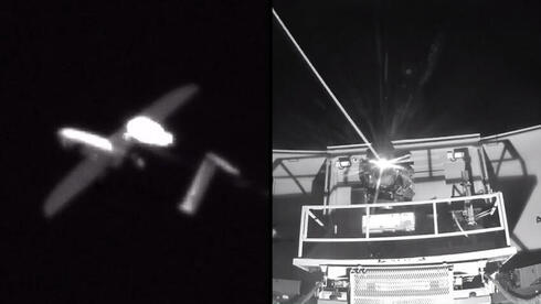

Israel successfully tests laser defense system able to intercept drones, missiles​
Defense Minister Gantz says the 'Iron Beam' is a game-changer, will significantly improve Israel's defense capabilities; the high-end experimental system is expected to become operational in 1-2 years
The Defense Ministry announced on Thursday that it successfully tested a high-powered laser defense system able to intercept missiles, drones, mortars, and anti-tank rockets in the first in a series of tests.
The system was developed by Rafael Advanced Defense Systems which will supply it to the Israeli Air Force with the very first laser launchers.
Defense Minister Benny Gantz who was present at some of the experiments said this achievement is a huge contribution to Israel's security.
"The Iron Beam system is a game-changer. We are able to significantly improve our defense capabilities, while also making it economically viable. It will take time until this kind of technology will become operational, but we are definitely on the right course to success," Gantz said.
The next stage will be a laser system for ground troops and the air force able to be used as a weapon.
The laser beam defense system was first tested against targets on the ground. Later stages tested its ability to intercept projectiles such as missiles and drones, in the air and day by day the system was tweaked and improved to make it more accurate.
The system is less effective in foggy or cloudy weather conditions, due to the need for a direct line of sight between the laser beam transmitter and the target, and that is a drawback.
At the end of the development process, the system will be relatively simple to use, as it will be mounted on two trucks with a launcher that will be attached to an external radar, a generator, and an operating caravan.

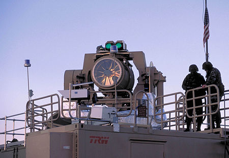

Range is up to 10 kms. Power - about 100 kWT. The best thing about Iron Beam system that it is using fiber laser, which is quite compact and easy and cheap to maintain.
In late 90-es and early 00-es Israel together with US developed THEL system, which used chemical laser. It was bulky and problematic. Thats why it was cancelled.
