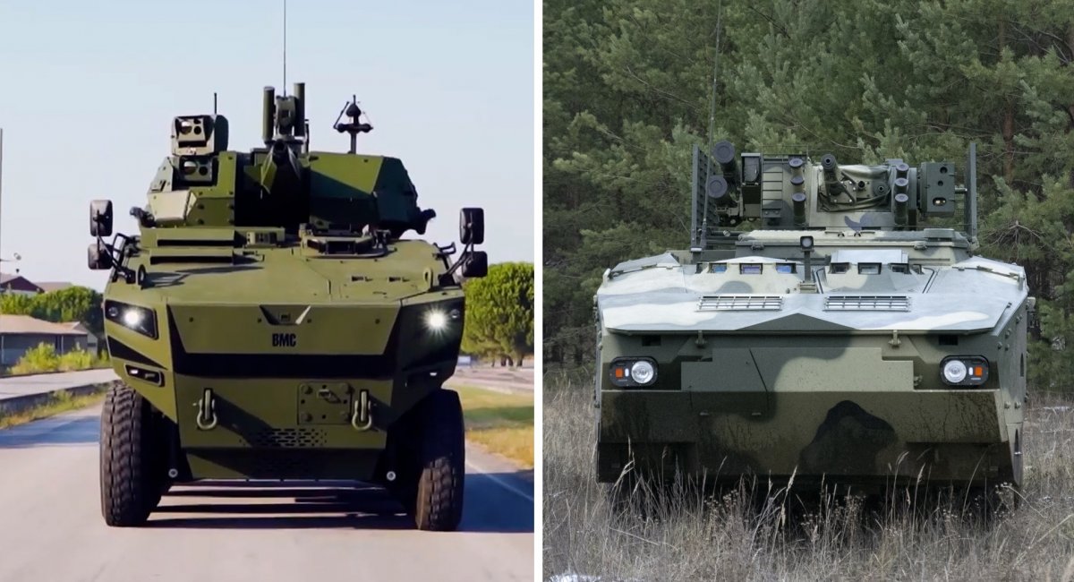

Turkish Altug and Ukrainian BTR-4MV1: compare the latest armored vehicles​

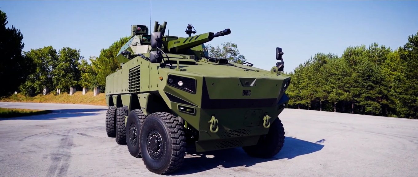

BMC's Altuğ 8x8 is the latest Turkish armored personnel carrier, which was first demonstrated publicly only a few months ago. It is positioned as the top solution of the Turkish defense industry in the field of wheeled armored vehicles, absorbing the most technological developments.
Defense Express, during the SAHA exhibition in Istanbul, had the opportunity to see Altuğ in detail and compare it in absentia with the latest Ukrainian serial armored vehicle - BTR-4 and its more powerful version BTR-4MV1, which, unfortunately, has not interested the Ukrainian military .
The first thing that catches your eye is the dimensions of the Turkish Altuğ, whose height on board is 2.65 meters, and with a combat module of almost 4 meters.
The height of the Turkish armored personnel carrier with a combat module is 4.5 meters
For comparison, the height of the BTR-4 is 2.8 meters, which is primarily due to the desire to make the car less visible on the battlefield.

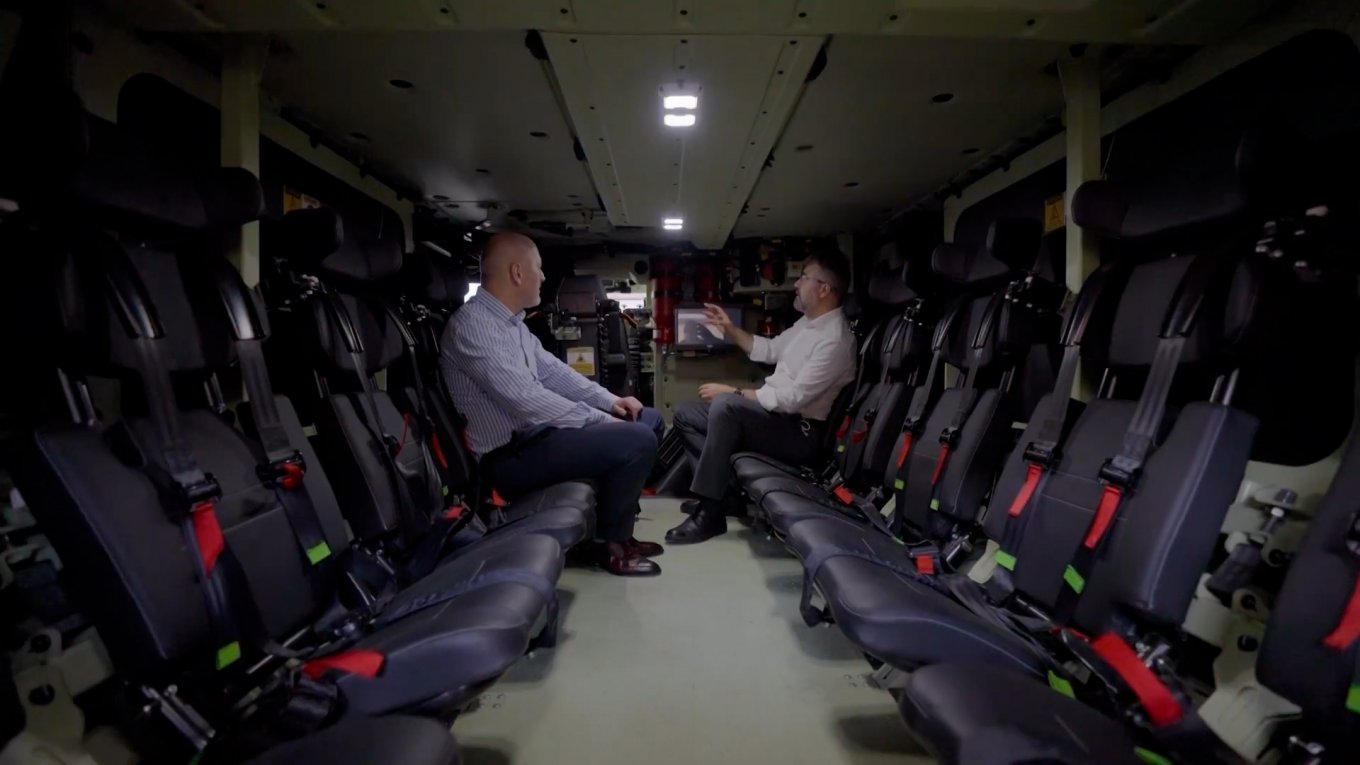

And, at first glance, it seems that inside the much larger Altuğ has much more space. However, in reality, this is not the case, the car, which is designed for 3 crew members and 9 fighters, does not differ much in internal volume.
Altuğ inside
Altuğ inside

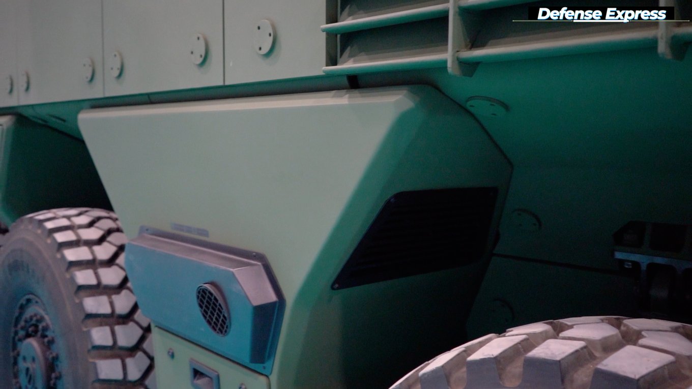

And the main reason for this height of the case - in providing mine protection thanks to the V-shaped bottom. At a time when the BTR-4 only after additional measures, the flat bottom was reinforced with another armor plate with spaced armor.
At the same time, the use of a V-shaped bottom in the Altuğ has resulted in all hydropneumatic suspension components being outside the armored hull and a ground clearance of 40 cm.
V-bottom and Altuğ suspension

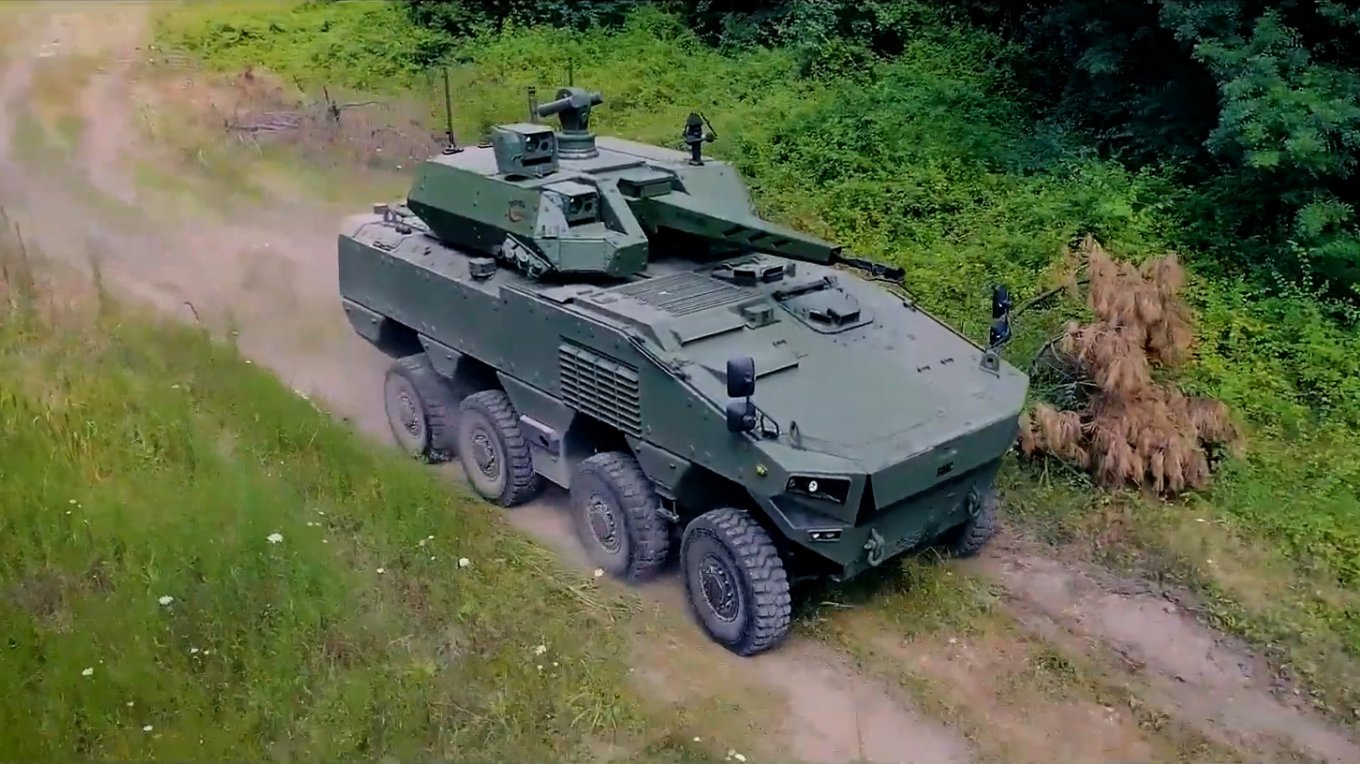

In general, Altuğ has a good passability, including overcoming trenches over 2 meters wide. And all the wheels of the armored personnel carrier are rotary, which makes the car quite maneuverable.
But the Turkish armored personnel carrier, unlike domestic, does not float. The maximum depth of the ford for it is only 120 cm, however, given the geography of Turkey, this figure is not a global negative factor.
Turning radius of 8-meter Altuğ

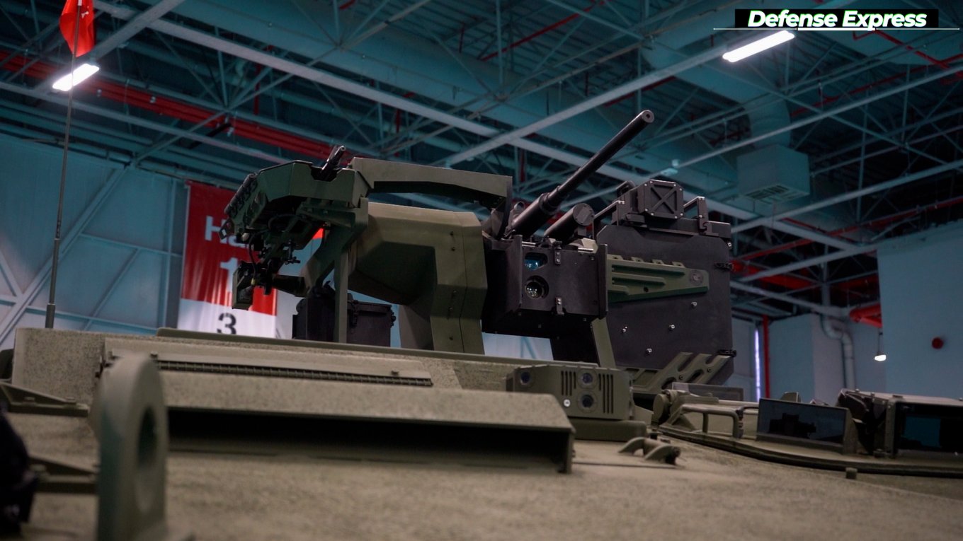

The approach to arming the machine also needs attention. At the SAHA exhibition, Altuğ was demonstrated with a combat module for 12.7x99 mm and 7.62x51 mm machine guns. This is the so-called version of the APC (armored personnel carrier), which in NATO countries is an armored personnel carrier, in the sense of a combat vehicle, whose main task is to safely deliver fighters to the battlefield.
Altuğ combat module in the APC version
At the same time, there is a version with a combat module for a 35-mm automatic gun. This module from Aselsan is a modified version of the module from the promising crawler BMP Korhan. The more armed version of the Altuğ was designated the IFV (infantry fighting vehicle) - an armored infantry vehicle.
Altuğ combat module in the IFV version

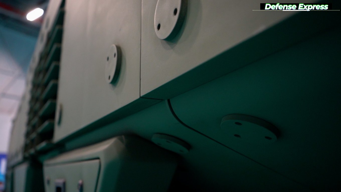

Another interesting feature of Turkish design is the maximum use of ceramic armor. The machine in all projections is additionally protected by panels, which in case of damage can be easily replaced in the field.
Ceramic panels differ in the accuracy of fitting to the body

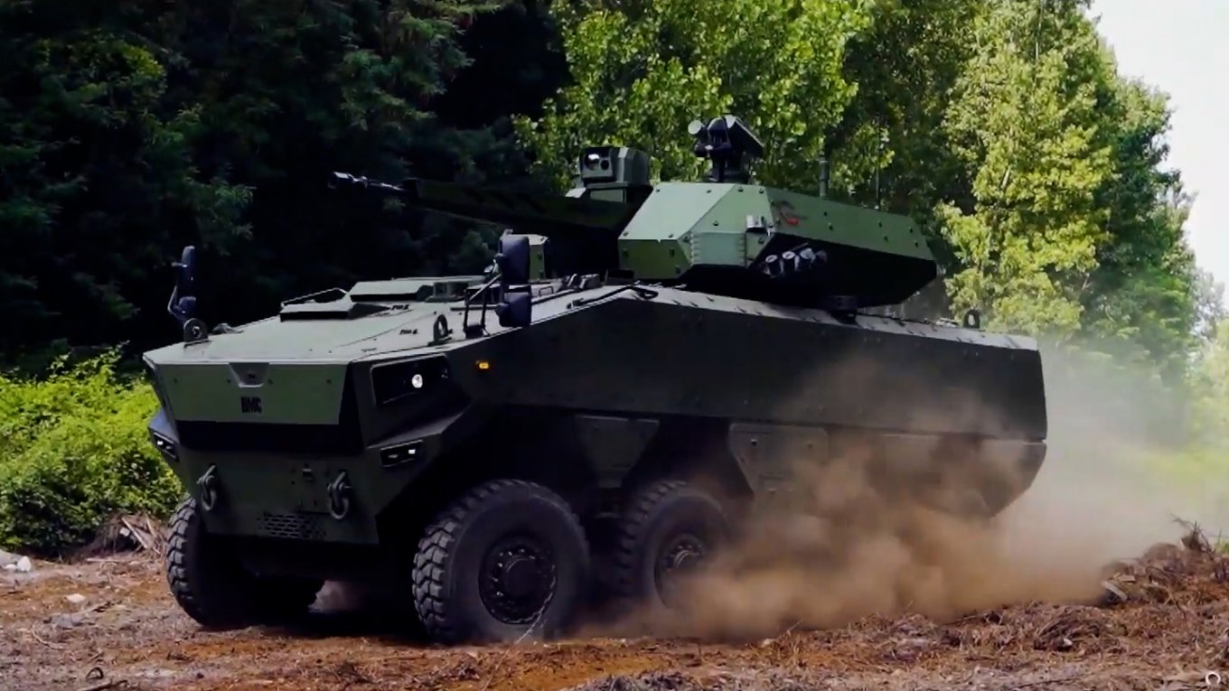

The maximum speeds of Ukrainian and Turkish armored personnel carriers are the same - up to 110 km / h. But if the 450-horsepower German Deutz is installed in the BTR-4, then the American 7-hp Caterpillar is installed in the Turkish armored personnel carrier. Interestingly, Ukrainian and Turkish developers focused on one transmission supplier - Allison. In any case, the maximum speeds of cars are the same - up to 110 km / h.
In general, what conclusions can be drawn after such a correspondence comparison of Altuğ with BTR-4. The naked eye can see the difference when providing high mine protection crosses the size requirements. And the weight of 30 tons, the rejection of amphibians and the widespread use of the latest technologies allows to ensure reliable safety of the crew from enemy fire.
The weight of Altuğ is most likely about 30 tons

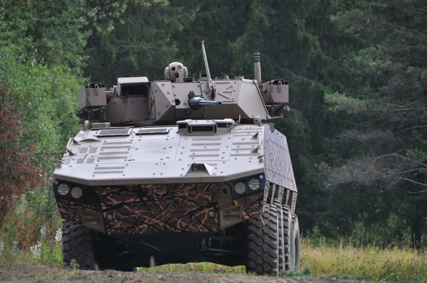

It should be emphasized that the "recipes" for which Altuğ was created are not Turkish know-how, but following modern Western trends in the development of armored vehicles. The same solutions can be seen in models such as the latest versions of the Finnish Patria or the German Boxer.
Patria AMV XP
Patria AMV XP

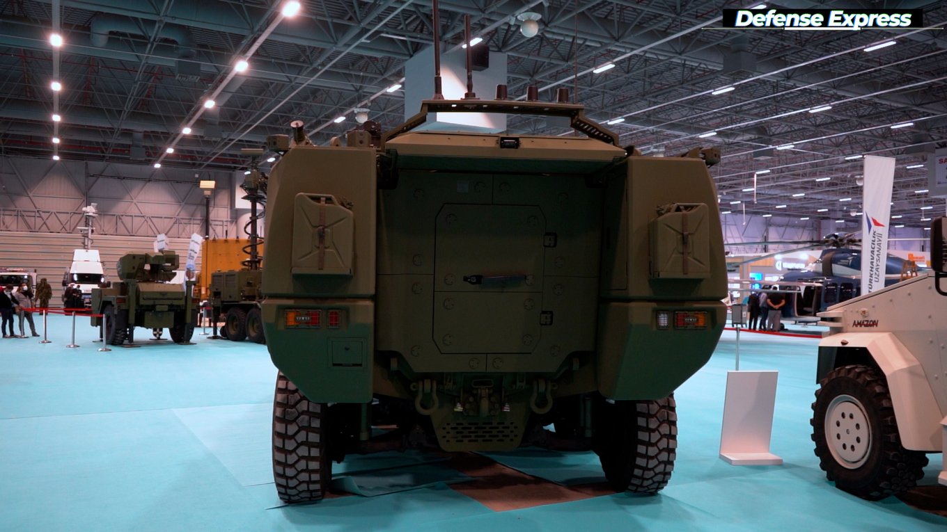

After reading that Nurol Makina was responsible for the FNSS Pars 4x4 Design and Production I decided to Compare 2 seemingly similiar Products
"PARS 4×4 STA has been developed as a collaborative work with Nurol Makina as of the design phase. Kurt said the following about his subject: “This project draws attention with the fact that the design works were carried out in the partnership of two companies"
Nurol Makina YÖRÜK and FNSS PARS 4x4
Length5m5m
Width2.4m2.6m
Height2.1m2.1m
GVW12 Tons12 Tons
HP/Weight Ratio25HP/Tons25 HP/Tons
Engine300HP Cummins300 HP Cummins
Fording0.9m0.8m
Crew5 (+4)5
Range700km700km
Gradient70%70%
Side Slope40%40%
These Infos are from FNSS website and DefenceTurk for YÖRÜK
Comparing these two it seems very apparent that they are quite similar especially considering that NUROL was involved in both projects.
The similarities are suggesting a Identical Chassis.

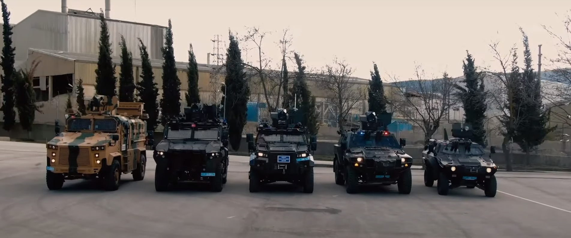

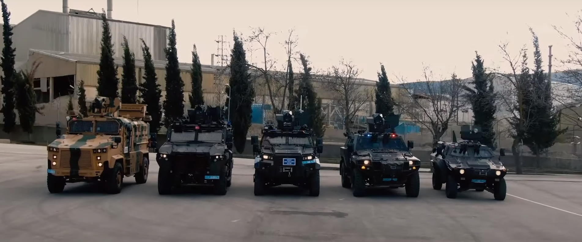

Gendarmerie APC Inventory.
Gives a nice size Comparison as well.
-BMC Kirpi II
-BMC Vuran
-NUROL Yalcin
-OTOKAR Cobra II
-OTOKAR Cobra I
