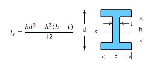

The selection of a delta wing configuration for the Lavi had a variety of implications - above and beyond the available fuel volume. The spars that carry the span-wise load through the wing of an airplane are essentially tapered I-beams in their cross-section. As any freshman engineering student should know, the modulus of an I-beam will increase as the height of the I-beam cubed, and the bending stress of an I-beam will decrease as the height of the I-beam squared. The result was that due to its thicker wing root, the Lavi wing structure was inherently stronger, and could carry more weight than its counterparts.

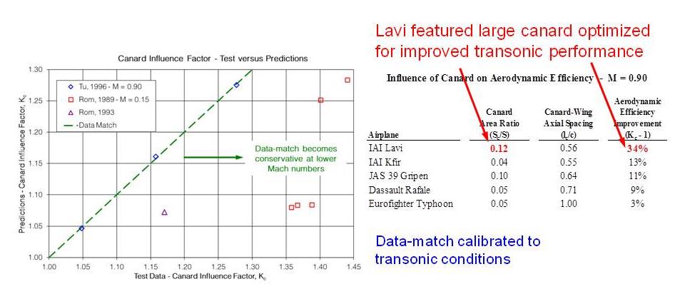

Among the most central design choices made by the Lavi developers, was the selection of its canard-delta configuration. Canard fighter designs fall into two general categories: close-coupled, and long-coupled. Close-coupled canard designs place the canard in close proximity to, and slightly above the wing, to maximize the canard-wing interaction and increase the airplane's lift-to-drag ratio. This design approach includes such aircraft as the Kfir, Gripen, and Rafale - in addition to the Lavi. Long-coupled fighter designs, in contrast, attempt to leverage the high angle-of-attack control authority that the canard offers, while reducing the size and wetted area of the canard to its bare minimum. These designs, as represented by the Rockwell-MBB X-31A, or by the Eurofighter Typhoon, will tend to maximize the distance between the canard and the wing, and will position the canard at the same elevation, or perhaps slightly lower, than the wing.
Relative to its wing size, the Lavi had the largest canard of any fighter or fighter prototype yet developed. It was also positioned closer to its wing than most of its counterparts, resulting in a greater improvement in aerodynamic efficiency. This, in turn, further enhanced the Lavi's combat radius.

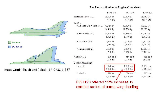

The other leading design decision that had to be made early in its development, was the airplane's engine selection - which was integral with the overall airplane sizing process. The Lavi fighter was originally sized around the F404 engine, at the time of the program launch in February 1980. As the requirements of the program expanded, however, it soon outgrew its original engine selection, and the design was relaunched in May of 1981 with the larger PW1120 engine. The PW1120 afforded a 28-percent increase in available engine thrust, which translated into a larger airframe, with up to a 19-percent increase in combat radius.

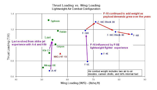

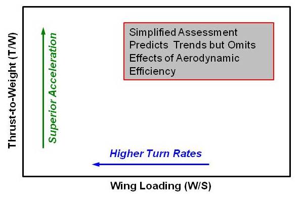

Despite its focus on the air-to-ground role, however, the Lavi still needed to be able to perform a secondary air-to-air function. A first order assessment for how the Lavi would have performed in this role can be obtained by comparing the thrust-to-weight ratio, and wing loading of the Lavi to similar values for its counterparts. In general, aircraft with higher thrust-to-weigh ratios will tend to offer superior acceleration, and aircraft with lower wing loadings will tend to offer superior, instantaneous turn rates. This comparison is valid for trends only, however, since it lacks any correction for differences in the aerodynamic performance of each design.
Compared in this fashion, it can be seen that the Lavi and the F-16A were developed with very different strategies in the air-to-air arena. Building on historical experience with such lightweight fighter designs as the F-5E, the F-16A sought to maximize its advantage in thrust-to-weight ratio over its peers of the day. The Lavi, in contrast, still had to perform its primary mission as an air-to-ground platform. It could not therefore expect to meet or exceed the thrust-to-weight capability of aircraft such as the F-16, seeking instead to leverage its advantage in wing loading to attain a higher turn rate.
It can also be seen from this comparison that, as additional strike roles were added to the F-16, weight was also added in order to increase payload capability. Advances in engine technology allowed the F-16 to maintain its high thrust-to-weight ratio with each successive Block release, but its wing loading continued to climb - impacting turning performance.

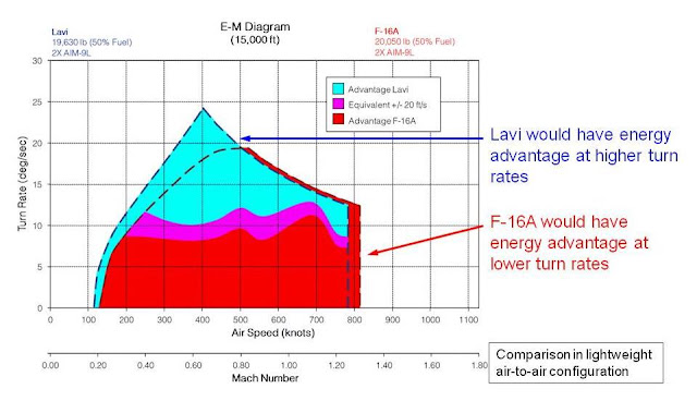

A more complete story of relative aircraft performance can be achieved using an energy-maneuverability, or "E-M" diagram. The E-M diagram will portray isocontours of specific excess power, plotted against speed or Mach number on the horizontal axis, and either altitude or turn rate on the vertical axis. Regions where the specific excess power is positive, will denote zones where the airplane is able to accelerate or gain altitude. Regions where the specific excess power is negative, will denote zones where the airplane will lose either speed or altitude. The isocontour where specific excess power is zero, will identify the maximum sustained turn rate for the airplane at that particular speed, altitude, and weight combination. The E-M diagram also allows us to compare competing fighter designs, to evaluate regions of the flight envelope where each is at a relative advantage.
In the instance of both the Lavi and the F-16A, there is published data available from the open literature allowing us to develop an unofficial, approximate E-M diagram from which to make just such a comparison. As anticipated, the Lavi would be expected to achieve an advantage at elevated turn rates. The F-16A, in contrast, would be expected to achieve an advantage at lower turn rates - where it could out-accelerate the Lavi.
