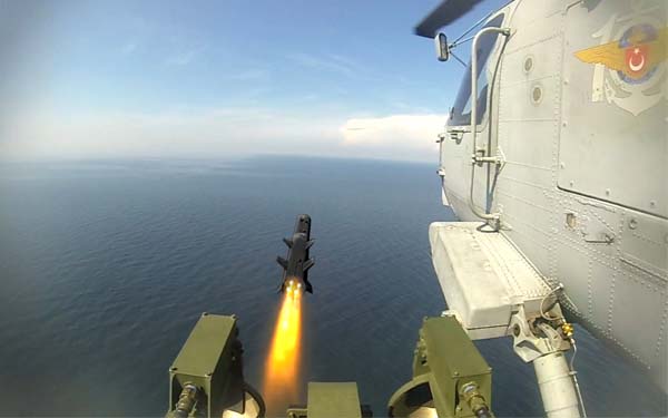

Seahawk S70B helicopters, used in ASW and ASUW missions, that are in the inventory of Turkish navy, having come to the end of their certification programs, are being fitted with Umtas and L-Umtas missiles.
Seahawks have the capability to fire missiles like hellfire, light torpedoes and Penguin anti ship missiles. With this capability these helicopters, will for the first time, be able to use indigenously produced missiles.
How ever the above news doesn’t make it clear if it will be the newly extended range Umtas missile with a 16km range that is being integrated to these helicopters.
Use of local weapons from these helicopters will pave the way in the months to come, the use of Medium Range Anti Ship Missiles like CAKIR, Kuzgun TJ and Kuzgun KY that are being developed as well.

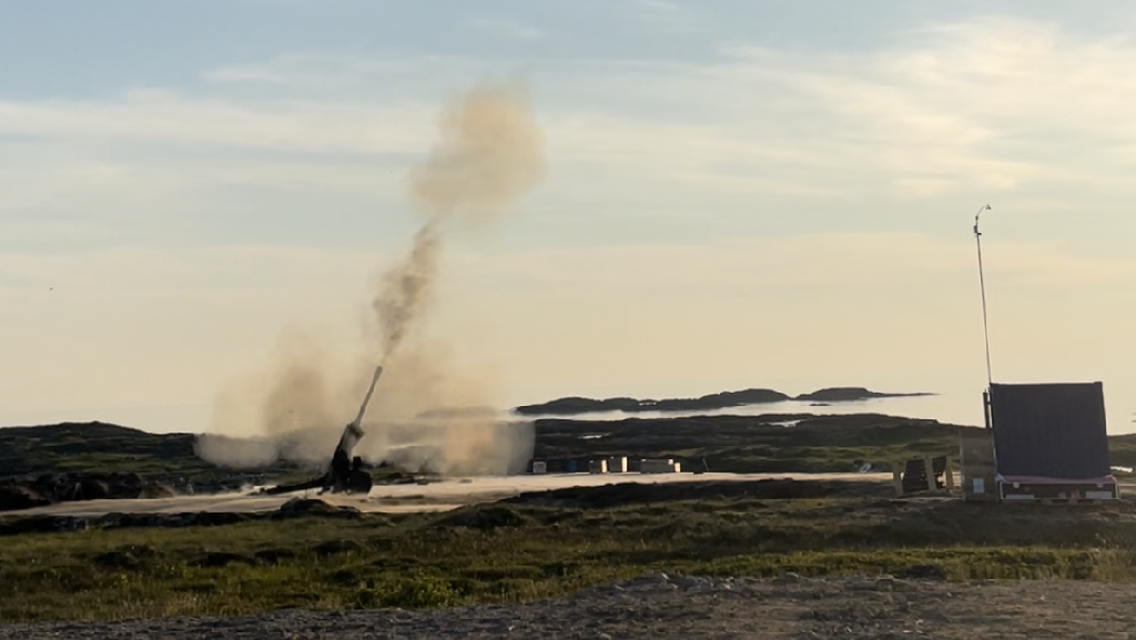

The Ramjet-powered Akbaba anti-radiation missile has started firing tests. The ramjet engine is said to be developed by Roketsan.
AKBABA National Anti-Radiation Missile will have both passive (wideband, a kind of EDT sensor) and active RF Seeker (which will operate in a different frequency band than the existing RF heads, again mechanically directed, not AESA type).
In the Aselsan 2020 Annual Report, it was stated that the Radar Seekers were successfully operating within the scope of the live-fire tests of the missiles and that the Radar (RF) Seeker Heads for surface cruise, air defense, air-to-air and air-to-ground missiles were successfully carried out.
