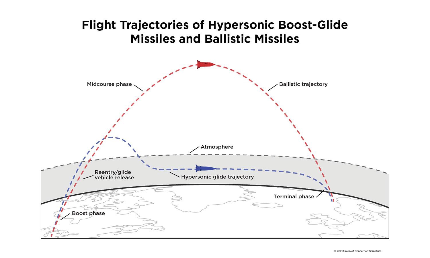

There is one thing we have all overlooked.
Tayfun flew for 458 seconds and hit the surface 561km away. But it actually went up ~50km and down ~50 km as well. That is if the top altitude was 50 km.
That means it flew 561km + ~100km = 661km in 458 seconds. That makes average speed as 4.3 Mach.
That means that this missile was travelling at speeds well in to hypersonic range for a good portion of it’s flight.
(blue line is the suppressed trajectory of a quasi ballistic missile. Red line is a ballistic missile trajectory)
Just want to ask a question though
Are quasi-ballistic missiles better than normal ballistic missiles?
afaik, quasi ballistic missiles can do unexpected changes in route, making them harder to intercept, especially when the interceptor is slower than the missile.
I would say main advantage of Tayfun is not the longer range, but it can be used for closer ranged targets with more speed available in terminal phase (as other users pointed out burning of fuel lasts more than normal ballistic missiles) and gap for manueverability
