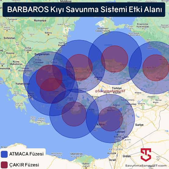

Waov. The first time i heard about Barbaros.(or i might have forgotten)
İmpressive. here is the Mavivatan.
Although the Çakır and Atmaca missile families fill the gap in the medium-long range, I don't think they will cover all the layers on A2/AD concept. I mean, there can be much more diversity in coastal defense batteries. I think it is only a matter of time before the Raven emerges at short ranges and a new missile group at very long or supersonic cruise speeds.
I am almost certain that once SAGE's ramjet works reaches a certain level of maturity, we will try to utilize this technological advantage in almost every missile group.

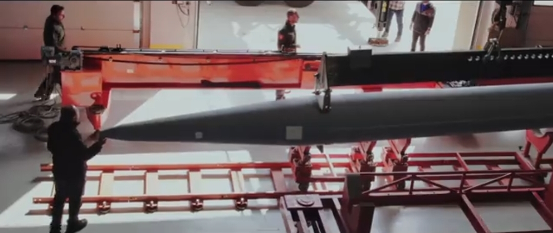

From Roketsan video upper stage of sounding rocket line diagram is shown. It is likely that the hypersonic re-entry vehicle of CENK is also similarly powered.
CENK re-entry vehicle
