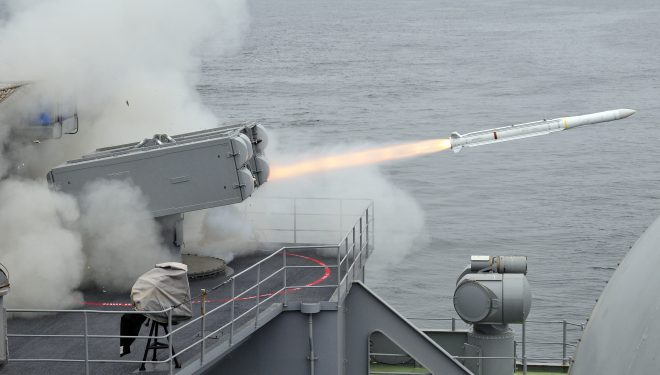

ESSM is designed for stopping supersonic and subsonic cruise missiles and low speed aircrafts. It is especially good against sea skimming missiles. It was never designed against ballistic missiles.
quote:
Mission/Role:​
The mission of the ESSM is to provide the U.S. Navy and allies of the United States with a missile with performance to defeat current and projected threats that possess low-altitude, high-velocity, and maneuver characteristics beyond the engagement capabilities of the RIM-7P Sea Sparrow.
Unquote
Although real range and altitude figures are classified, ESSM is thought to have an effective range of 40-50 km . it can not go too high in altitude either - just check our Gokdogan/G40 if launched from land-. With that sort of range and altitude it would be a real feat of achievement to hit a target like Bora which will cover that 40km within 20seconds. Also if it was vertically trying to hit the incoming Bora, an ESSM will not even make half that distance.
Logically, like you say, if vertically launched and had enough juice in it like a booster, it could be able to intercept.
Also the targeting radars of ESSM will have to be able to lock on to the maneuvering and altitude changing Bora in the first place.
1st How an interceptor missile works?
Bora will be detected far before than 40 km distance, nearly max distance of search and track radar, ESSM will have enough time to intercept with a predicted route. Block II has active rf seeker for terminal stage which wont rely on the ship for illumination in that stage.
The low altitude does not only refer to sea skimming missiles. It depends on flight profile of Bora but it wont be exactly vertical too.
2nd Bora as other ballistic missiles doesn't have any maneuvering ability. It follows an easily predictable path with corrections for guidance, easy to keep radar lock on. ESSM will not need to maneuver for that, probably effective range and altitude may increase.
What is the advantage? Possible threats which Bora might be used against is not acquainted with such a threat. ESSM and other self defense systems are rather optimized for near surface threats (or up to medium altitude for ESSM) but still useful against, yet operators is not trained for that.
It is not the same for a sea skimming HS cruise missile which is detected rather late, leaves a little response time.

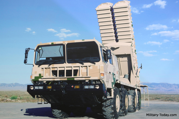

Bora 1 (Khan) is a copy of Chinese M20 missile system. M20 itself is the copy of Russian Iskender-E missile.
Quote:
This ballistic missile reportedly has built-in countermeasures and is capable of evading hostile missile defense systems. Most likely that in the terminal phase of the flight it excessively maneuvers and releases decoys. In some cases this ballistic missile can be used as an alernative to precision bombing.
Khan is a Turkish license-produced version of the M20.
unquote
It does have maneuvering capability to evade AD systems.
unquote
Evasive maneuvers at Mach 5 with very small control surfaces of such an heavy missile? Doesn't really make much sense. I am writing again if you didn't read earlier or skipped those parts:
Such a missile can be detected at 200km + distance with Smart-S equivalent. And can be tracked effectively,
ESSM can be launched at a suitable time to engage at suitable altitude and range, it doesn't have to be fired when the threat is at 40 km distance, It can be fired earlier.
ESSM's effective range is 40~50km with maneuvers typically needed for an incoming cruise missiles, with Medium-Range role it is even further, higher altitudes can be engaged too.
A mach 5+ ballistic missile in a free-fall mode is not expected to maneuver as much as a cruise missile which is powered by an engine and larger control surfaces ,relative to its size and weight.
*Such evasive maneuvers are conducted by multiple re-entries (changing projectile profile temporarily) or spiraling down towards the target, not comparable of cruise missile's evasions, these are not sufficient to evade an AD missile with a lock-on but only to avoid INS guided interception point.

This website says the diameter of Khan is 610mm while diameter of M20 is 750mm. So it's not a license produced copy. It could potentially be a derivative, but they offer no evidence of this. They also say one was fired into Iran, and in another page on the same site it says it was fired into Iraq. Both are false - it was fired into Syria. Obviously this website does no fact checking or even basic editorial oversight so I wouldn't give it much credence.
4,199
252 21,917
You are correct in pointing out the inconsistencies in the figures and information given in this article.
M20 was the original copy of the missile. DF12 is derived from this. Then many other derivatives emerged with different ranges and weights. M20 does have bigger diameter And heavier too. Because they are older tech. China’s first attempt at SRBM production. That does not mean that Bora is not a license produced derivative of this missile. There is a difference between Khan and Bora in terms of their dimensions too. (5 rotor bladed, Honeywell engined T-129 helicopter is a license produced derivative of 4 rotor bladed RR engined A-129.)
You are totally correct in saying that Bora was not fired against Iran. But it WAS fired against PKK positions in Kandil/Iraq.
