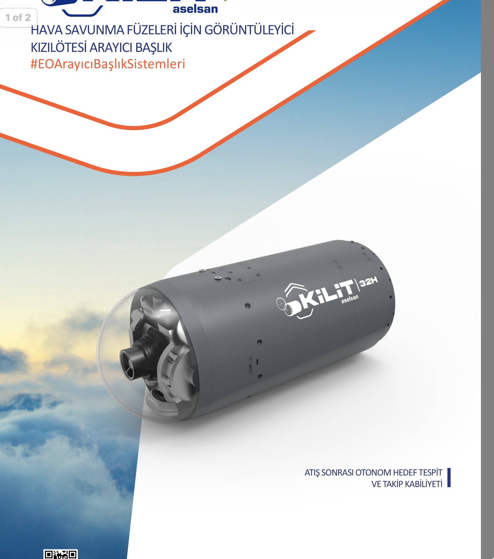

Coastal surveillance radars, MPAs, AWACS and UAVs will pass the exact coordinates of the target ship for the missile launch. A missile will be launched towards the given coordinates. There might or might not be midcourse updates. Based on the missile’s diameter(610mm, for comparison diameter of Amraam is 178mm), I believe an RF seeker head that fits inside this missile could detect and lock onto a frigate-sized object at a range of around 100 km at worst. It is a 100+ meter target and the missile is looking at it from angles of 70+ degrees. It will light up on the RF seeker like the full moon. The seeker can scan a big area(for example 10kmX10km square) extremely fast. No matter how fast a ship is, it can't get out of that box. Once seeker locked onto the target ship, it is an automatic process. The guidance computer will calculate PIP maybe 10 or 100 times per second. A missile flying close to Mach 5 will have approximately 60 seconds to scan, lock onto target, make the necessary course corrections and hit the target. As for the small boat in today’s test, the missile’s seeker likely detected and lock onto it at a range far shorter than 100km which would give the missile a very small time window but since the target was drifting the missile seeker was searching a very small area around the given target coordinate. Still it made very precise corrections to hit the small target bullseye. Extremely impressive. Without those corrections there is no way to hit a tiny target bullseye albeit it is a drifting target without its own propulsion.

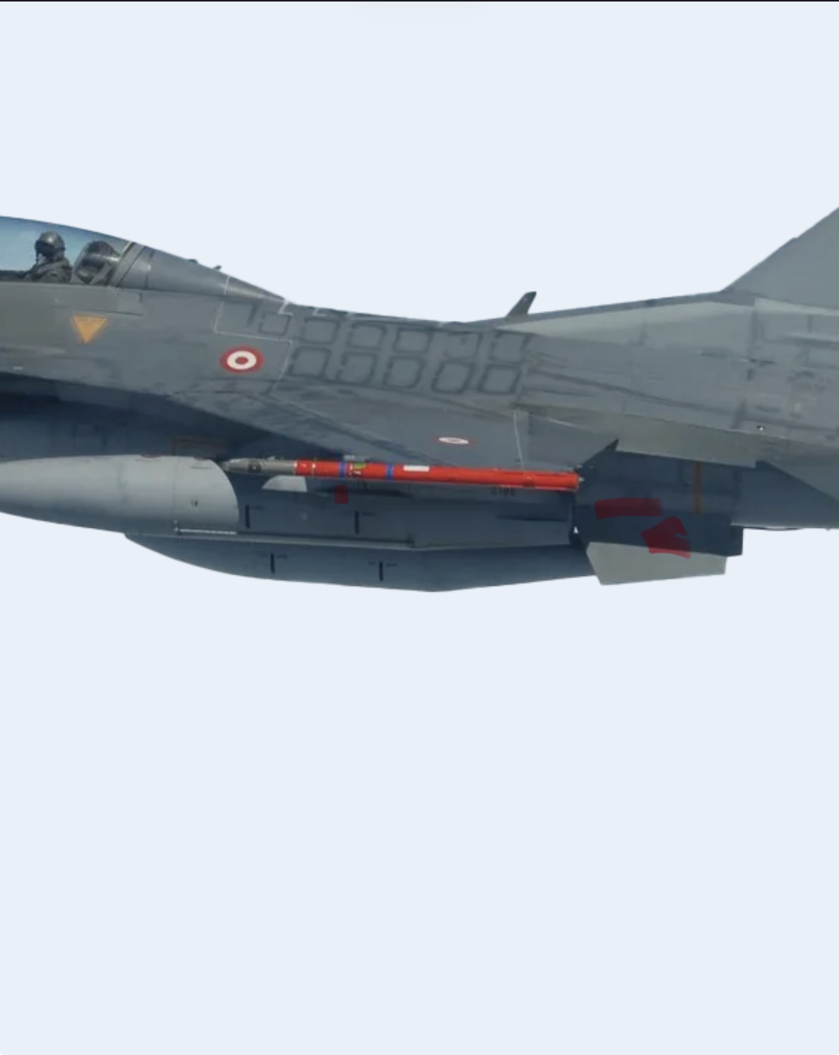

Ongoing and possible supersonic and hypersonic missile projects.
Air-to-Air
Gökhan/ER (liquid fuel Ramjet, Mach 3- 4.5)
Gökbora (solid fuel Ramjet, Mach 3- 4)
Gökdoğan/ER (solid fuel rocket, Mach 4)
Bozdoğan (solid fuel rocket, Mach 4)
Air to Ground
IHA-230 (solid fuel rocket, supersonic)
IHA-300 ER (solid fuel rocket, supersonic)
IHA-500+ (possible hypersonic aeroballistic missile similar to Israel's ROCKs)
Akbaba HARM (solid fuel ramjet, Mach 2.5-4, Air-to-air secondary capability)
Cruise Missiles
Supersonic Anti-Ship Cruise missile (liquid fuel ramjet, Mach 2.5-4)
Supersonic Cruise Missile (liquid fuel ramjet, Mach 2.5-4)
Air-launched supersonic cruise missile (liquid fuel ramjet, possible project)
Ballistic Missiles
Bora/Khan (solid fuel rocket, supersonic)
Tayfun Block 2 (solid fuel rocket, supersonic)
Tayfun Block 3 (solid fuel rocket, hypersonic)
Tayfun Block 4 (solid fuel rocket, hypersonic)
Cenk(solid fuel rocket, hypersonic)
Yıldırımhan (liquid fuel rocket, hypersonic/possible high hypersonic-mach 10+ capability )
Timur (solid fuel rocket, hypersonic/possible high hypersonic-mach 10+ capability )
Most of our high-speed missile projects target mid-supersonic to transitional/low/barely hypersonic speeds. There is a reason for that. At those speeds, you don't need to deal with a lot of headaches related to the hypersonic speed regime. Those weapons are not exotic weapons they are accurate, easier to produce cheap enough to be deployed in numbers but they are still a lot more effective compared to subsonic or low supersonic weapons. As the technology matures i expect hypersonic cruise missiles(scramjet), hypersonic gliding vehicles to appear in the next decade.
