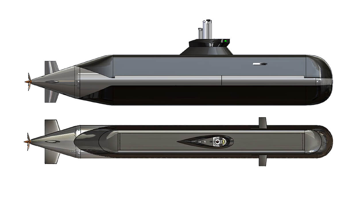

Apart from this, a small 33m submarine (STM500-42m) named LSUB-33, which is lighter than the STM500, was designed by the Dearsan shipyard. The LSUB33 has a speed of 10kts and a diving depth of 150m. This submarine can also be evaluated by the TN or export markets.
View attachment 45381 View attachment 45382 View attachment 45383
Dearsan's sub has already got an order, i guess :).
But to add further, Dearsan's sub is in easy category compared to the STM500. It may be completed earlier than STM500 both in design and construction. (Also depth and operational conditions are far relaxed)

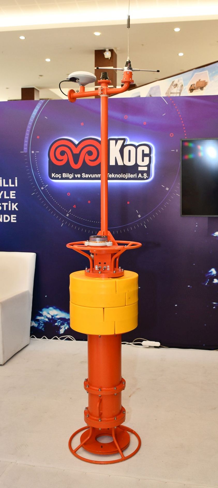

Knowing communications to be a challenge. Do we have anyone producing smart buoys. I’ve mentioned it a few times in the past. But a network of smart buoys that can function as relay points could be a coordinate system of sorts.
A bit like how the japanese use them in the movie battleship.
Something like this? it could be modified as relay buoys.
9,878
67 22,017
Yes. While I’m certain it would be good to have aselsan involved in this project I think having these buoys used for beneficial projects could be an excuse to implement them. And the military grade buoys could be used in networkcentric setup. Being our feelers in Mavi Vatan.

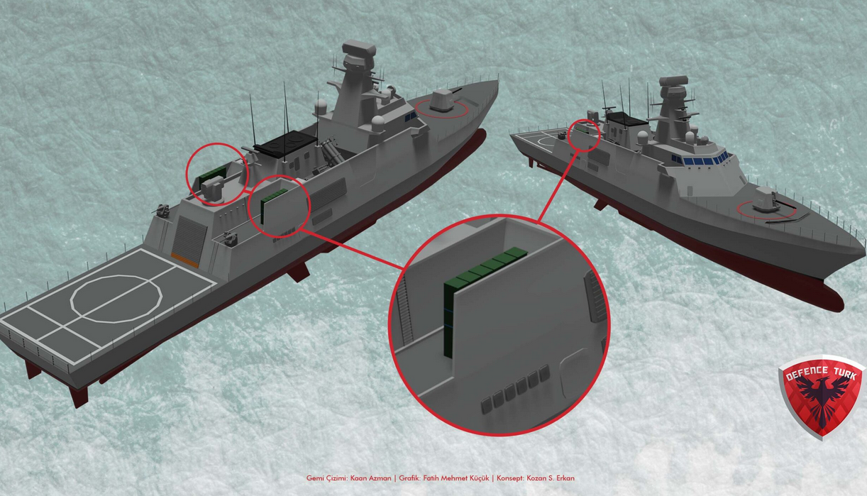

An idea burning in my head I like to throw here in the group
How far is it possible to use gokdogan missile (with booster) on ships. I mean there are already ideas to have a system like NASAMS with Gokdogan / Bozdogan missiles. Why not apply it on ships?
What advantages gokdogan missile (with booster) may have over HİSAR -RF or SİPER B1? a chance to load multiple missiles per a VLS cell? İmpressive enough we have multiple candidates and as you stated we may even come up with more options, İf I am not wrong SAGE already stated that there can be a land variant of Gokdoğan and G40/60 . From now on I belive for the naval platforms the main emphasize will be on dual or quad packing of missiles since limited number of VLS cells that we have are deadly precious.

What advantages gokdogan missile (with booster) may have over HİSAR -RF or SİPER B1? a chance to load multiple missiles per a VLS cell? İmpressive enough we have multiple candidates and as you stated we may even come up with more options, İf I am not wrong SAGE already stated that there can be a land variant of Gokdoğan . From now on I belive for the naval platforms the main emphasize will be on dual or quad packing of missiles since limited number of VLS cells that we have are deadly precious.
I was thinking about use of slanted launchers instead of ASM missile you can use Gökdogan with booster. So Milgem ships won't need big changes to use AD missiles, same for the upgraded Meko ships.
Both Milgem and Meko have 2x4 ASM launchers, easy to switch to 1x4 for ASM and 1x4 for Gökdogan. We cannot integrate any other missile to the Meko VLS launchers (those will keep the ESSM)
2,970
62 5,305
Except Sea Ceptor ( min range 1 km), vertically launched SAMs have very limited minumum range so they are less efficient against cruise missiles. I would prefer solid point defence on frigates.
4,299
274 22,477
Idea is sound. But what advantage will it bring?
Will it not effectively cut the number of available Anti Ship Missiles by half?
ESSMs are proven and effective missiles. But they are single stage solid fuelled 4mach missiles that have limited range and altitude that lose their speed and kinetic energy towards the terminal stage of their journey.
Theoretically and technologically the Hisar range with dual pulse engines are superior as air defence missiles. Presumably that is why TSK has chosen this technology and to have a better kill capability. Dual pulse engined Hisar missile, burn first portion of their fuel and reach 3+Mach speed after launch. Then it starts to lose momentum. After acquiring the target, it starts to burn the second portion of fuel to reach 4mach speed, and for the terminal stage to give no escape chance to the target.
I , however, agree with you in the use of Bozdogan based surface launched anti air missiles for our indigenous RAM alternatives like Levent or Gokdeniz ER

Advantage it will bring is (assuming it is possible) Medium range AD missile with Medium altitude without huge cost of integration. ESSM is a good missile but for low altitude.
Second point is the MK41VLS, as you know it is difficult if not impossible to have other missiles integrated on the Barbaros class. Using space for ASM missiles is a solution, not ideal but do ships always need 8x ASM? Evenly needed is a good protection in AD.
Hisar missile is good provided it can be shot from the ASM launchers.
Anyway my purpose is not to promote the idea for Gokdogan missile in particular but the use of ASM launchers in alternative way to install at least 4 medium range, medium altitude AD missiles mission specific on Milgem corvettes and Barbaros light frigates. Missile can be Gokdogan or Siper as long as the ASM launcher space can be used.

This should be done not just to allow Ada-Class and frigates to carry AD missiles but also the fast attack crafts and patrol boats via common oblique AShM launchers. That would be nice if a FAC (let's say TTHB or whatever it becomes) equipped with 8 AShM and 2+2 quad packed Gökdoğan with booster (tagged as G40/60 by SAGE). That common launcher interface should be benefitted more but it first requires some ability on quad-packing and it is Roketsan's responsilbiity now as part of the MDAS contract.
2 year ago @UkroTurk came with a similar idea (Defence Turk was later than our forum :) );
Whatever they are going to mount on Ada-Class or others better be compact as this launching system with minimal deck penetration and modification.
Then i improved the idea a bit with proper VL systems;
